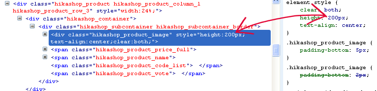

I can't seem to find where the product listing module is getting it's height. I somehow remember being able to edit it before the modules were editable via Joomla's interface but I could be wrong.
For example, I am using the product listing module and it has a style height on the hikashop_product_image I can't seem to find where that was set. I want to remove the height as it looks odd on mobile devices.
By the way there is no height set when I view the module in the backend but I see it via Firebug.
Thanks!

10 years 7 months ago #225665
I removed the height consistency but that is not my only issue. There is a height set on the hikashop_product_image as I indicated above that I can't seem to find where that is set. Please see the attached.

10 years 7 months ago #225674
This come from the setting "Thumbnail height" in Configuration > Main > Images.
That can be overrided via a css property with "!important", something like:
.hikashop_subcontainer .hikashop_product_image{ height: 100% !important; }
Else you can remove this inline css by editing the view "product / listing_img_title" directly.
