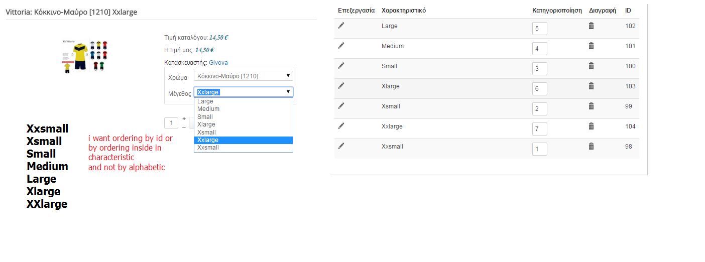

I want to change the ordering in the characteristic because i dont want to be by alphabetical i want it by id or by ordering sorry for my bad english,,,, plz check the photo

You can change the "characteristics values ordering" setting of the HikaShop configuration for that.

I'm not sure what more I can say. The option is in the HikaShop configuration and you can change it to change the way the ordering is done: take.ms/QJT7Y

i tried with many options but the problem still exist!

I've tried on my end but it's working fine with HikaShop 2.6.0.
Did you save the characteristic after setting the ordering of the values ?
Did you set the "characteristics values ordering" setting to "ordering" and then saved the HikaShop configuration ?
