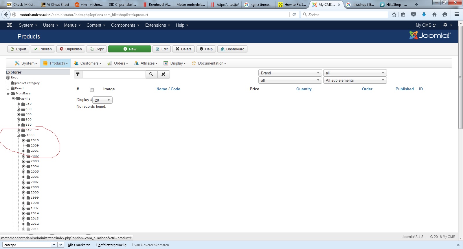

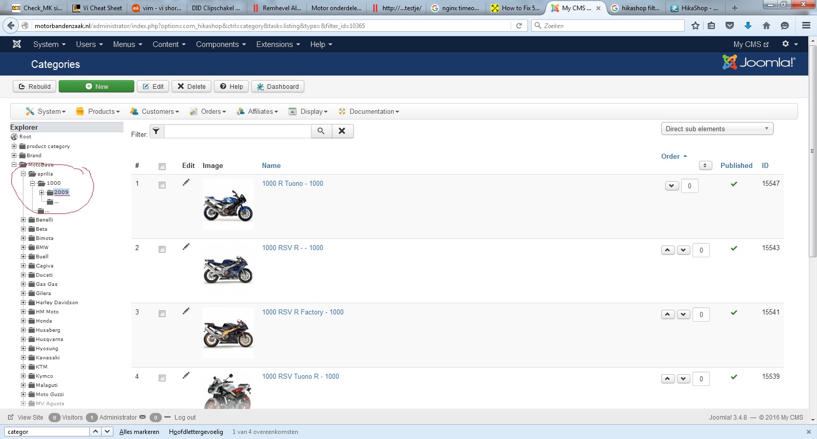

I also noticed issues in the backend.
See attachements
In CategoryView you can see there is are categories for Aprilia - 1000 - 2009
In ProductView you can see the result after clicking the '+' for the 2009 category... no sub-categories displayed.
This issue does not arise for all categories thow :S
