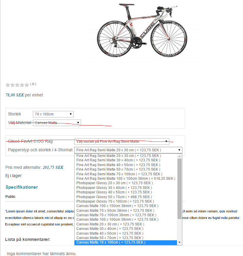

  • Posts: 20
10 years 6 months ago #227877
Sorry for my bad English and i am not good at explaining stuff either, but i will try again ( move this to right forum if in wrong one now ) :)
What i try to do i setup a market where my vendors for exempel will sell there photos as canvas paintings and i make the printing.
So i try to make a template or product they can use as a template and my problems is as follows.
Depending on the size the customer choose of the print prize on the vendor should be able to get paid according to that size ( so the vendor should be able to set different prizes to different sizes and we can do that with Characteristics so far no problem.
My problem comes when i need to get the customer to choose paper typ and frame size again so i can get paid what it costs to do the printing and framing.
So if a customer wants a picture printed in size 30x30 they choose first image size ( so vendor get paid ) and then the rest of the sizes should not be selectable when they have to choose papertype and framing and so on... thats my problem
hope this makes sense to you, english is not my native :D
Last edit: 10 years 6 months ago by dennisg.
10 years 6 months ago #227891
So once the image size is selected, they must not be able to edit it, right ?
It is not possible by default in HikaShop, this will require custom code.
I think that this will require Javascript code to set the dropdown as not editable once the size has been selected.
