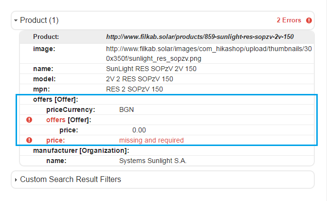

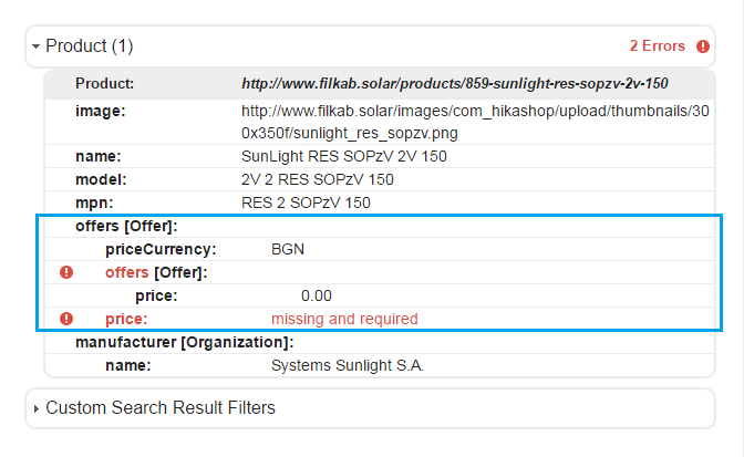

10 years 6 months ago #233835 by ydingilski
Dear Xavier,
The code provided in your previous post generates another mistake - the first exclamation mark on the attached screenshot.
If I only leave the rows:
Code:
<span itemprop="price" style="display: none;"> 0.00 </span>
then there is no mistake and the price is set to zero.
Your solution fixes the error but the price is still not correct.
I was hoping that there is a way to "dismiss" the whole offers [Offer] part when I have no price set (the blue rectangular on the attached screenshot.

10 years 6 months ago #233896 by Xavier
So to remove the whole offers part you can remove the HTML code:
[code]
<span id="hikashop_product_price_main" class="hikashop_product_price_main" >
</span>
[code]
In the view "product / show_default" when there is no price.
That way the plugin will not add any microdata for the price.
