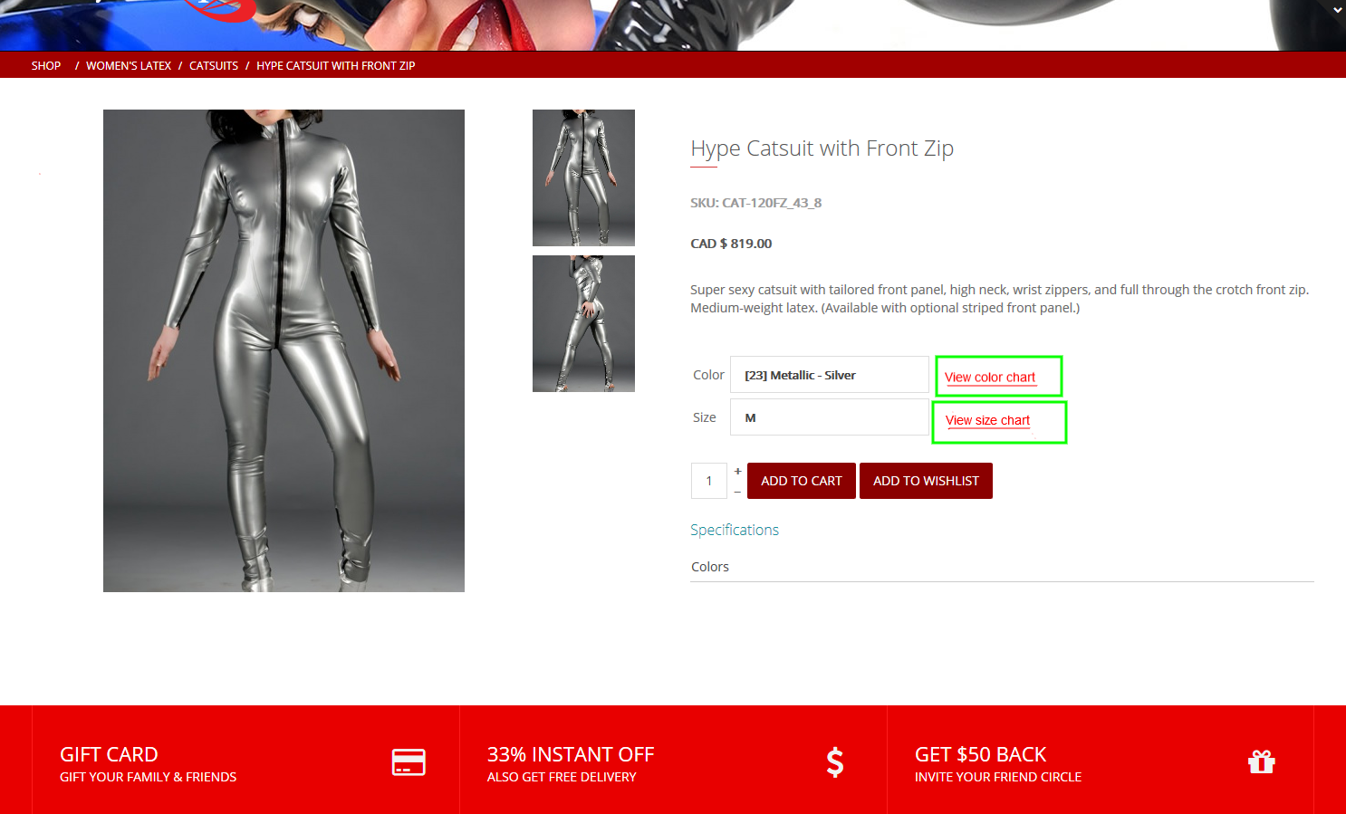

Ok,so I have many different variants.ie:Colors, sizes,patterns, etc...
What I attempting to do is add a link right after the variant selectbox. And that link is in the module and when clicked opens custom modal. So , in other words the link and modal is all contained in the module I'm trying to load conditionally.
So I need to editing/customize the products/show_block_characteristics
All I want to do is get the variants field label value (ie.: Colors.Sizes,etc) and using a switch statement load the corresponding module after the selectbox .
I included a screenshot, as it will will be obvious to see what I'm trying to do.

  • Posts: 26382
10 years 7 months ago #226543
The view "show_block_characteristics" is the right view but you're using the dropdown display so it uses the type "characteristic" for the display and more specially his "displayFE" function.
administrator/components/com_hikashop/types/characteristic.php
So, I think that the best for you would be to copy the content of the function and place it into the view.
Thanks to that, you will be able to modify the return content using a view override (and not by modifying a core file).

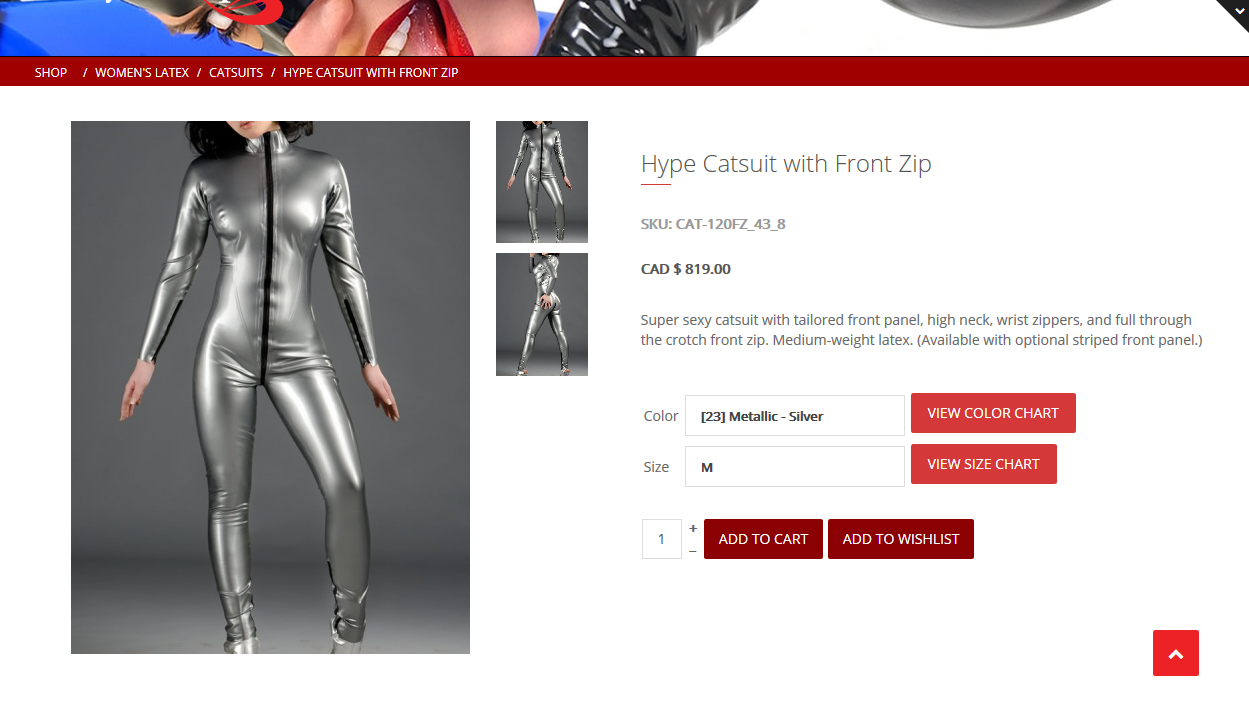

  • Posts: 56
10 years 7 months ago #226559
Thanks Jerome !!
Got it, did it , done !!
The buttons I'm using might get edited, but it works !
(c.f: attachment)
