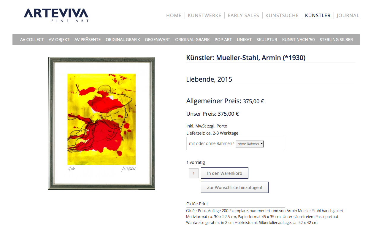

10 years 6 months ago #229452
Hi Mohamed,
Thanks, I got the Variants going but noticed my main problem is the Variant does not switch. On the following Link:
s553057611.online.de/av-2016/kuenstler/p...t/136-liebende,-2015
I have with or without frame option on the Variants but it doesnt switch the price. On changing to Protostar it changes. Its a Super Helix Template and I allready had similar problems with the Payment redirecting ( Sofort Payment Method Thread ).
You managed to fix that, how did it go again?
Thanks in advance.
Wolfram

10 years 6 months ago #229459
The problem is with the customization of the product page in the template.
The best would be to contact the template provider so that they can fix their customization of the product page.
Otherwise, you can also rename the folder templates/YOUR_TEMPLATE/html/com_hikashop/product via FTP.
That will deactivate all the customizations of the template for the products listings and product pages and it should fix the problem.

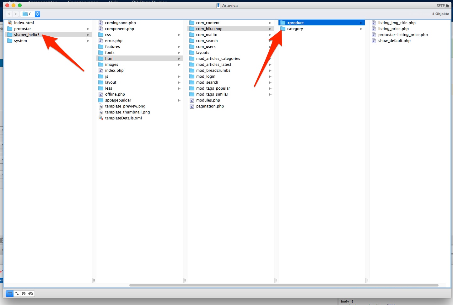

  • Posts: 5
10 years 6 months ago #229561
Well Helix told me they dont deal with 3rd party Plugins. Sorry I didnt get by reanaming my template by ftp will help?

  • Posts: 5
10 years 6 months ago #229642
Well i tried that as well, I feel I am getting closer but renaming didnt change the result.
Any other ideas?
  • Posts: 86058
  • Thank you received: 14184
10 years 6 months ago #229755
The problem is indeed with the template but not in the view overrides.
The problem is that the javascript of the template is broken:
take.ms/RaZNE
Because of that, the hikashopUpdateVariant function of HikaShop is not initialized and because of that, the switch is not happening when you change the dropdown.
From what I can see, the error comes from the javascript code of the template:
take.ms/jTX40
There is a "iif" instead of "if".
You'll have to ask your template provider on how to fix that.
