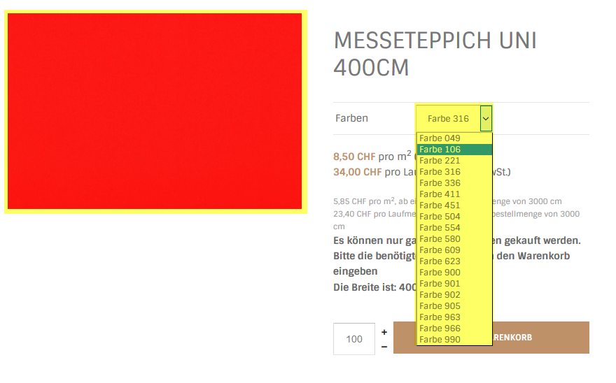

Hello
We would like to change the image when you go over the different color by mouse. So not only when clicking on the different color - also by mouse Over
Maybe you have any tipp for me, I guess i have to include some code in the shoe_block_characteristics.php
but at the Moment I don't see how...
For any Tipp I'm very thankful
Maya
