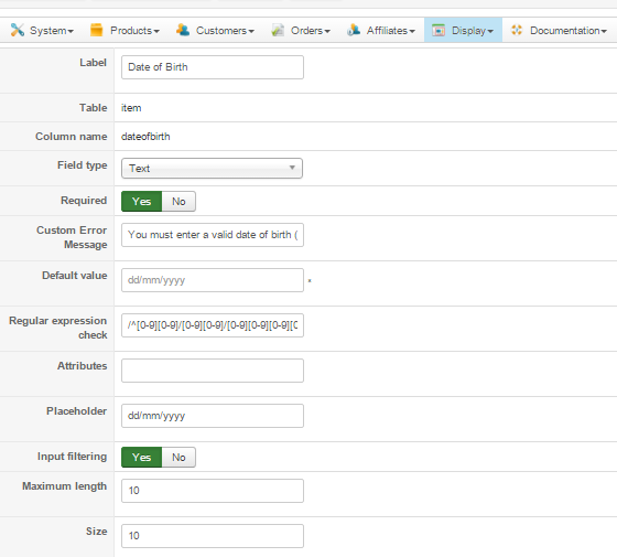

I've created a custom text field for a date (format: dd/mm/yyyy) and trying to write
a regexp to catch those that don't match. Not sure how it should be formatted
within the custom field screen. The field is required, so regexp should be checked.

It depends what you want to check exactly. For example, you could write:
/^[0-9][0-9]/[0-9][0-9]/[0-9][0-9][0-9][0-9]$/

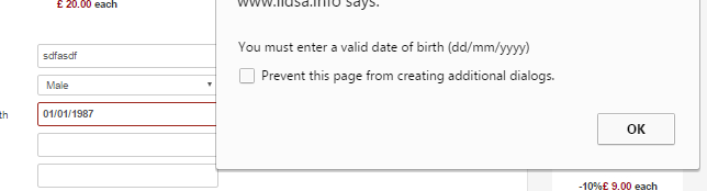

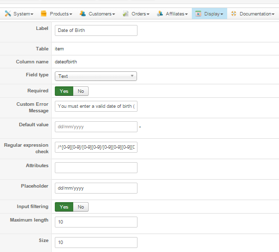

I tried that, but it doesn't recognize the string as valid. I see that its expecting
dd/dd/dddd (d=digit/number). Images shows the error appear when a valid string
is entered and the backend setup of the field (with the regexp).
I'm confused!

Got it fixed.
Drop the / .... /
as part of the expression.
