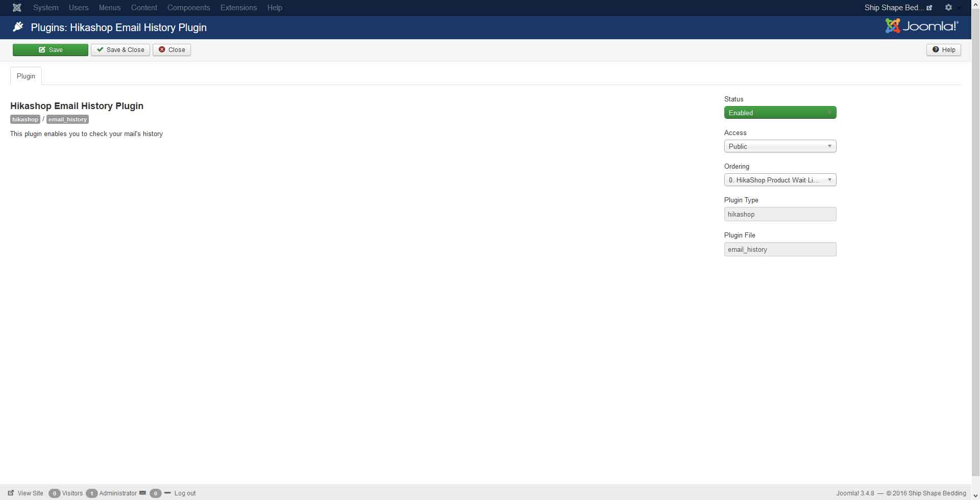

There are no options on the email history plugin? Please see attached

10 years 6 months ago #230484
1. Then maybe that's because you didn't turn on the backend display settings of the custom field ?
2. There is: take.ms/e1uS9
That's taken from our demo website.
So that means that you're not using the latest version of HikaShop unlike what you wrote in your first message as this option is only available with the 2.6.1. So update HikaShop and that should help.
Last edit: 10 years 6 months ago by nicolas.
