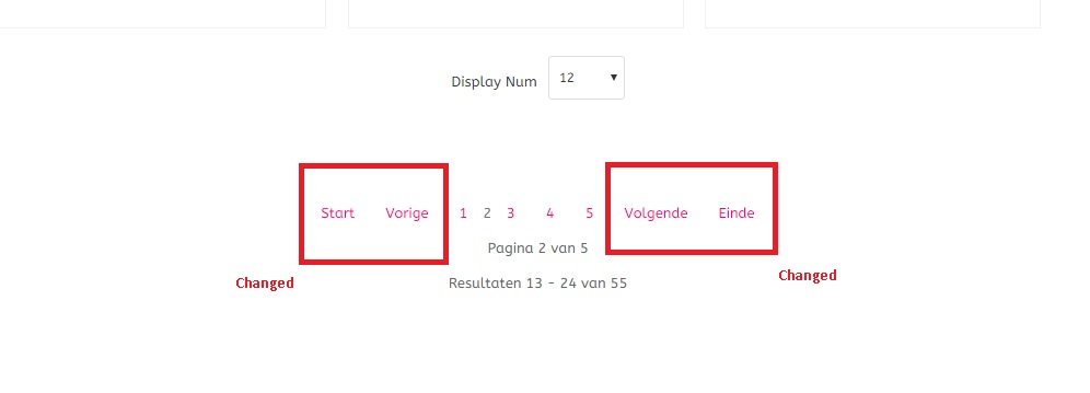

im having some problems with the navigation at the bottom of the product page!
For example: i can select page 2, but after that i cant select another page!
And the navigation appearance is changed, This all after the update to 2.6.1
How to fix this?

Can you try to turn off the "Redirect POST mode" setting of the HikaShop configuration ?

Thanks that did the job!
Do you have any idea why the button style is changed?

Recent versions of HikaShop support pagination overrides from the Joomla template, while before, you were seeing the default pagination of HikaShop that is used when the template doesn't have a pagination override I guess.
It comes from the file templates/YOUR_TEMPLATE/html/pagination.php
