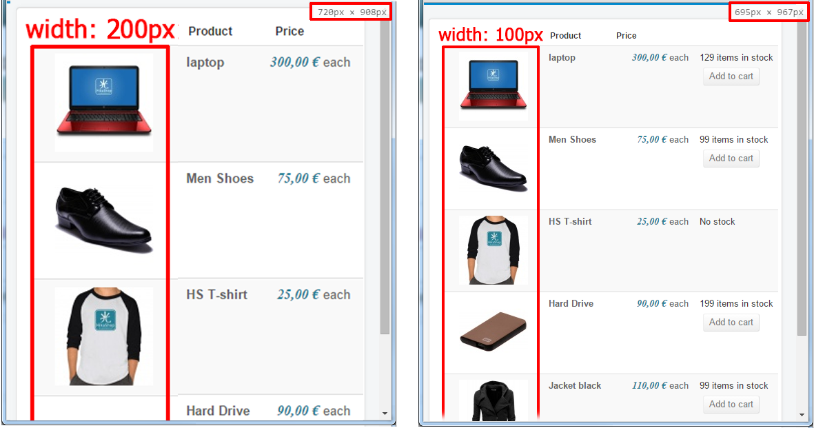

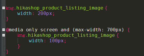

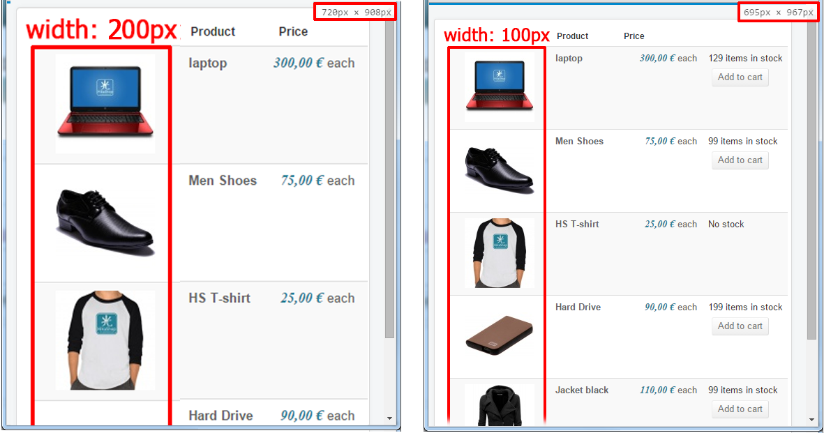

10 years 5 months ago #230966
As example of @media code
Here, vou have an image that will be displayed with a 200 pixel siez (widht) for ALL media size, except under a 700 pixel width media.
And so, thanks to @media the image will be displayed with 100 pixel width.
Last edit: 10 years 5 months ago by Philip.
