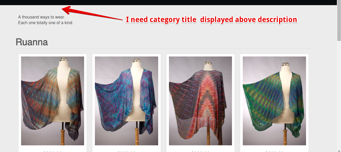

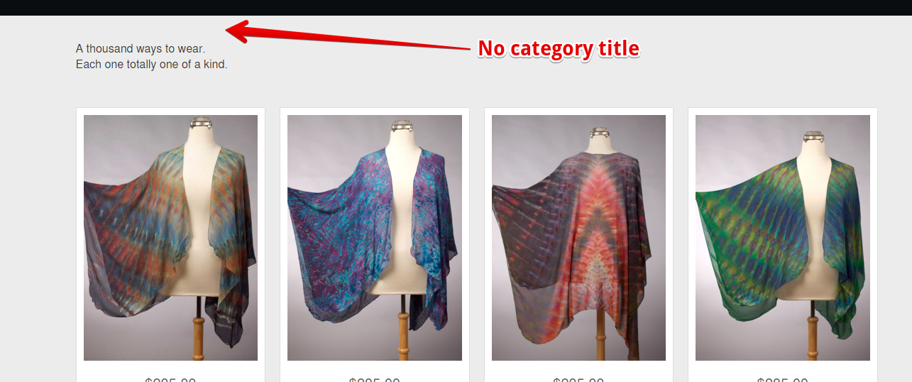

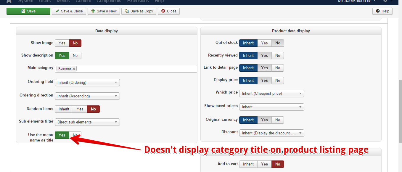

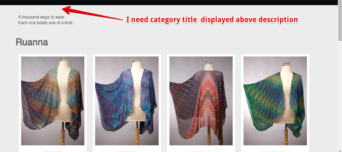

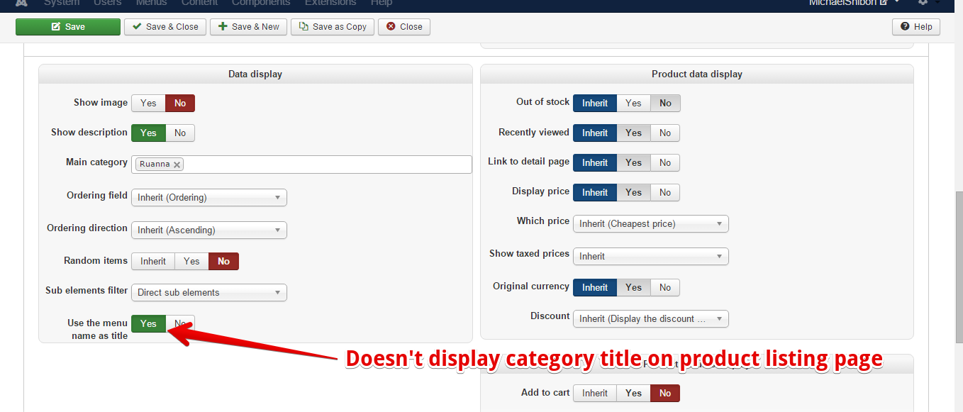

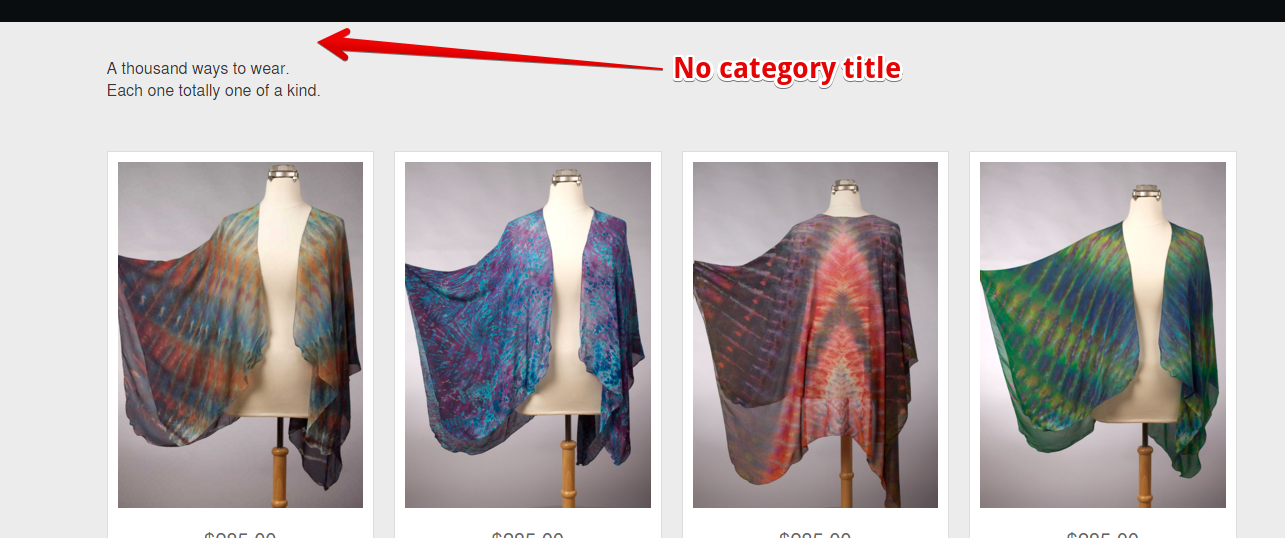

the category name doesn't display when this option is set to "Yes"(please see attached screenshots). Are there any other settings that override this setting in Hikashop?
thanks!
10 years 5 months ago #230992

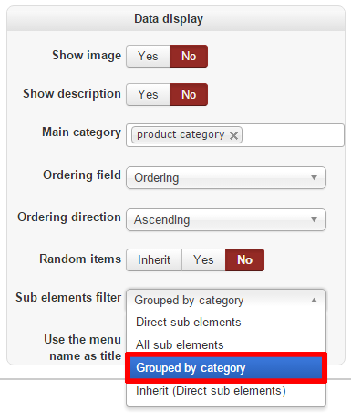

the option "Use the menu name as title" don't have to use category title but your item menu title

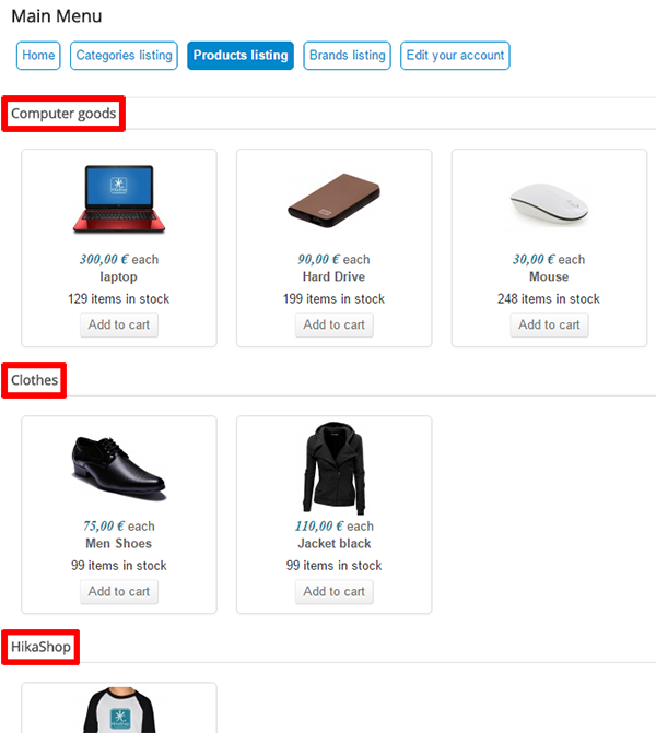

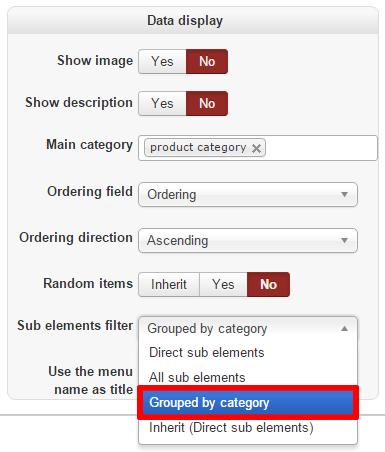

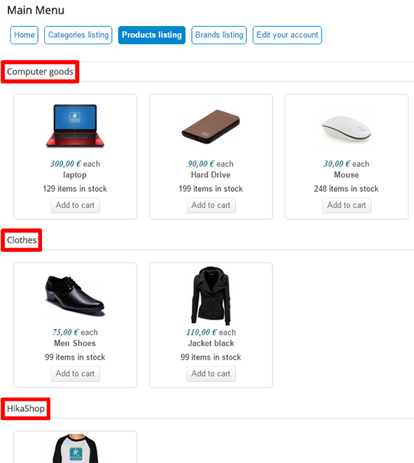

But, maybe you can select an other option, in Data display part, find Sub elements filter, and in the dropdown select "Grouped by category"
As result :
You have now your different category name displayed

thank you. This is OK, but I want to display the category titles above the description. It worked before.
I can do that by modifying the code, but I do not want to do that.
thanks!

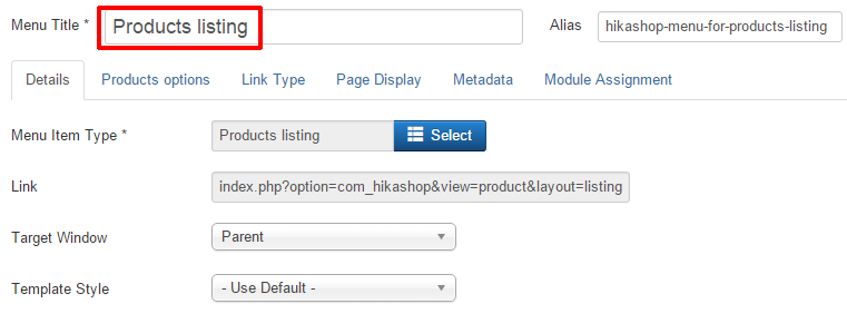

10 years 5 months ago #231122

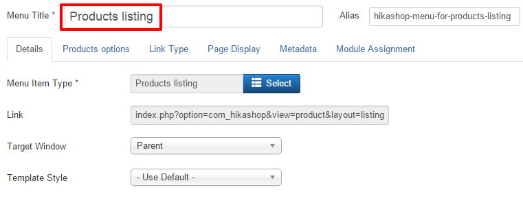

If you have only one category displayed, why don't you give to your item menu the same name than your category?
And after as you do earlier click on "Yes" for "use the menu name as title" option.
Hope this will fit your needs.
