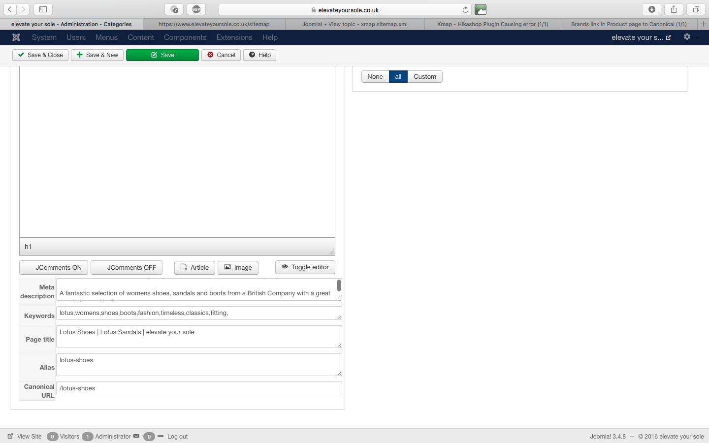

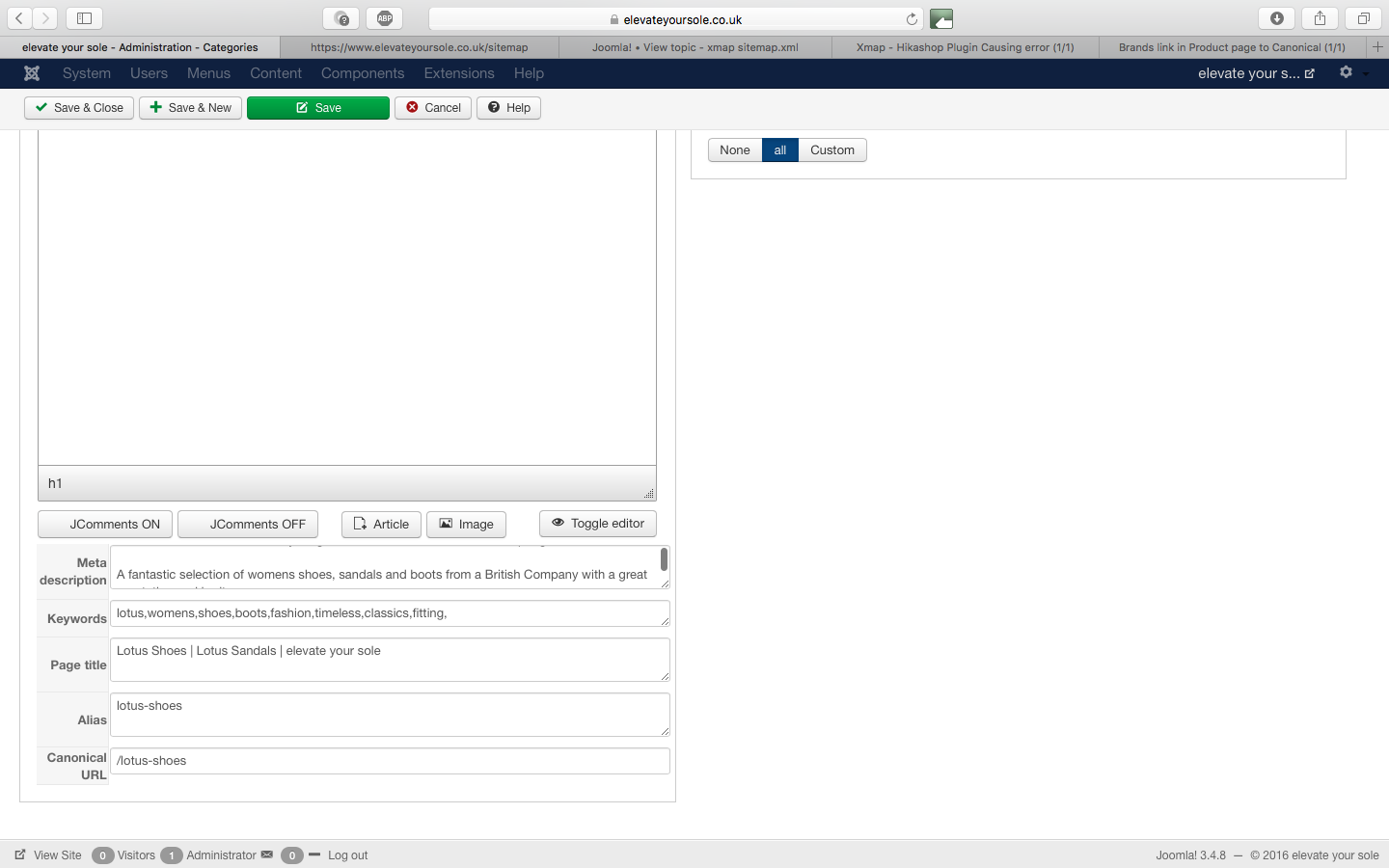

  • Posts: 265
10 years 5 months ago #232231
All canonical URL's are set up like the screenshot. Is this correct?
Many thanks,
Hal
  • Posts: 86058
  • Thank you received: 14184
10 years 5 months ago #232234
Yes.
