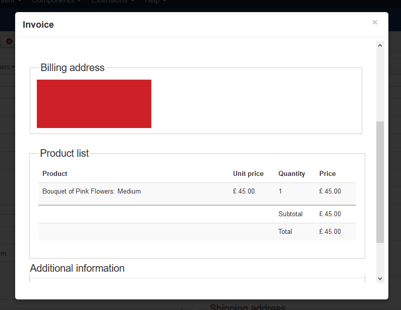

When I go to my order section in the back end I click on the invoice tab at the top is does not show the shipping address so I clicked on the shipping invoice and that is just what they have ordered.
What I would I would like to show up on the invoice is the billing address and the shipping address if it is different can anyone please help me with this problem.

It should display both unless there is no shipping method in the order.

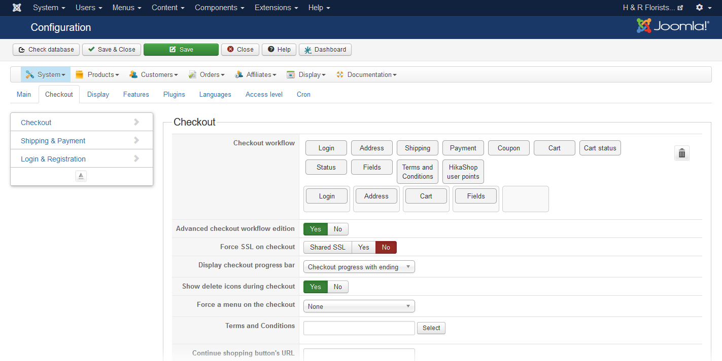

Can you make sure that you didn't remove the "shipping" view from the "checkout workflow" setting of the HikaShop configuration ?

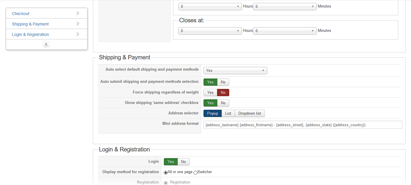

It is set to free shiping i thinkbelow are some screen shots of what my setting look like.
I would like the shipping address at the side of the billing address if it is diffrent then the billing address.
Thanks John
10 years 5 months ago #232152
Hello John,
For the moment you don't have any Payment and Shipping step on your checkout workflow via "Hikashop->System->Configuration->Checkout", so your customers can't logically have a shipping address if there is nothing to ship.
Do you want to build your shop without any payment and shipping ?
