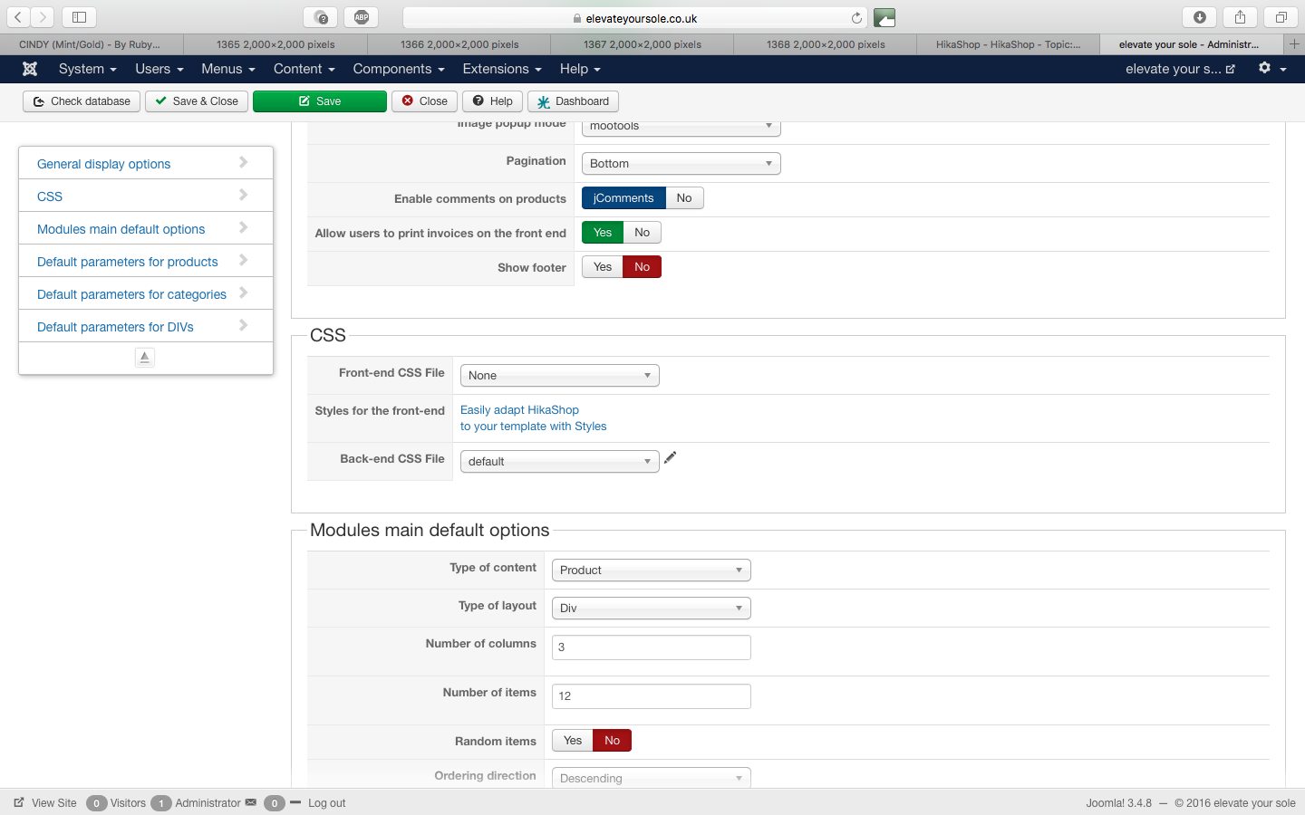

  • Posts: 265
10 years 5 months ago #232040
Yes it's saved with none, please see screenshot.
  • Posts: 86058
  • Thank you received: 14184
10 years 5 months ago #232046
No, I'm talking about the setting below the "frontend CSS file".
The problem is that you removed all the style files and thus you don't see the dropdown with the styles selection and thus can't select none in it.
Change the line:
return '<a target="_blank" href="'.HIKASHOP_REDIRECT.'hikashop-styles'.'">'.hikashop_tooltip(JText::_('STYLE_TOOLTIP_TEXT'), JText::_('STYLE_TOOLTIP_TITLE'), '', JText::_('STYLE_HIKASHOP')).'</a>';
to:
return '<input type="hidden" value="" name="'.$map.'"/><a target="_blank" href="'.HIKASHOP_REDIRECT.'hikashop-styles'.'">'.hikashop_tooltip(JText::_('STYLE_TOOLTIP_TEXT'), JText::_('STYLE_TOOLTIP_TITLE'), '', JText::_('STYLE_HIKASHOP')).'</a>';
in the file administrator/components/com_hikashop/types/css.php and then save the configuration of HikaShop. That should solve the problem automatically.
