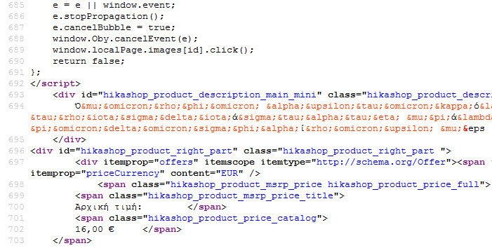

Hi, I created a small e-shop in greek using joomla and hikashop but I have this problem with greek characters in product description.
The greek description goes like this:
Όμορφο αυτοκόλλητο με τρισδιάστατη μπάλα ποδοσφαίρου με εφέ φωτιάς, κατάλληλο για όλες τις επιφάνειες (τοίχος, ξύλο, μελαμίνη, πλαστικό, γυαλί).
When I go to the page source the description text shows up like in the screenshot attached:
Any ideas how I can fix this?
Thank you in advance,
Daniela
Last edit: 10 years 5 months ago by danielle71.
  • Posts: 86058
  • Thank you received: 14184
10 years 5 months ago #232254
So why is that a problem ?
HikaShop just displays the description without changing it.
It's either Joomla or your HTML editor which changes it.
Try to switch the "editor" setting of the HikaShop configuration to "none" and edit your product. Check that the description is correct, if not set it with the greek letters and then try again.
If it works, the problem is with the HTML editor you're using.
If that doesn't help, try changing the line:
echo JHTML::_('content.prepare',preg_replace('#<hr *id="system-readmore" */>#i','',$this->element->product_description));
to:
echo $this->element->product_description;
in the file "show_default" via the menu Display>Views. That way, it won't go through Joomla to display the description be directly output the data from the database.
