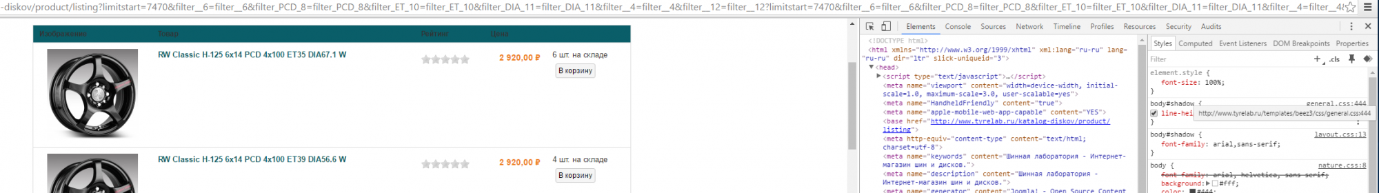

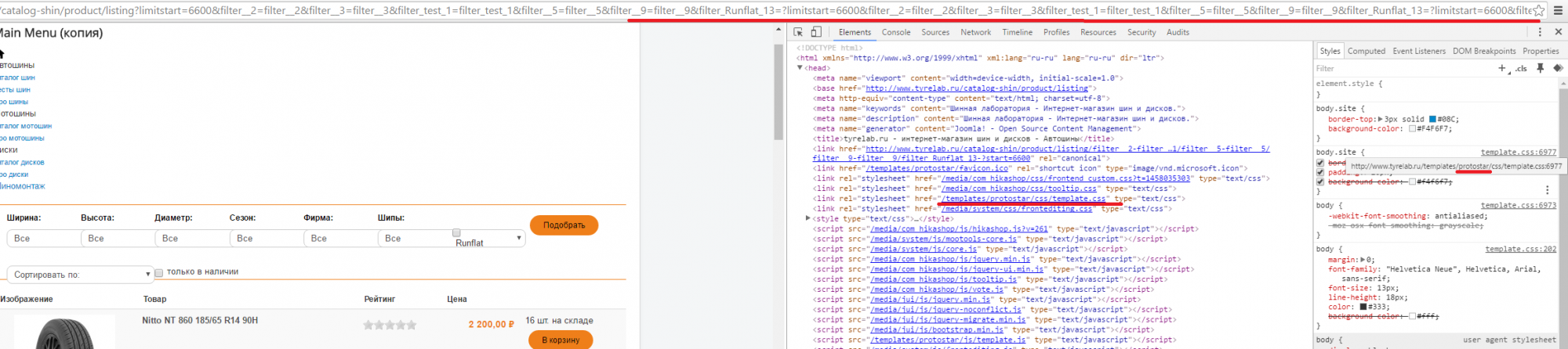

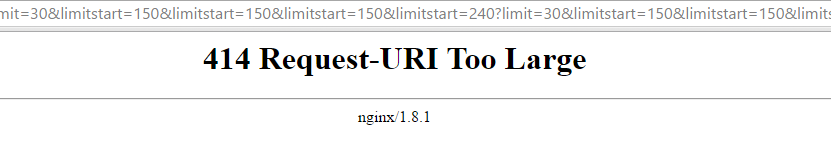

Good day!
Include in joomla URL Rewriting (.htaccess took native joomla, not changed anything) and then the problems begin. The site works, index.php removed, but if for example to view a product category and go through the pages, the link is growing all the time, and as a result, the web server writes that the uri is too large. A similar situation occurs if filters are used. Website on virtual hosting.
Tell me what maybe the problem?
