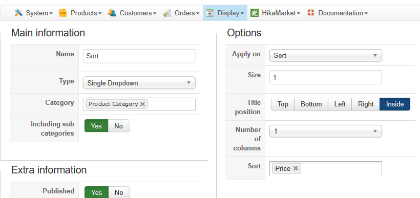

We took a different approach which allowed the user to select the sort order. We created a filter based on price:
You could also add 'Product name' if want to sort by name as well.
We then added a module (mod_hikashop_filter) to place a button at the top of the product list for the user to select the sort order:
Works great.
regards
Trevor
The following user(s) said Thank You: nicolas, hielkio
