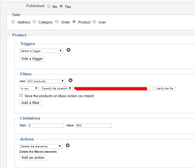

This products exist in database, I have an csv document and it looks like: 31173;72138;51717, my setup is:

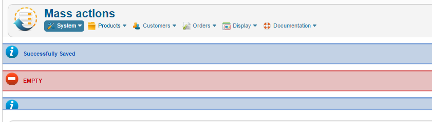

After click on "Process" it looks so:
Nothing is deleted, what I do wrong here? Is my CSV structure noc correct?

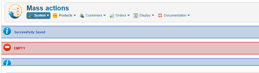

I get now only this error message: The line '' could not be imported Product not found

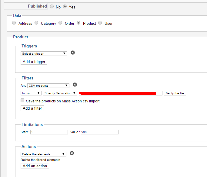

Please see the first screenshot of my post, is there everything correct for my product remove action?

10 years 4 months ago #236211
Yes on the first screenshot, the mass action seems to be correctly set up.
