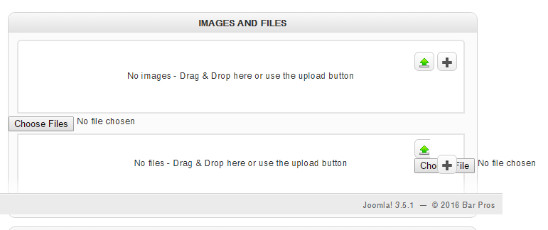

I am having an issue uploading an image to the Variant.
Please see below screenshots for your reference. Thanks!
www.awesomescreenshot.com/image/1149115/...89120318a93dbd7064ec
Any help would be appreciated. Thanks
Gary

10 years 4 months ago #235811
That's probably a bug with the popup system of Joomla.
Change the "popup mode" setting of the HikaShop configuration to "Vex" and that should hopefully help.
If not, please check the javascript console of your browser on that page for any javascript error. That would allow us to better understand the problem.

10 years 4 months ago #236106
Still not working, here's the error.
VM2591:266 Uncaught SyntaxError: Unexpected token }
Oby.updateElem @ hikashop.js?v=262:243
xhr.onreadystatechange @ hikashop.js?v=262:184

10 years 4 months ago #236132
We're not able to reproduce the problem on our end.
Could you provide a backend access to your website and a link to this thread via ou contact form so that we could have a closer look at the issue ?

10 years 4 months ago #236352
From what I can see, the problem comes from the CKEditor on your website.
Change the "editor" setting of the HikaShop configuration to use another editor and it should work.
Also, try to change the code:
$custom = preg_replace('#<script .*type="text/javascript" src=".*"></script>#iU', '', $custom);
to:
$custom = preg_replace('#<script .*(type="text/javascript")? src=".*"></script>#iU', '', $custom);
in the file administrator/components/com_hikashop/views/product/tmpl/variant.php and that should work even with CKEditor.

10 years 4 months ago #236472
I changed the script code on variant.php to the one you sent but still not working.
Here's what I did, I changed the Editor on Hikashop, it seems that the ArkEditor conflicting the Variant script.
Thanks, works fine now.
