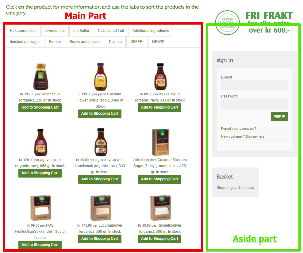

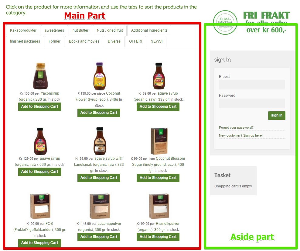

You speak about HikaShop content module, but I don't see any product image which full a module (understand on a aside part) on your website, on the other hand I see lots of product image in your main part.
Can you be more specific and give us a link where appearing the issue.
