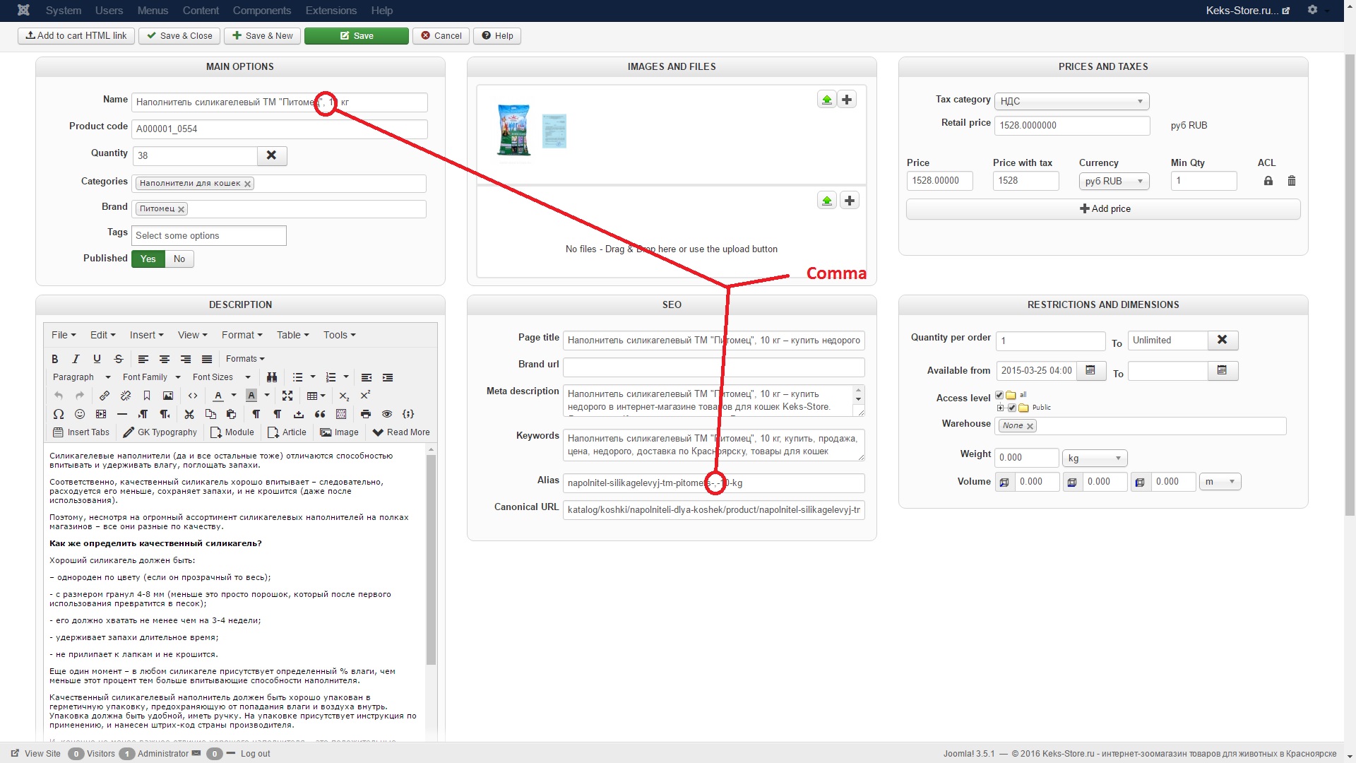

-- Joomla version -- : 3.5.1

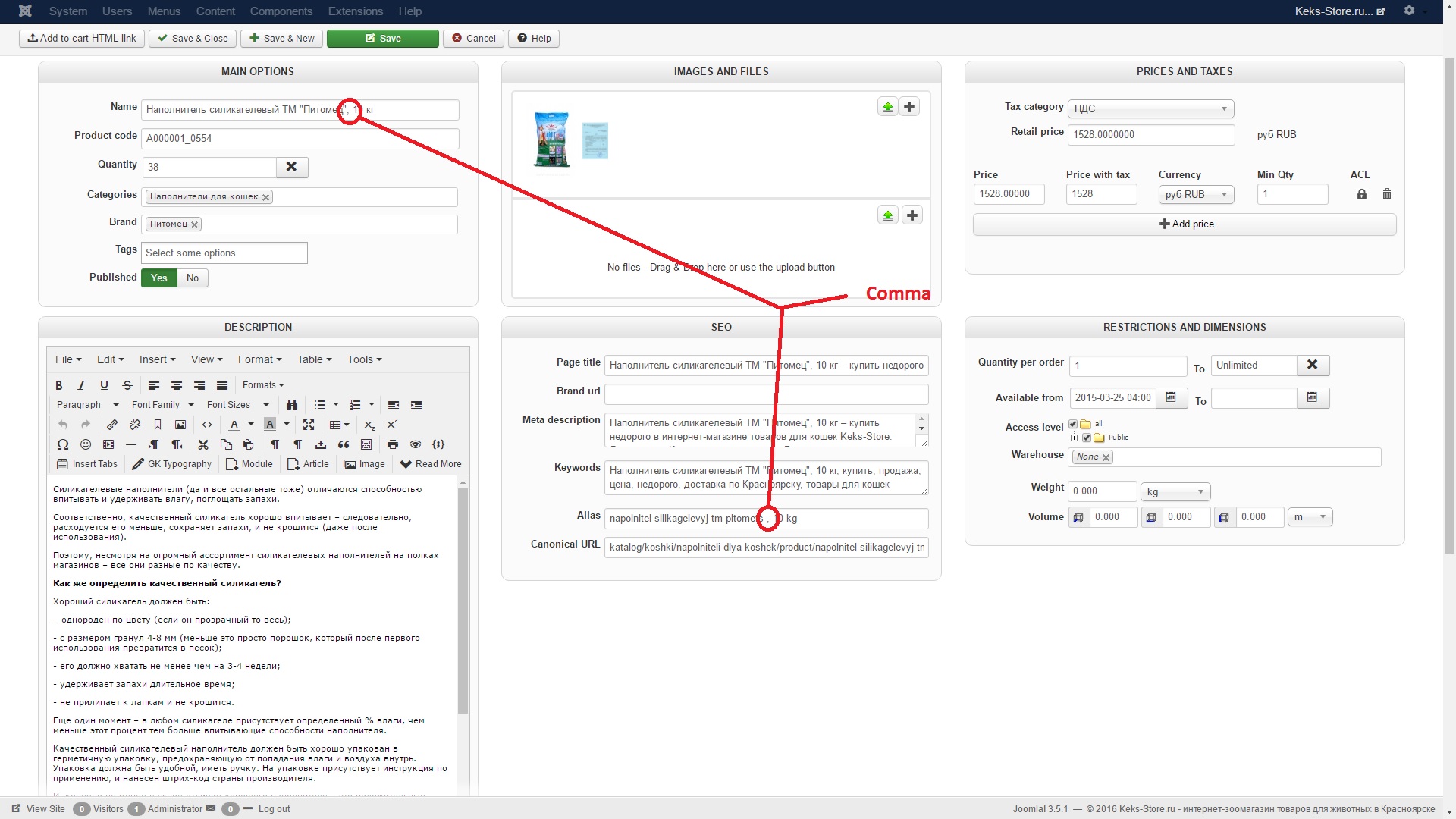

When the automatic generation of an alias if there is a comma in the product name, alias also appears to mark the decimal point. Naturally, the comma in the aliases do not need. How to fix it?

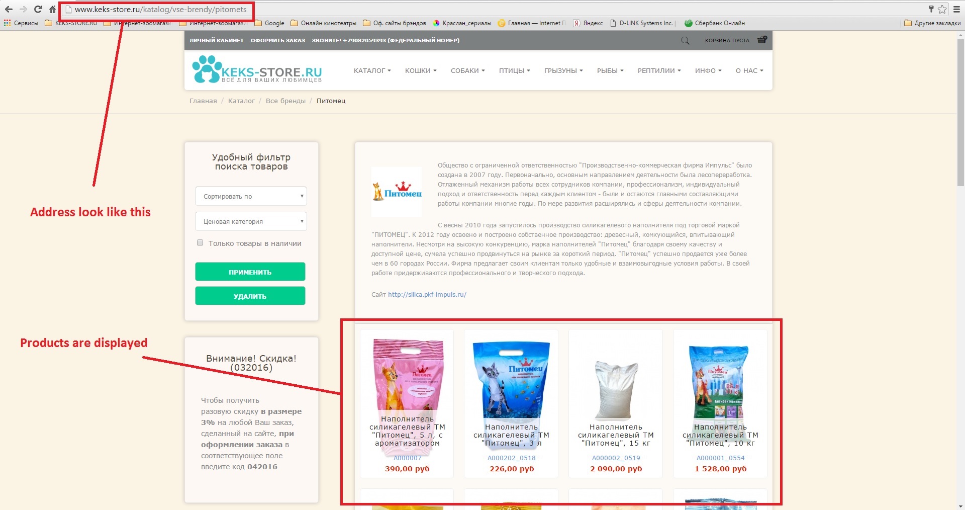

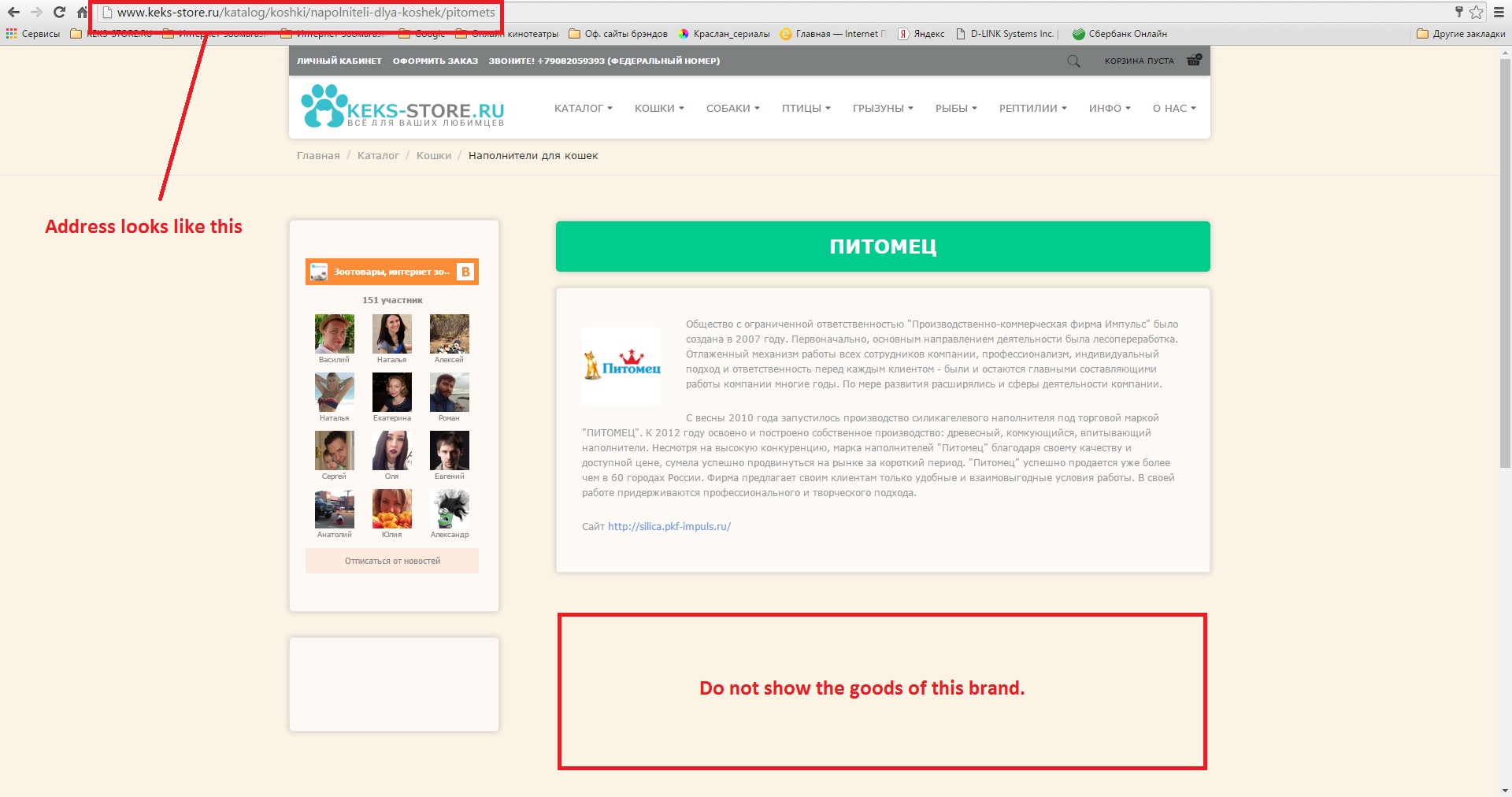

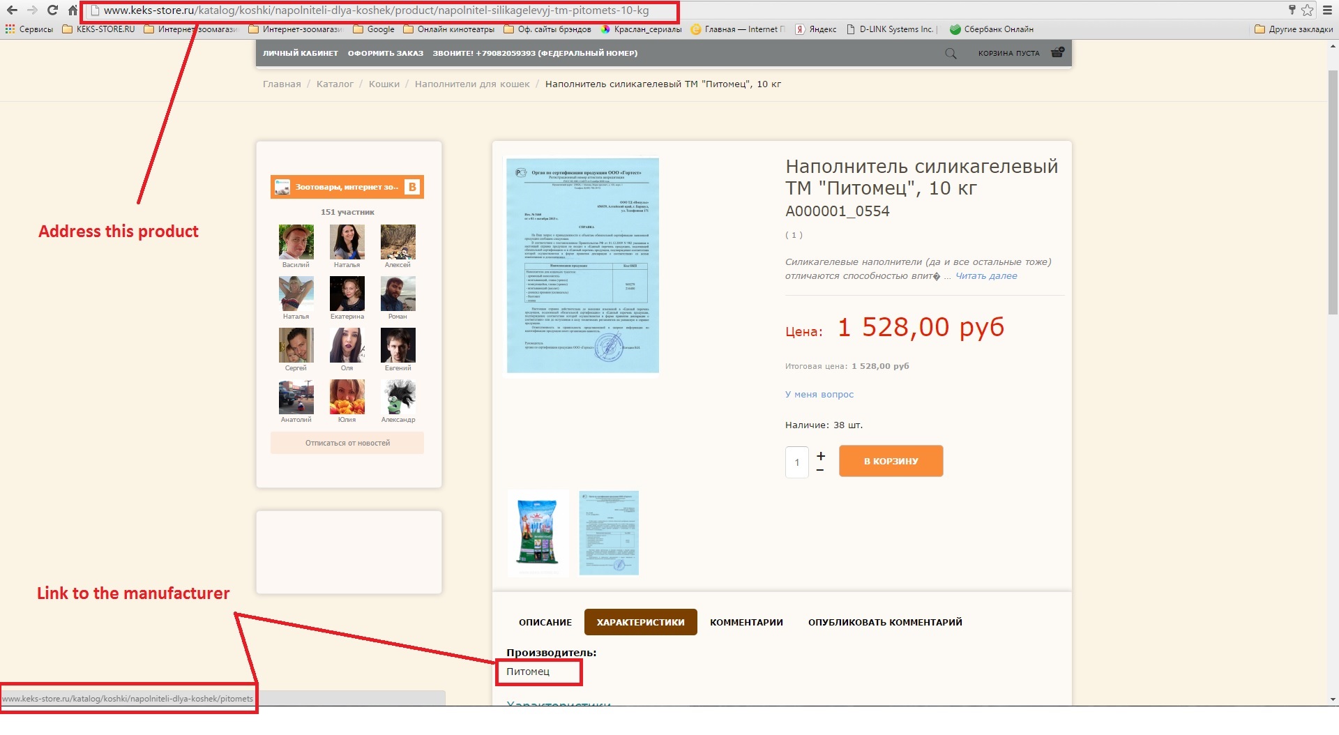

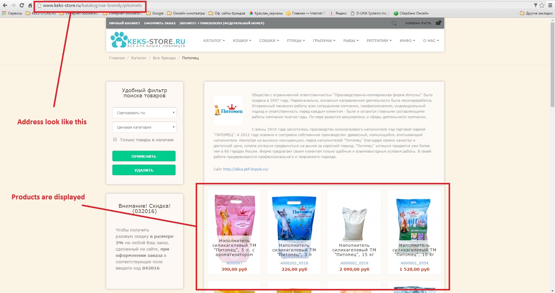

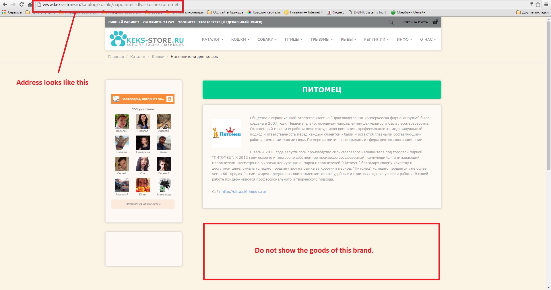

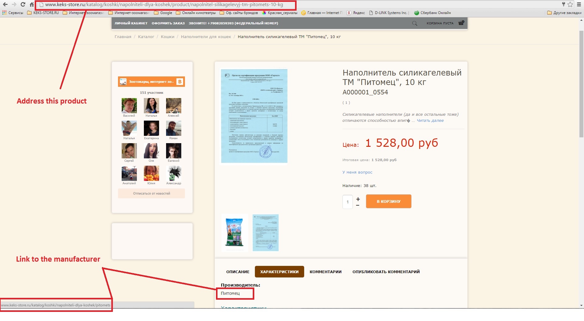

When I turn on the settings "Display the manufacturer", in the item card link appears on the manufacturer. When I turn it on a page where the manufacturer is shown only its description, without the products. But I need to open the page with the manufacturer of its products both in picture 3 when I go to the card manufacturer through a list of all manufacturers. The canonical link to the page manufacturer is shown in picture 4.

1. The conversion of the product name into the alias isn't done by HikaShop but by Joomla via your language package. So the problem should ideally be fixed in your Joomla language package, not in HikaShop.
But we can also add a fix for it, it will be simpler.
Replace the line:
$element->alias = $lang->transliterate($element->alias);
to:
$element->alias = str_replace(',','-',$lang->transliterate($element->alias));
in the file administrator/components/com_hikashop/classes/product.php and that should do it.
2. So the problem is that the thing displaying the brand link on your page doesn't take into account the canonical URL. But it does with the default layout views of HikaShop in recent versions of HikaShop. So I guess you're using old code in a view override for the product page leading to that problem.
From what I can see in your screenshot, I would guess that the problem is with the view file "show_block_dimensions". So please check it.
It should normally have this code:
if($this->config->get('manufacturer_display', 0) && !empty($this->element->product_manufacturer_id)){
	$categoryClass = hikashop_get('class.category');
	$manufacturer = $categoryClass->get($this->element->product_manufacturer_id);
	if($manufacturer->category_published){
		$menuClass = hikashop_get('class.menus');
		$Itemid = $menuClass->loadAMenuItemId('manufacturer','listing');
		if(empty($Itemid)){
			$Itemid = $menuClass->loadAMenuItemId('','');
		$categoryClass->addAlias($manufacturer);
		echo JText::_('MANUFACTURER').': '.'<a href="'.hikashop_contentLink('category&task=listing&cid='.$manufacturer->category_id.'&name='.$manufacturer->alias.'&Itemid='.$Itemid,$manufacturer).'">'.$manufacturer->category_name.'</a>';
		echo "<span style='display:none;' itemprop='brand'>". $manufacturer->category_name ."</span>";

The second problem is not resolved. I took your code and put it here in this file /components/com_hikashop/views/product/tmpl/show_block_dimensions.php
Old code looks like this:
		if(empty($Itemid)){
		echo JText::_('MANUFACTURER').': '.'<a href="'.hikashop_contentLink('category&task=listing&cid='.$manufacturer->category_id.'&name='.$manufacturer->alias.'&Itemid='.$Itemid,$manufacturer).'" itemprop="brand" itemscope itemtype="http://schema.org/brand">'.$manufacturer->category_name.'</a>';
After the change has been no change.

1. So you problem is exactly what I had said here:
www.hikashop.com/forum/product-category-...al-links.html#236552
take.ms/UsBqR
You don't have the correct code in the show_block_dimensions file.
You must not have checked the correct file.
I've changed the code for you and it works fine now.

1. I've changed the code for you and it works fine now.
Apparently I'm not quite true that some did. Now everything is fine, thank you, I'm with you! :)
