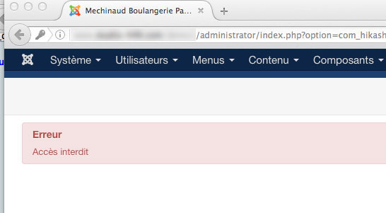

  • Posts: 177
  • Thank you received: 8
10 years 4 months ago #236655
Nothing works : The url gives me an "Error : access denied" eventhough I am logged in.
The error reporting on me joomla global config is blank also.
I even disabled the "Use AJAX when possible..." just in case, nothing does it.

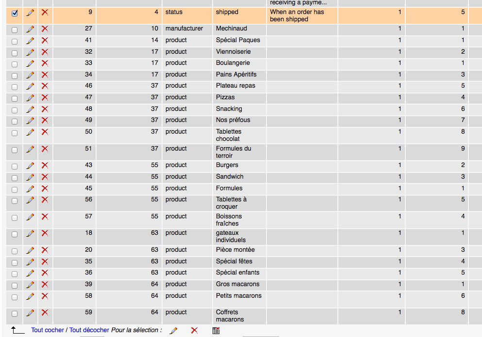

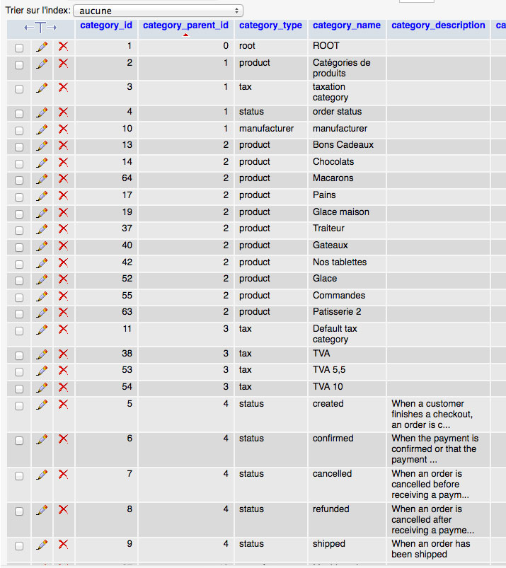

  • Posts: 86058
  • Thank you received: 14184
10 years 4 months ago #236728
Go in your PHPMyAdmin and open the hikashop_category table. Make sure that you have an entry there with the namekey and type "root" and the category_parent_id set to 0. Make sure that you have an entry with the namekey and the type "product" and the category_parent_id set to the category_id of the root entry. Make sure that the other entries are under that category entry or below in the category tree. Then, access the URL /administrator/index.php?option=com_hikashop&ctrl=category&task=rebuild in your backend and that will fix the categories explorer.

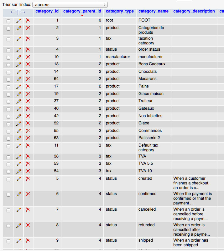

  • Posts: 177
10 years 4 months ago #236807
Done this all.
I still get an access denied.
This is driving me nuts.
  • Posts: 86058
10 years 4 months ago #236836
I think we didn't go in the correct direction.
The problem is apparently not about the category database structure, which looks ok in your screenshots.
The problem is that without the error message on the blank page, we're hitting in the dark.
If the website doesn't display error messages even though the error reporting of the Joomla configuration is activated, you'll have to get the error message from the PHP error log of your web server.
So please search for that fatal error message in there.
If you don't know how to access the PHP error log, you can ask your hosting company.
The error message will greatly help in understanding where the problem comes from.
