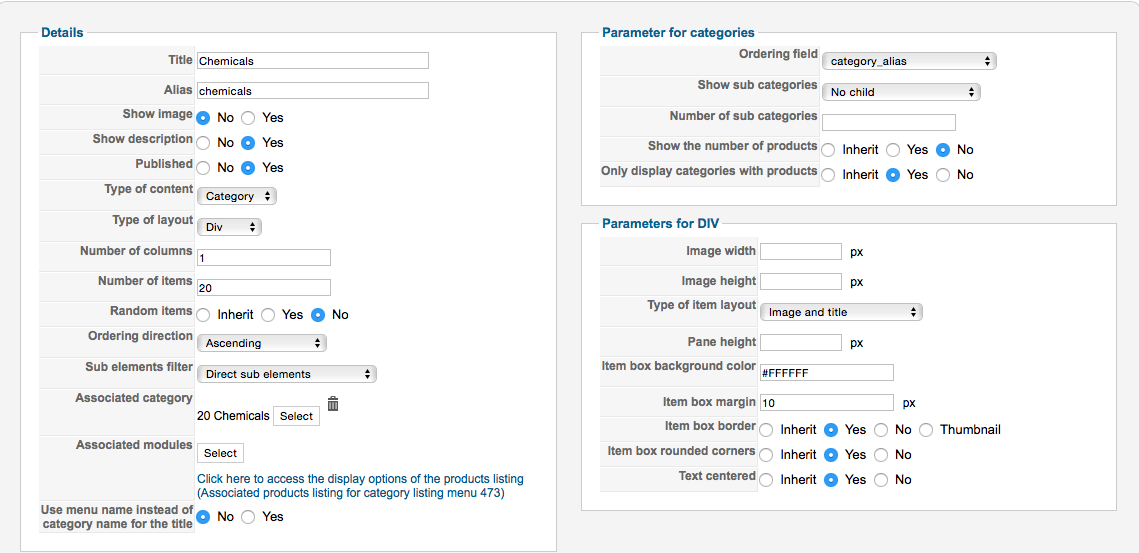

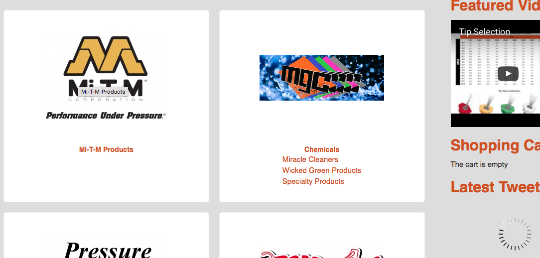

I've have read so many threads on removing subcategories from the menu and have followed the steps advised on most of them. I have changed the settings to those recommended on this forum and still have subcategories showing up on my menu. Please help! I have included screenshots of both the settings and the actual site.

In your screenshot you provide the options of the categories listing menu item. That's not the ones you need to look at. You need to look at the settings of the associated products listing module (in the area below on that same page).
There, you need to make sure that the "sub elements filter" setting is set to "direct sub elements". Also, you need to make sure that you didn't add the main category in your products' "categories" setting.
