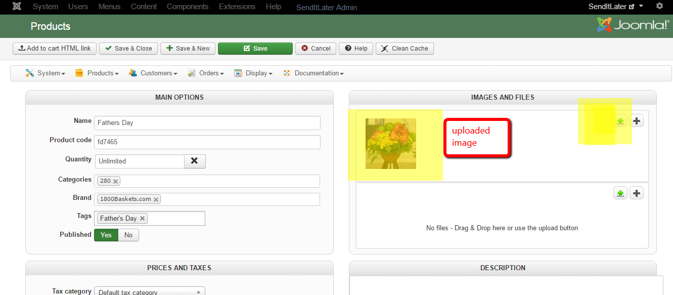

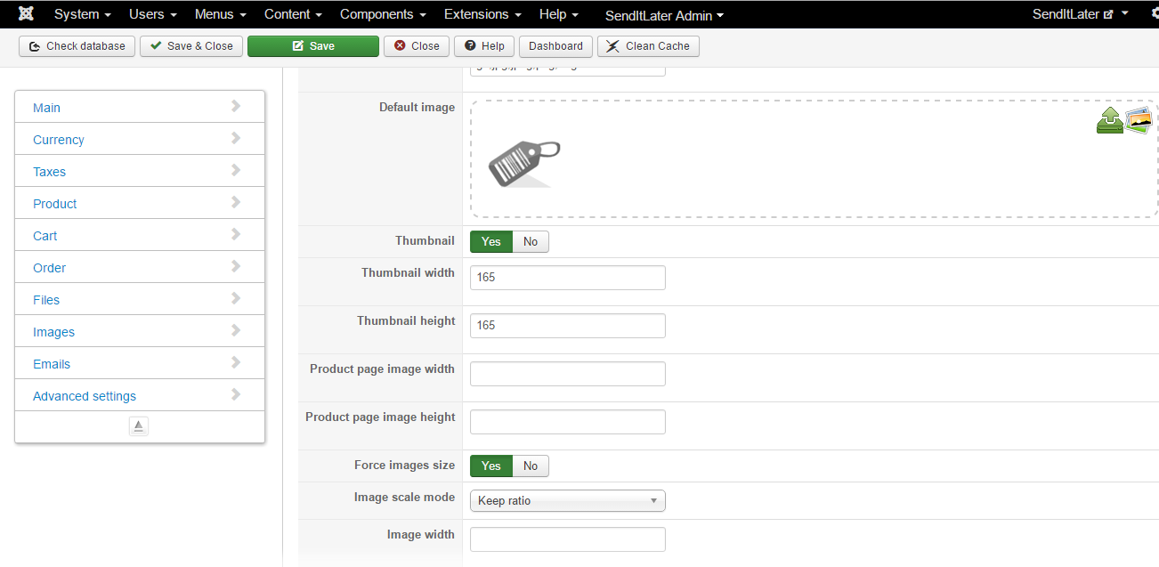

I am talking about the product images when we add a product from hikashop admin. I have defined the thumbnail height and width s 165 in hikashop configuration. When i add a product from hikashop backend and upload a image then it should create a product thumbnail of 165x165 under folder /thumbnail/165x165 but it is creating a thumbnail of 100x100 under folder 100x100. or in other words i want to create a thumbnail of 165x165 when we upload a product image from hikashop backend . how we would do that. thats my concern. Please see the attached images for you references

10 years 4 months ago #237478
As I said, that setting is only for the listings of your frontend. So it's normal that the thumbnails in the uploader don't use that parameter.
If you want to change the size of these thumbnails you need to change the lines:
$img = $imageHelper->getThumbnail($file->file_path, array(100, 100), array('default' => true));
to:
$img = $imageHelper->getThumbnail($file->file_path, array(165, 165), array('default' => true));
in the file administrator/components/com_hikashop/controllers/upload.php
