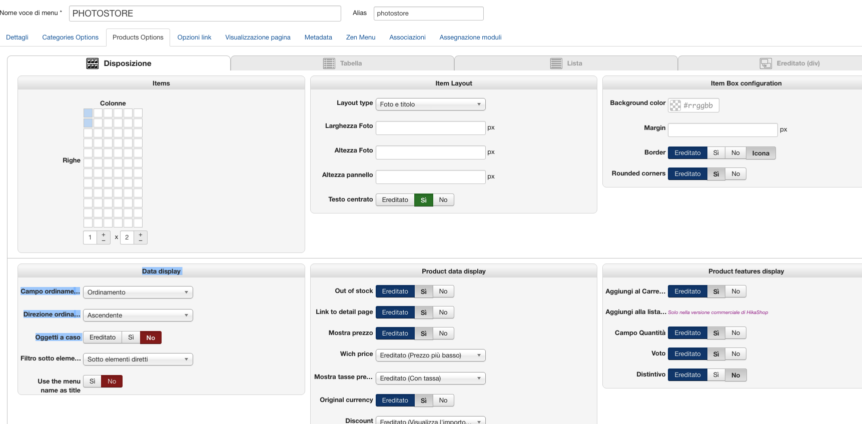

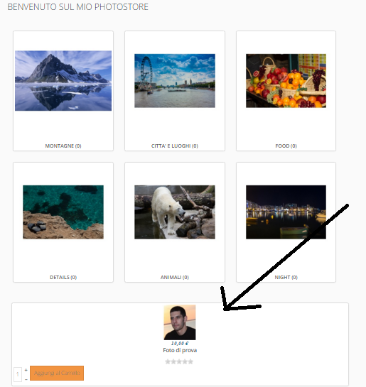

Hi All,
i made a menu with category display HS but under the category the system show the product!
I can't solve this problem! How can i remove it???
ps: category data display is setting on "No Children"
  • Posts: 86058
  • Thank you received: 14184
10 years 4 months ago #237319
In the "products options" tab of your menu item, set the "sub element filter" setting to "direct sub elements".
  • Posts: 177
10 years 4 months ago #237526
Ciao NIcolas,
i did it! But it doesn't work at all! :(
  • Posts: 86058
10 years 4 months ago #237529
Then please make sure that the products are not associated to the main category of your listing.
  • Posts: 177
10 years 4 months ago #237609
Works! Thanks!!
