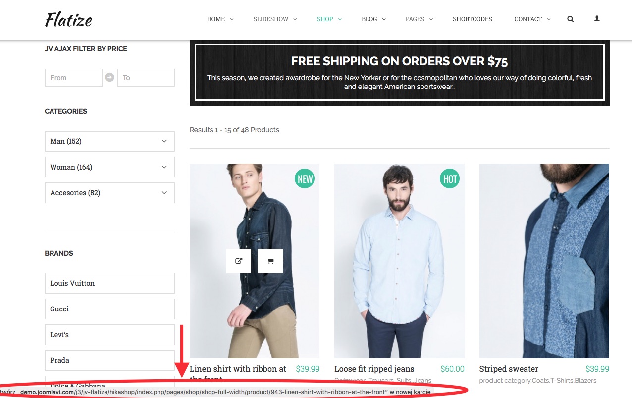

  • Posts: 196
  • Thank you received: 15
10 years 4 months ago #237546
Unfortunately, we not understood.
The problem of overwriting the template has been solved by the manufacturer :)
My request concerns the same configuration Hika.
In the Category View you can see the products, etc., And the list of categories (module) in the position of sidebar.
demo.joomlavi.com/j3/jv-flatize/hikashop/index.php/shop-sidebar
After clicking on the selected product - displays the product page, but without the list of categories in the sidebar:
demo.joomlavi.com/j3/jv-flatize/hikashop...-ribbon-at-the-front
Once you click it really brings us to the display of products from another menu: demo.joomlavi.com/j3/jv-flatize/hikashop...shop/shop-full-width

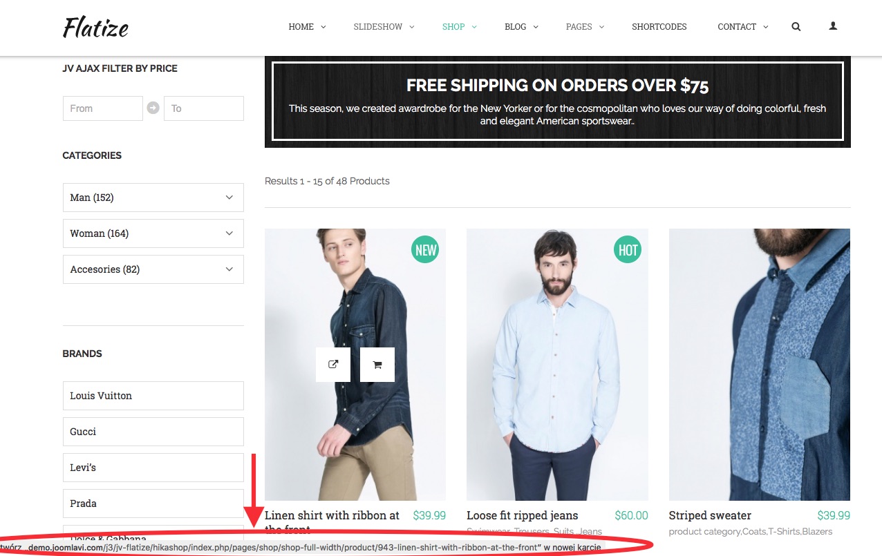

In the screenshot you can see the category of products and sidbarem and selected link that redirects you click on a product.
How to configure so that it worked? I tried to play it with quickstart - no effect :(

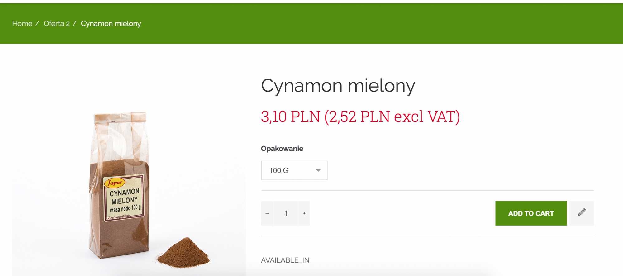

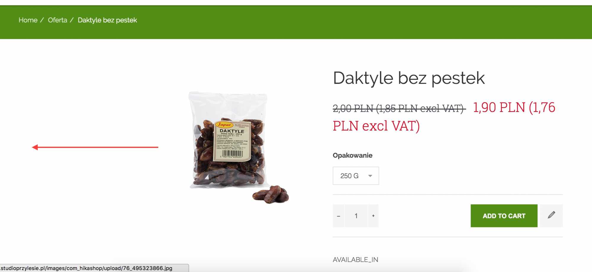

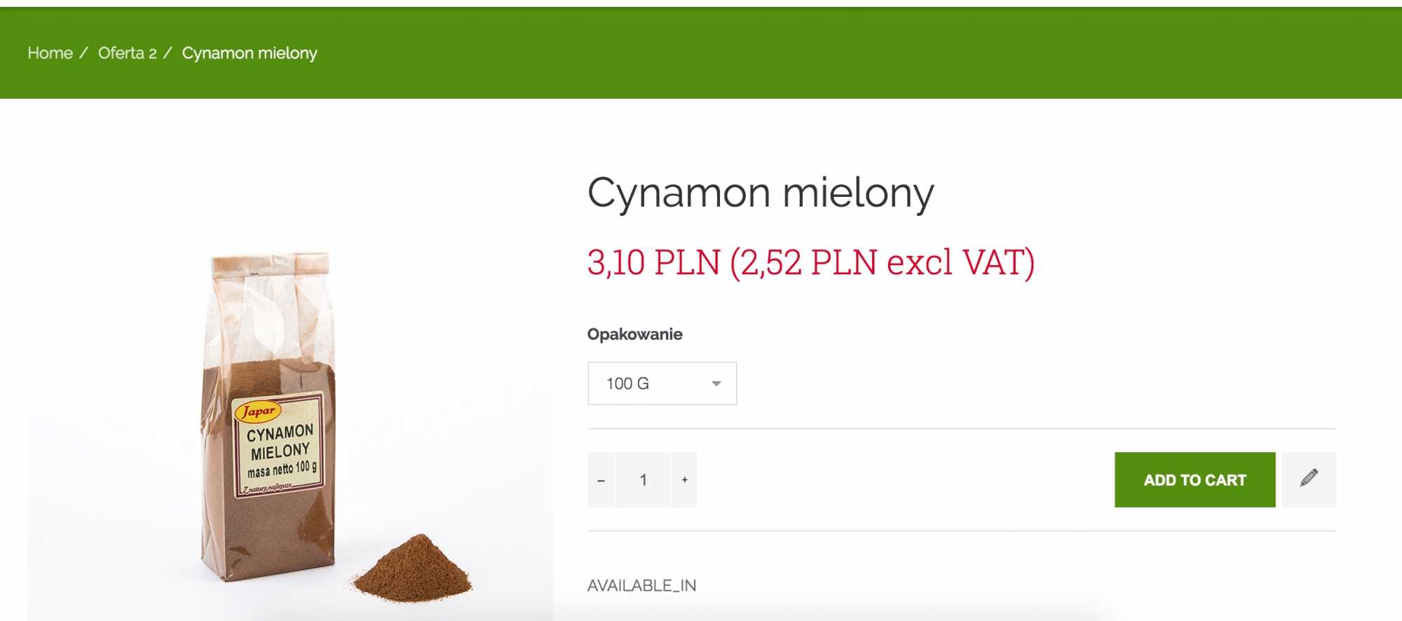

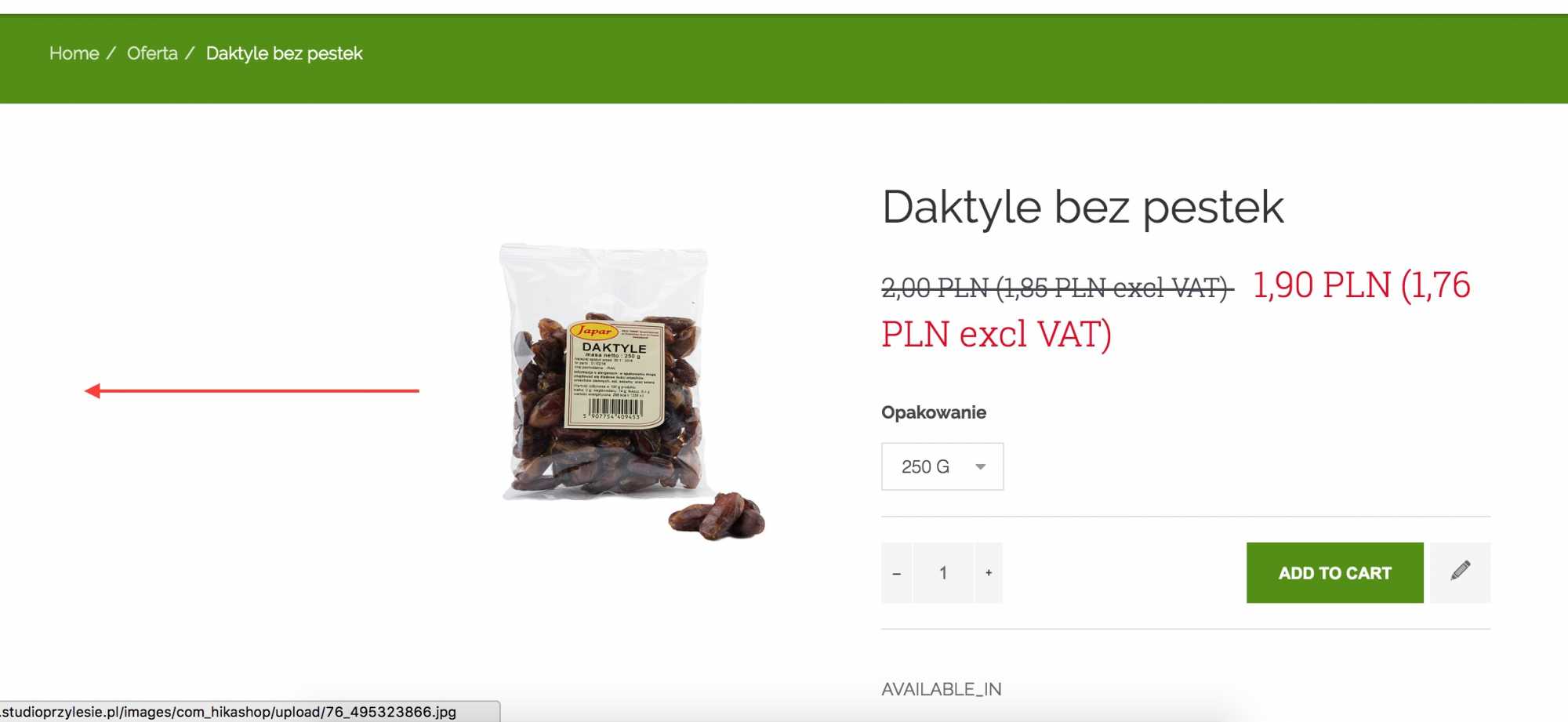

  • Posts: 196
10 years 4 months ago #237747

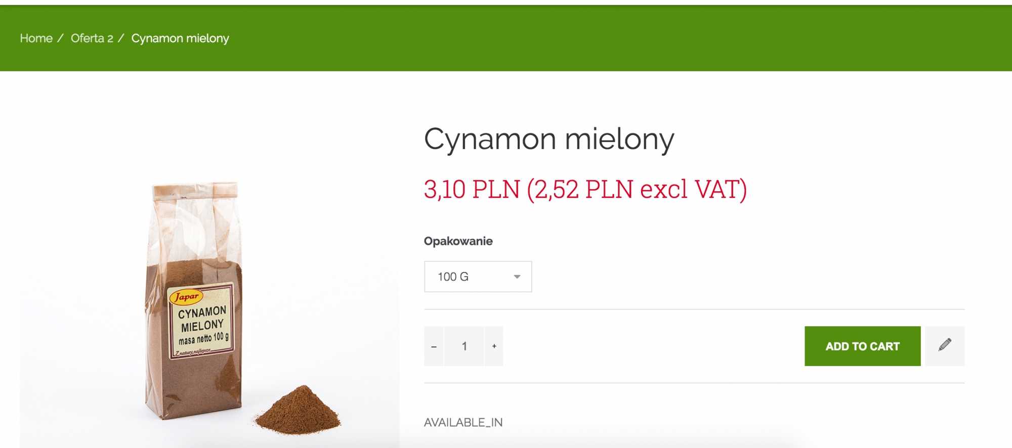

In the earlier example given is otherwise resolved.
The way that you specify is partially good. Category list is not displayed, but it takes place and there is empty (screen 1), and to be as screen 2.

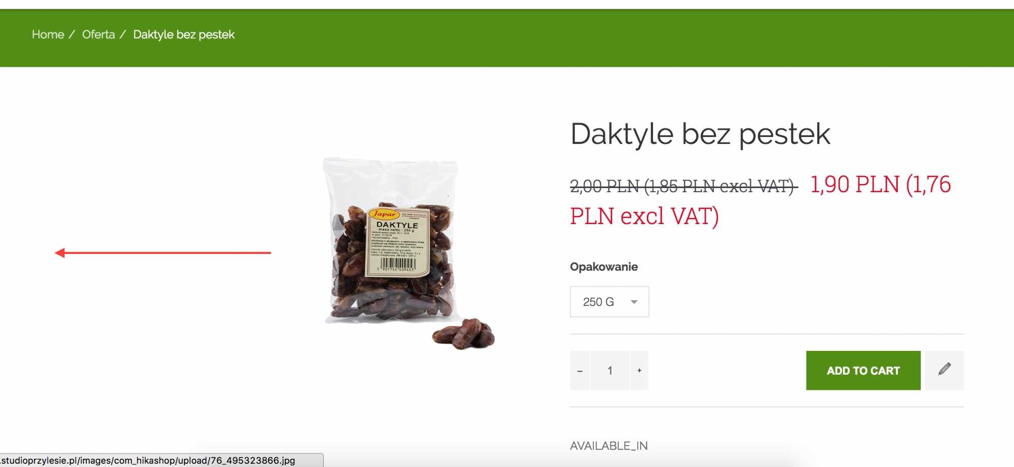

  • Posts: 86058
  • Thank you received: 14184
10 years 3 months ago #237860
From what I can see the problem is with your Joomla template which still displays the area even though the module doesn't give any HTML to be displayed in the area.
Normally, the template should remove that area in such case.
Please check with your template provider about that problem.
