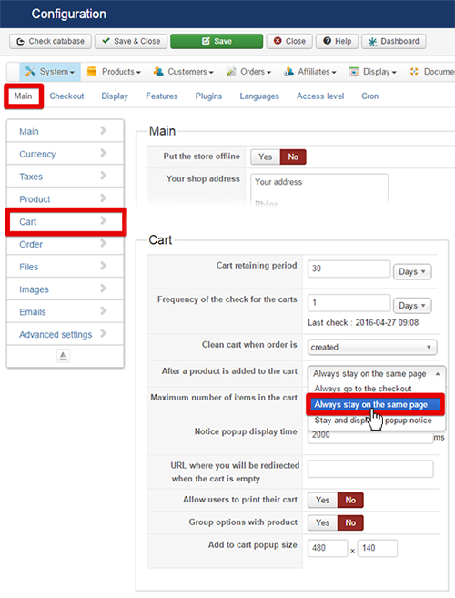

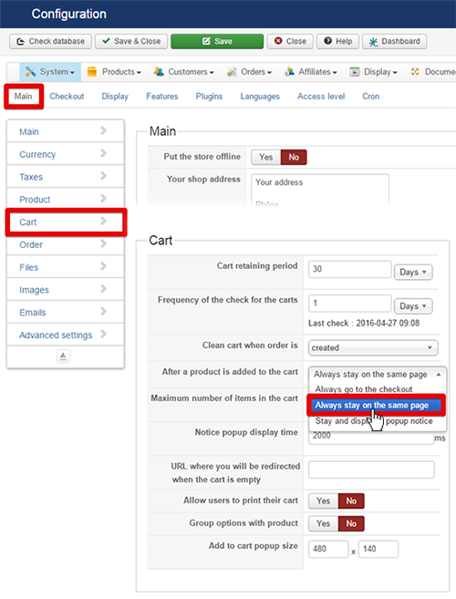

There is an option that refresh AND display the popup window (Proceed or Continue shopping popup)
To reach and configure it, go to :
- Components => HikaShop => Configuration
- Go to Cart part, and look for "After a product is added to the cart " option and switch to "Always stay on the same page"
- Don't forget to Save your configuration.
Hope this will help you.

Second point, can you go to your configuration :
- Components => HikaShop => Configuration.
- Main tab, and Cart part
- Look for "After a product is added to the cart" and switch to "Always stay on the same page"
- Save your configuration.
Awaiting news from you.
Regards.
