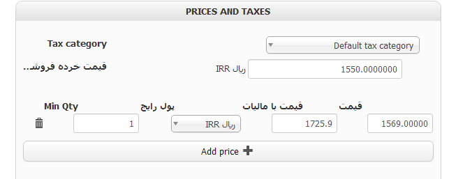

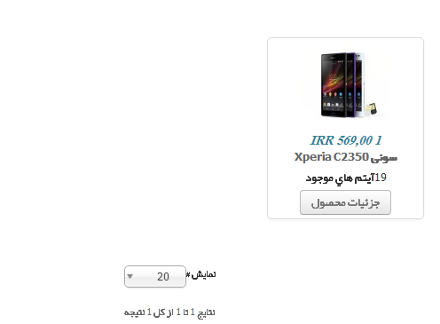

Thank you for your reply. Unfortunately, I am running the website on my localhost, Otherwise I would give you access to this page. But, I have attached some screenshots to this topic.
In the picture called "Price 1", I saved prices in Iranian rials and it seems right. But, what I see on the website is shown on the picture called "Price 2". The price is exactly viceversa.

  • Posts: 86058
  • Thank you received: 14184
10 years 3 months ago #238499
Thank you for your screenshot.
As I had guessed, the problem is different. It's not vice versa. It's just the separator of the currency which is a space and thus the RTL system of the browser swap the groups.
To avoid that, edit your currency via the menu System>Currencies and remove the space for the "Groups separation" setting there.
You can also set the "International fractional digits" and the "local fractional digits" settings to 0 if you don't want decimals.
