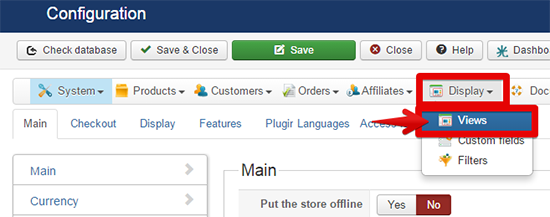

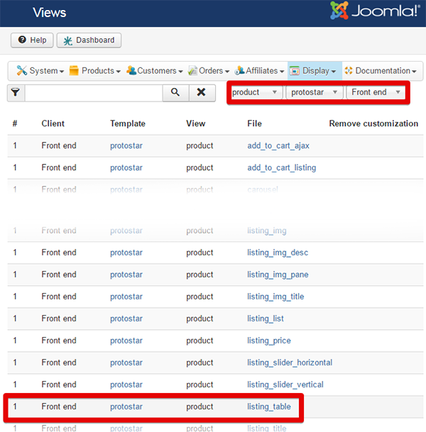

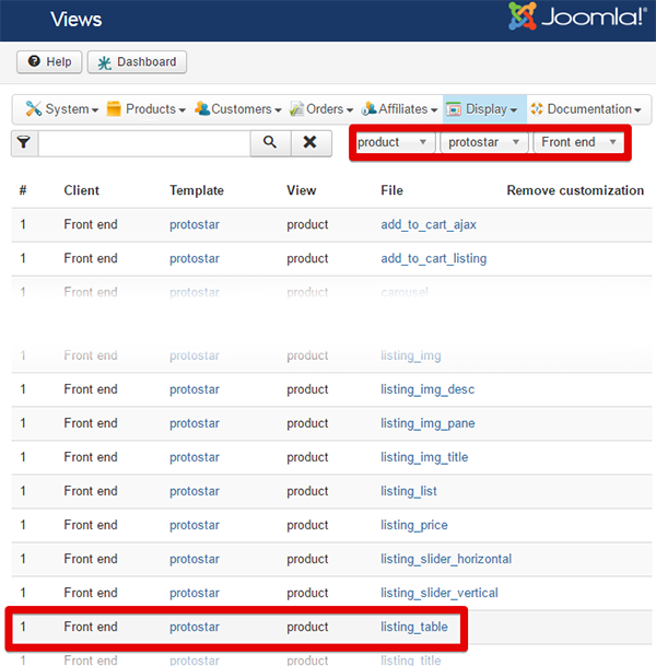

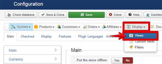

In order to have product description on your table listing you must create a override view on your product/listing_table.php.
For this follow the way :
- Go to Components => HikaShop => Configuration
- On Display dropdown, select Views
- Use dropdown to filter results, first on "Product", second with your front end template and last on "Front end"
- And look for listing_table, and click on it

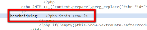

Thanks for the quick reply. It was clear for me how to override the view. It is not clear to me what code to add. I think your last tip about the code is not correct because it is not working. My code looks like this:
It is not showing the description. What am I doing wrong?

Philippe was a bit fast there.
It's this code:
<?php echo $this->row->product_description; ?>
