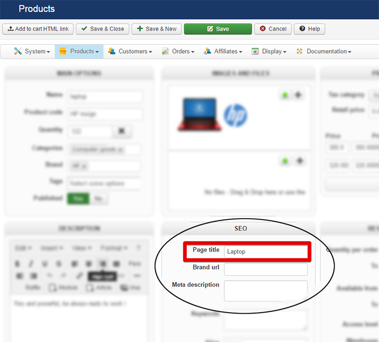

For products :
- Go in your product back end configuration, and find SEO part, and fill Page Ttile.

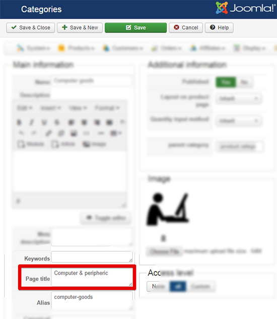

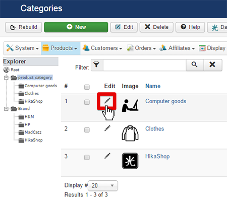

For Menu/Categories listing :
- To edit your categorie listing click on little pen icon
- And fill your page Title
Hope this will help you.
Regards.

That's the name of your main category. Go in your categories listing, click on the "root" category on the left, then edit your "product category" category and change the page title there.
