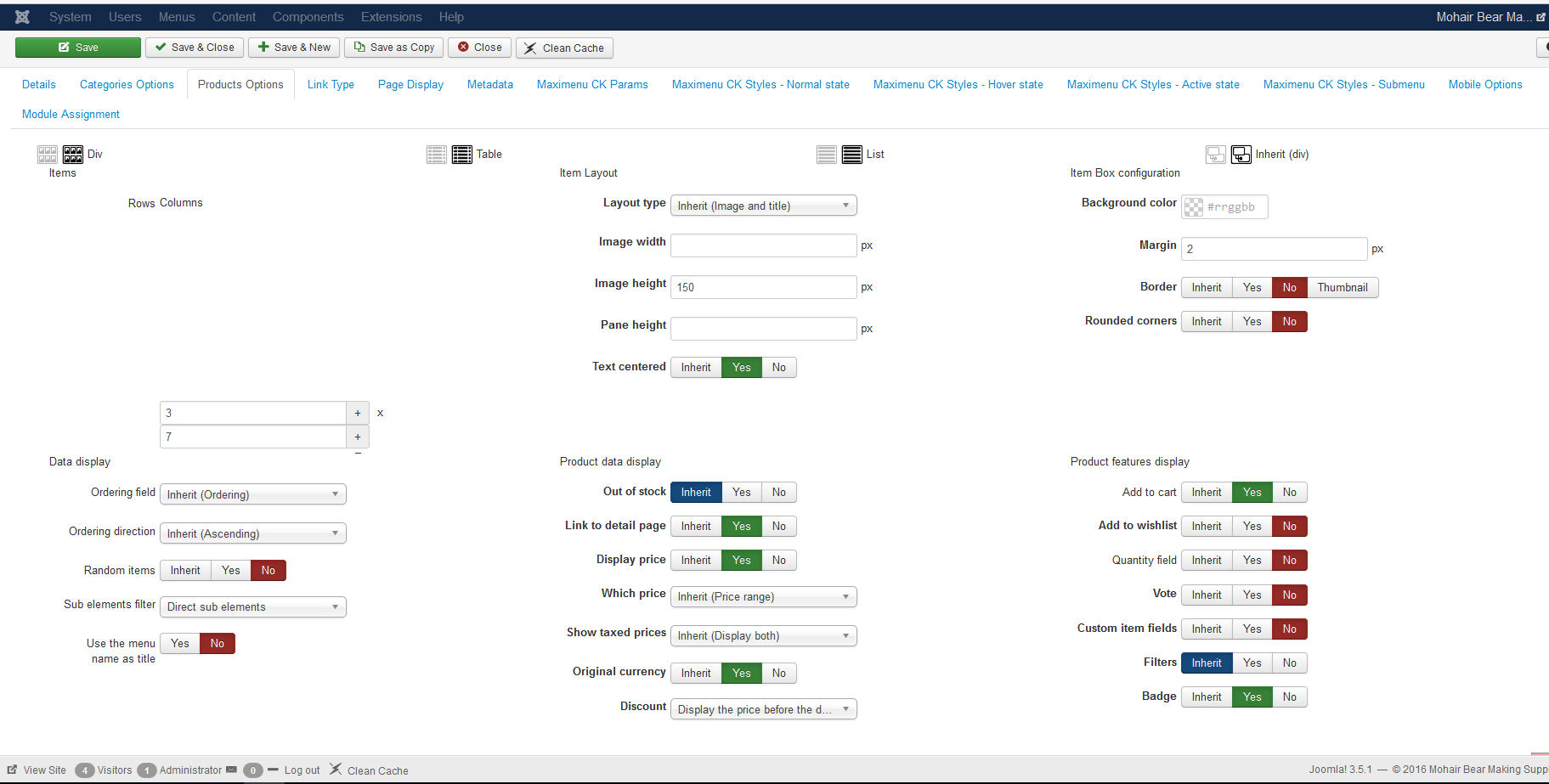

If you still have the problem, please provide a screenshot of the products options tab of the menu item, there might be a problem there.

Hi, I have the same problem and tried your suggestions and nothing works. Attached is screen dump of product settings.

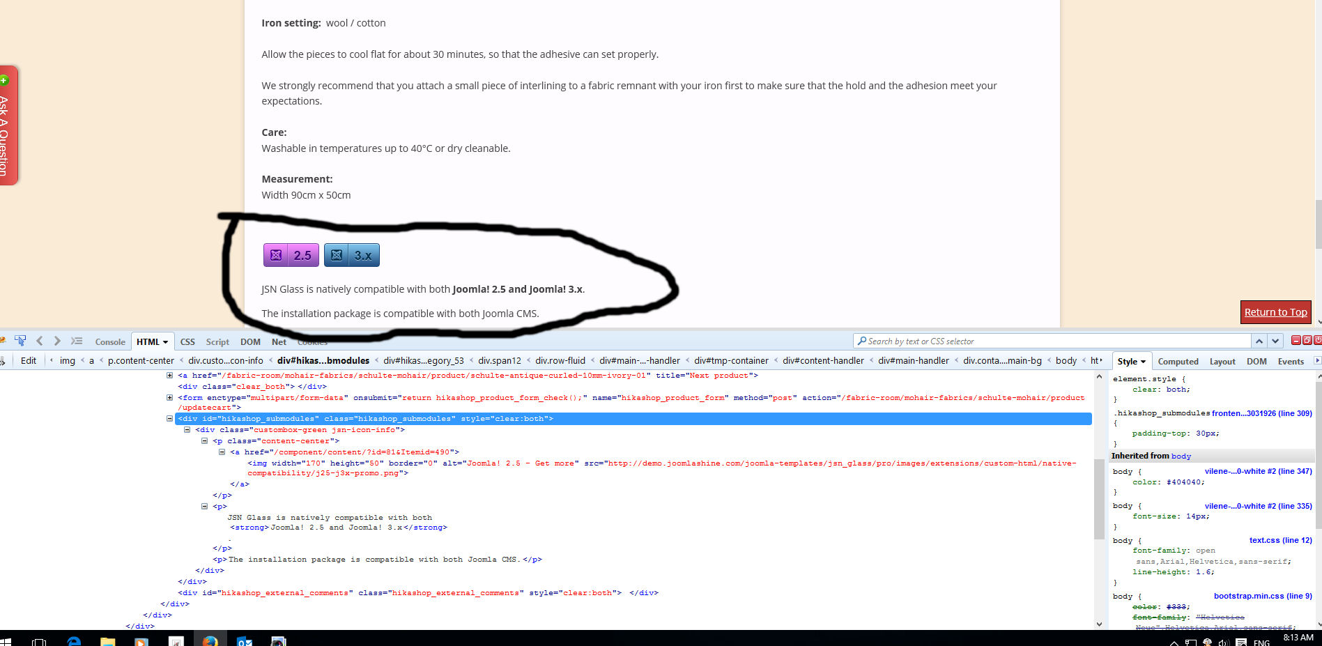

I have found reference to this code 2 years 4 months ago as it was the only way I could find to get rid of the annoying Joomlashine code which has hijacked Hikashop products? please seen screen dump as I cannot find a way to get rid of it? any ideas as to where they have put this code please@

10 years 3 months ago #239889
It either comes from the view overrides of the product page layout or their module has been enabled in the "modules under the product page" setting of the HikaShop configuration.
But I would recommend to check with them what to do to remove it.
And there is an easy solution in that case. Use that CSS:
.hikashop_product_page .hikashop_submodules {
display: none;
That way, your CSS will only be enforced on the sub modules of the product page, not on listings.
