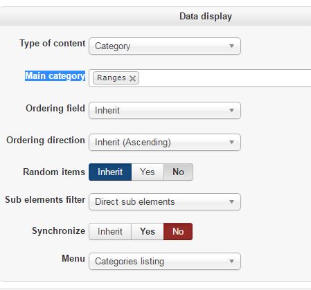

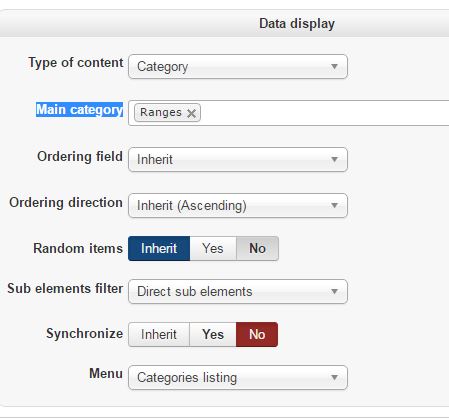

for example I have created a module to display a category "Ranges" (Ranges is a category specified in the hikashop tab in the module - Main category)
this was done by specifying the menu ""hikahop defaulty category listing "

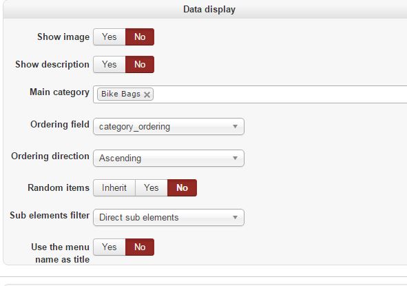

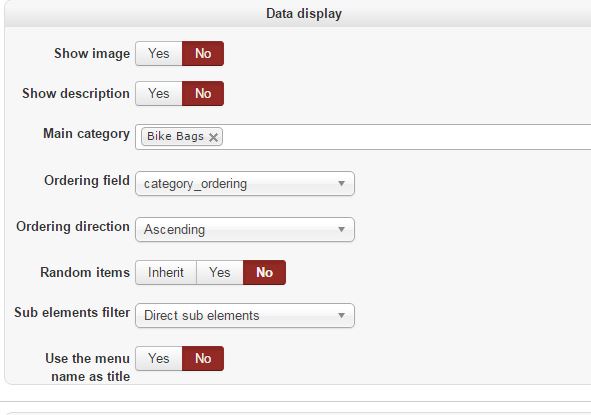

What confuses me is that the menu item "hikahop defaulty category listing" also has a hikashopcategory settings tab and that has simialr settings - in this case the category is set to "Bike Bags" - but that seems to be ignored?

A menu item adds a link to a menu area. That link goes to display in your case a categories listing, and products listing. So it has settings both to display categories and products.
If the current category doesn't have sub categories, then you only see products.
A module directly display its content in its position. And the "menu" option of the module is the "target" menu item which used when you click on a link of the module to display the products/categories of that element.
And yes, when you click on a category, be it in the menu item categories listing itself, or in a module pointing to that menu item, it overrides the category selected in the settings of the menu item.
