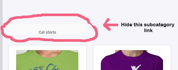

I looked everywhere but could not find an answer on how to do this. How to I remove the subcategory links that appear on the category view?
On the menu item > category options > category data display the option selected is "no child"
Also on the configuration > display > Default parameters for categories > Show sub categories is set to "no child"
How do I hide the subcategories in category view?

There is no option to hide the sub categories listing on a categories listing.
Why not change the type of the menu item to a products listing if you don't want to display the sub categories ?
Or why have that sub category in the first place if you don't want to display it ?
You can potentially hide it with CSS, but normally it shouldn't be a problem to display the categories listing on a menu item of the type categories listing...

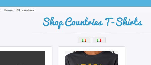

Thanks again Nicolas using the Products listing menu type worked for me.
The reason why I didnt want to display the links is that Im making my own buttons for the subcategories, as you can see in the picture.
Thanks again for pointing me in the right direction.
