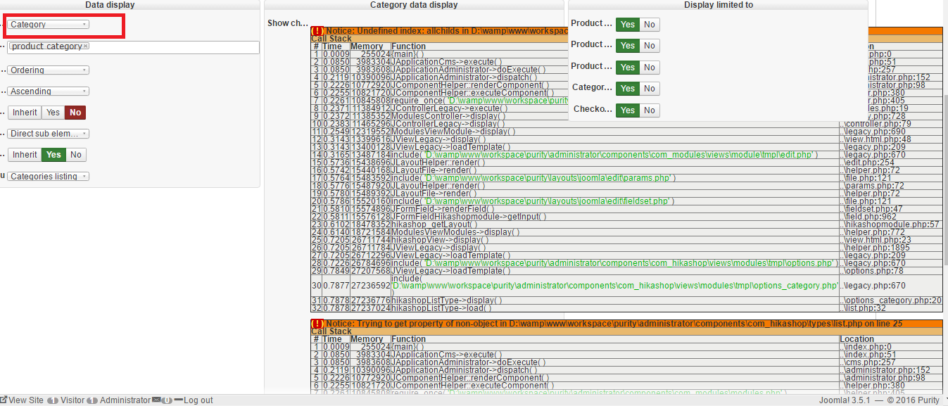

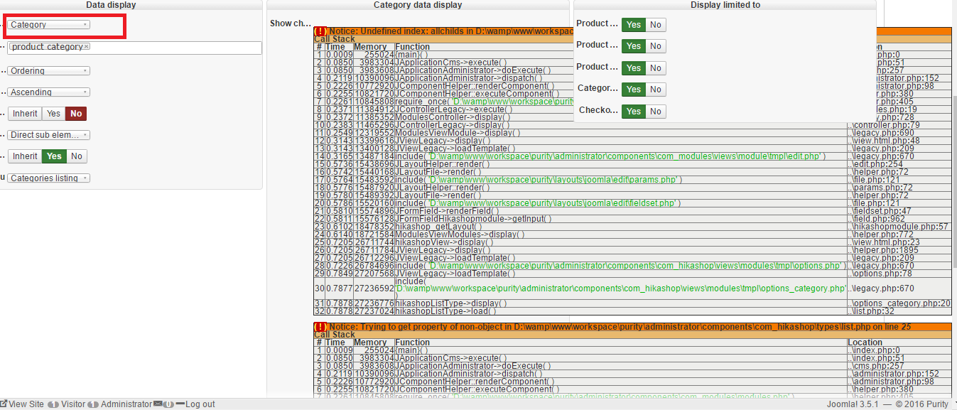

I am following the FAQ (How to add a tab in the tabular view ?) to add the custom tab to my product layout,
I was trying to apply related products module to replace the current content module, but when I set data display -> type of content to category or brands, I got this error message, please see the attached screenshot.

Turn off the "error reporting" setting of your Joomla configuration and you won't get the warnings.
1. 2. No they don't. You would have to add a tab to the show_tabular view file. Here is a thread about that:
