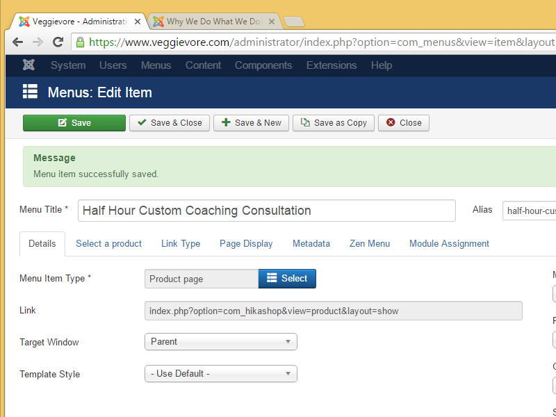

The problem I seem to be having is that I am not even able to find access to the "HikaShop Options" as described on the following page:
www.hikashop.com/support/documentation/2...splay-front-end.html
I remember those options well from when I first set up the shopping cart. The image I attached shows where I was expecting to find the HikaShop Options link.

There is no such option at the menu item level.
There is a "layout on product page" setting in each category and in each product.
So that's where you want to look I guess.
