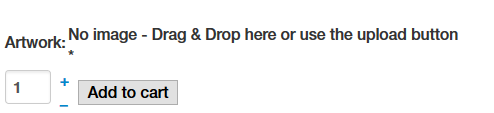

In testing we discovered that using the custom field type "File" allows a customer upload to overwrite an existing.
Though the field type "Ajax File" creates a unique name, it's not intuitive.
The text on the product detail page indicates:
"No image - Drag & Drop here or use the upload button"
This should probably read "file", not "image" to avoid confusion (not all files are images).
There is no upload button displayed - though the customer may discover in experimentation that the field label is clickable to trigger a "Browse". This is shown in the first attachment.

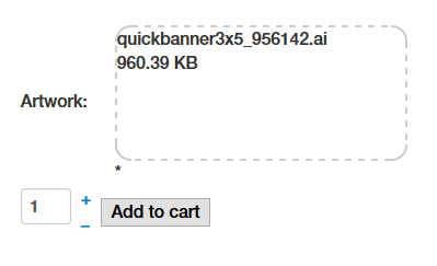

There also isn't a visible drop target displayed for the customer to drag and drop files to initially...so they have to guess on where to drop files to within the page.
If they drag a file over the right element through experimentation, then the target will appear (as in the second attachment).

Here is how it displays by default with the default CSS of HikaShop and protostar:
take.ms/445aG
As you can see, there is a border by default and there is an upload button so that the customer can click on it.
Regarding the text being "image" instead of "file", there is indeed an issue with that.
A simple solution is to use a translation override to change that on your end:
We'll look at that to fix that.
