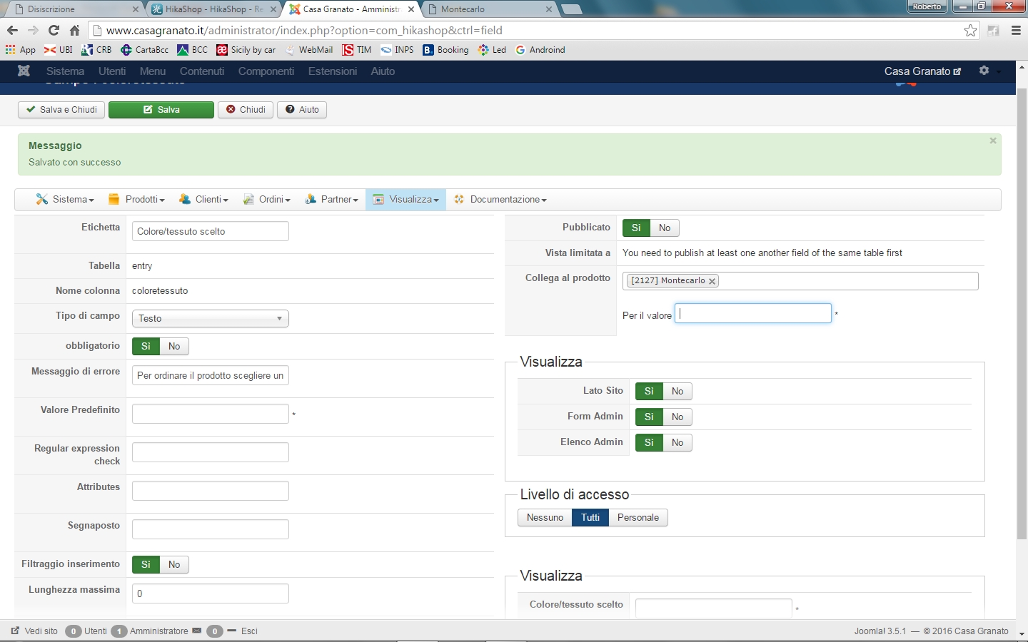

  • Posts: 10
10 years 2 months ago #243298
ok I'm a nerd....
I made a custom field type 'item'.
This field is mandatory....
Is published
and is connected to a specific product
but it doesn't appear...... :S
P.S. item in italians is 'VOCE'

10 years 2 months ago #243300
Scusa, but you did not create an "item" field, but instead an "entry". See in the field configuration under "Tabella". So, you want to delete this and create a new field, for which you select the correct equivalent for "item" under "Tabella" = "Table".
(Maybe the translation isn't perfect in this area... in case of doubt switch the admin language to English temporarily?)

  • Posts: 10
10 years 2 months ago #243316
Yeaaah!
haha sorry! Item means both voce' and 'object' hahaha! I tryed all but not that! So it seems to be ok1 Thank for assistance to all!
