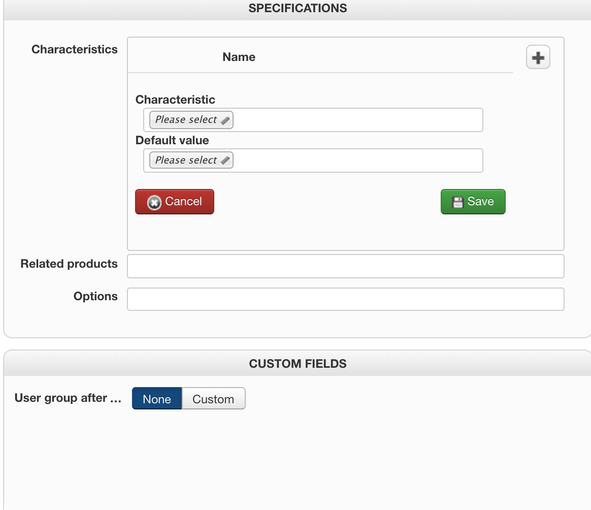

I created the field author (as text field) in product table. But in the product details i cannot add the author name. There is no way to add it.
And about the publishing date? I think do i have to use date picker? Or what?

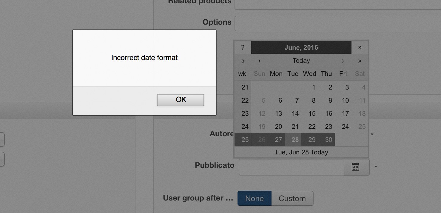

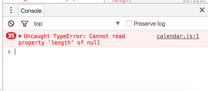

I tried the field simple date picker but i cannot select any date because when i click on the day of the mini calendar no any date appears.
I see the error i attach here.

Sorry, didn't mean these specifications in the product add/edit pages (not sure why the section is named that...). That's "Characteristics" etc as you can see.
So, whatever you've done there, please revert.
Instead, in the HikaShop backend go to -> Display -> Custom fields. There create new custom fields, one for author, another for publishing date, etc. See the link in my previous post for details.
Then you'll be able to fill in these fields in the product add/edit pages in the "Custom Fields" section.
In the frontend, on product pages, custom product field names and values will be displayed under a legend typically named "Specifications"... ( see example here ) which I was referring to, and which caused the confusion, obviously... thanks to two different meaning of "Specifications" in front end and backend... :(

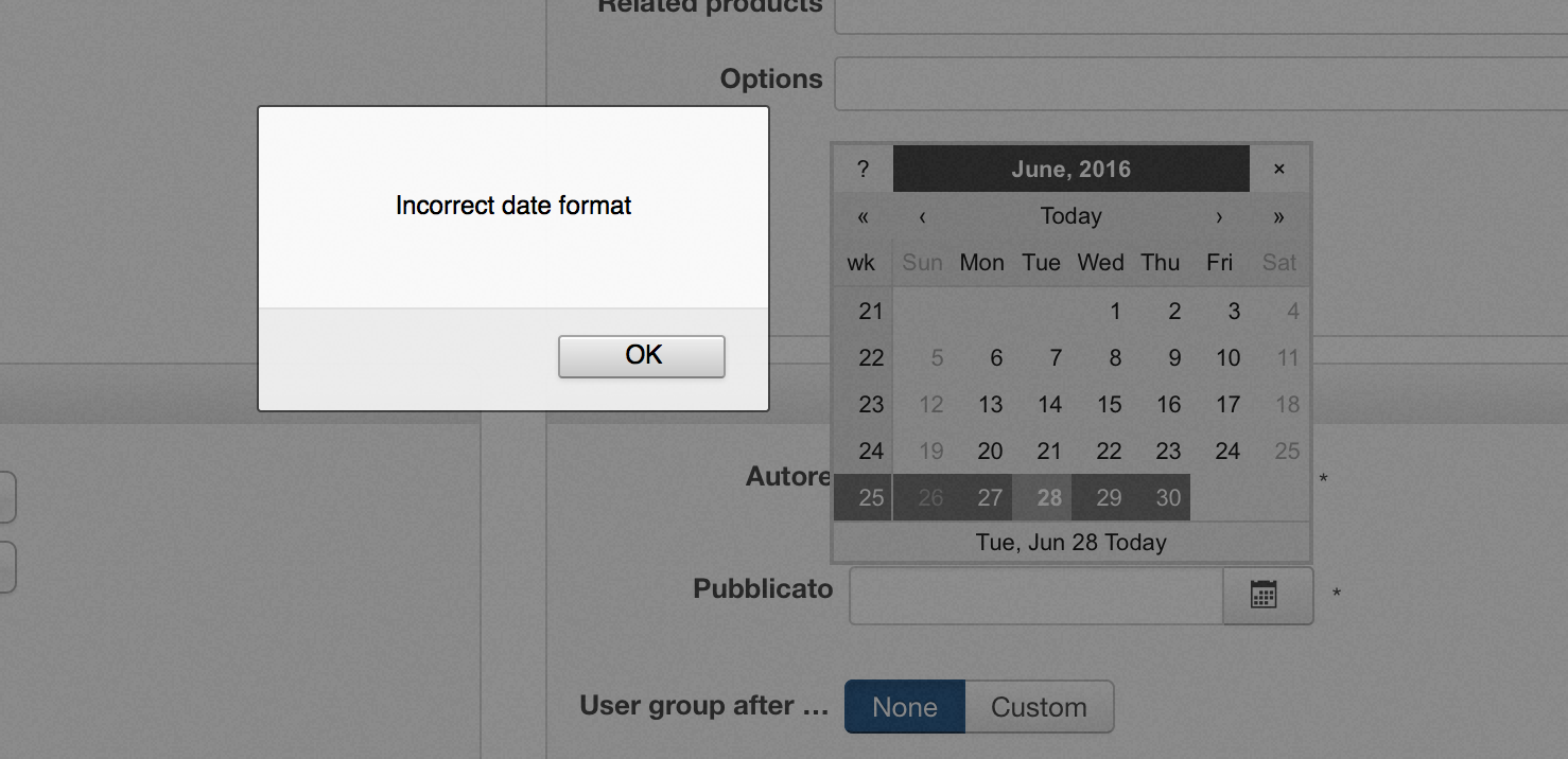

9 years 11 months ago #244194
Ok it was unpublished and i published it. Why you don't show an alert in hika shop if some plugin isn't enabled? However now i get another error when i try to set the date. See the attachment.
  • Posts: 106
9 years 11 months ago #244262
Waiting for your solution. I cannot save new product yet because the date field is required and i cannot add it for the issue i told you above.

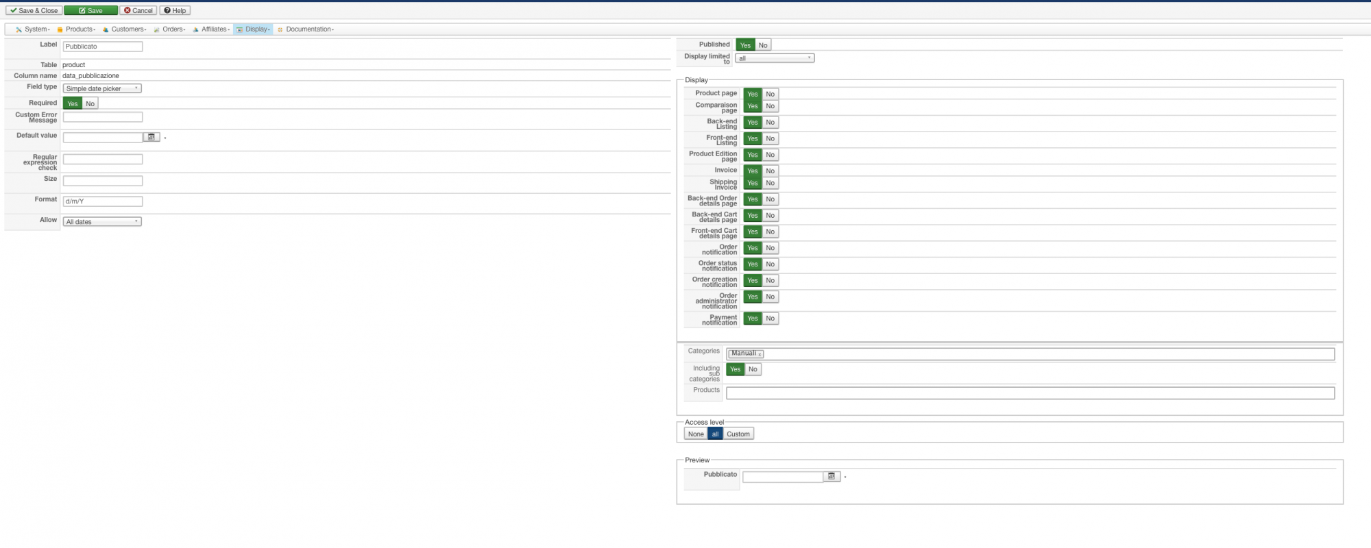

  • Posts: 106
9 years 11 months ago #244283

Re. date format:
1. As already said, just in case, please make sure you have a very recent 2.6.3 as the one you have now might miss some brand-new hot fixes. Please confirm that you downloaded the latest HikaShop package and installed it since my previous post.
2. If so, and if the error persists: Please post a screenshot of the settings of the date picker field.
I downloaded and installed the last package yesterday in the night after i read your reply, so i think it is the latest.

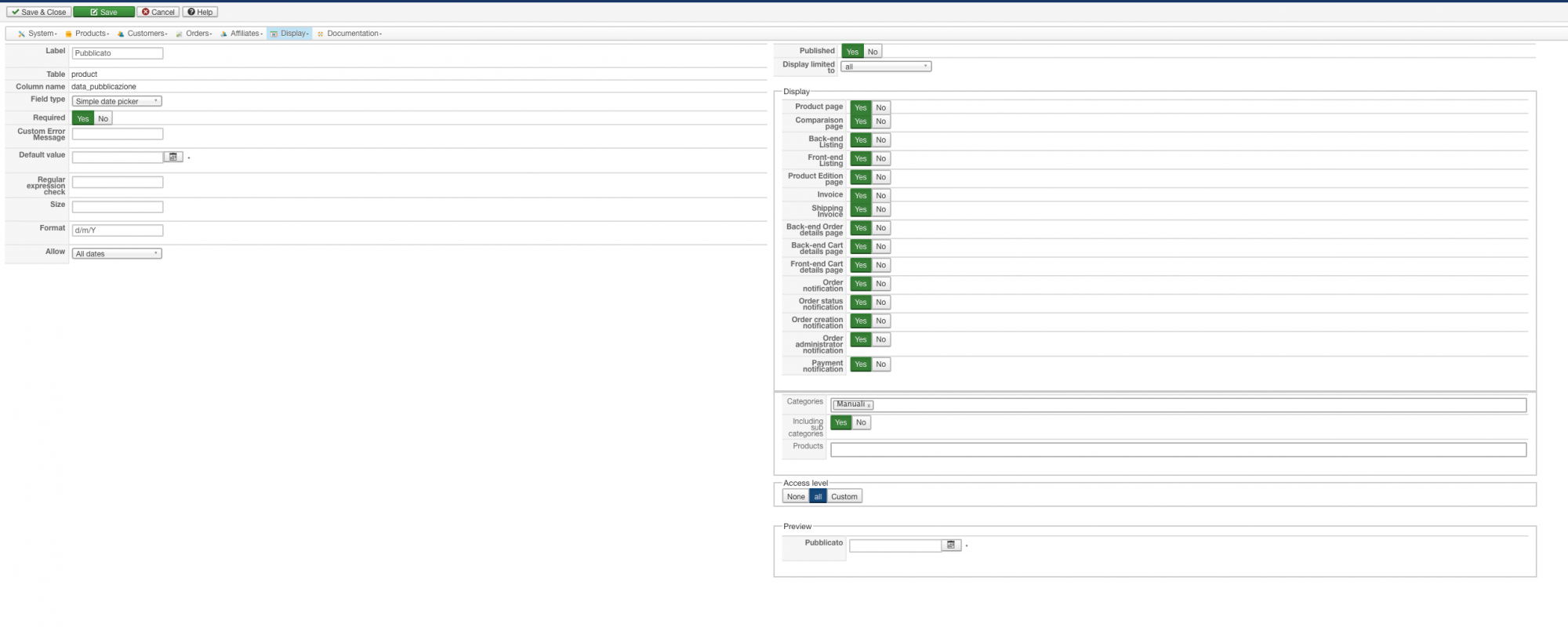

I attach the settings of the date picker custom field as you asked me.
Thanks.
Best regards
  • Posts: 2143
  • Thank you received: 747
9 years 11 months ago #244284
As I said in my post above :
... you should be able to find the option "Advanced date picker" in the "Field type" dropdown of the custom field configuration. Use this, it should work.
But you set it to "Simple date picker", not "Advanced".
So, please do as suggested, save, and try again.
  • Posts: 106
9 years 11 months ago #244286
You are right, now it works. So the question is why the simple date picker doesn't work?
