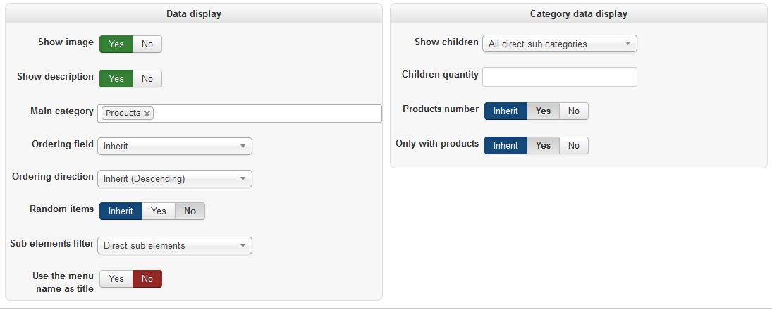

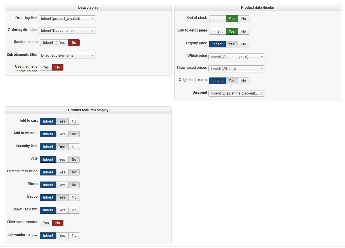

The Product Options are configured thus:

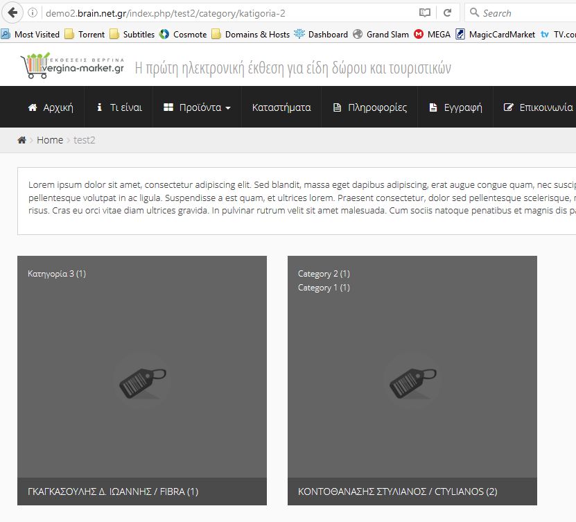

However when one clicks on a subcategory that actually has products (ie subcategory1) nothing happens, no products are displayed and the page only refreshes to the same content but with the new url. (from index.php/menu2 to index.php/menu2/category/subcategory1)

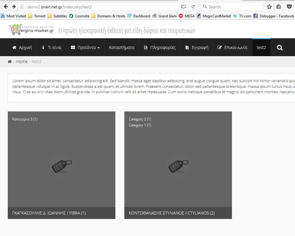

9 years 11 months ago #244994
Hello and thank you for the reply.
A demo version of the page can be found here: demo2.brain.net.gr , the link is the test2 on the upper right.

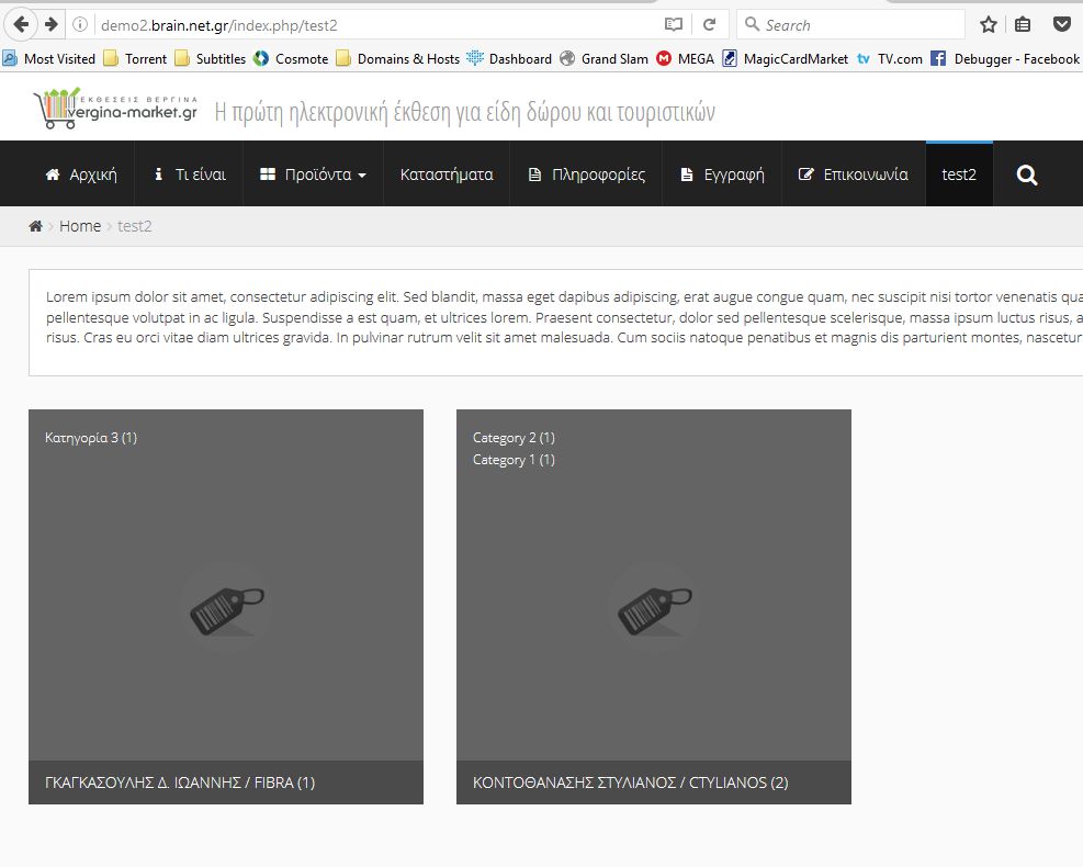

This is what is shown when clicking on the test2 link (details on its configuration are in my initial post)

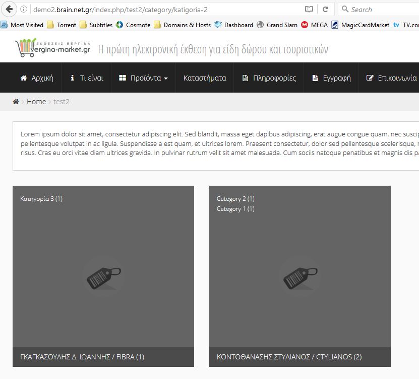

And this is what happens when one clicks on category 2. The only thing that changes is the url
The template used is the JVFashion, which does have overrides for Hikashop views. I renamed the listing.php that you suggested but nothing changed. Perhaps it is some other override?

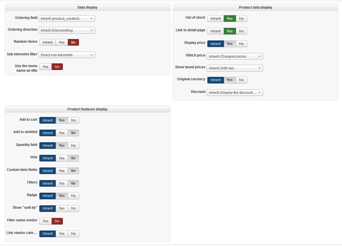

9 years 11 months ago #245003
I had a look on your configuration screenshot, can you please reproduce this configuration please ?

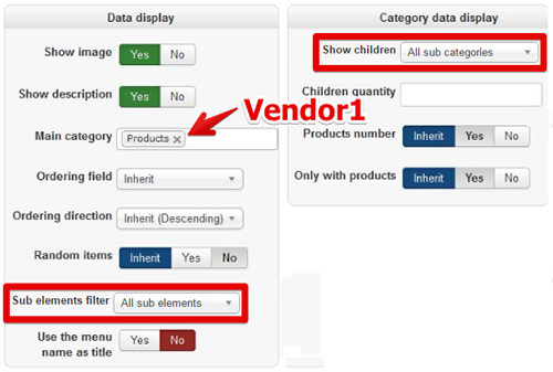

Data display have to display Vendor 1 parent category, right ?
Sub elements filter & show children have to show ALL sub elements, direct element display can't work.
Hope this will help you.
