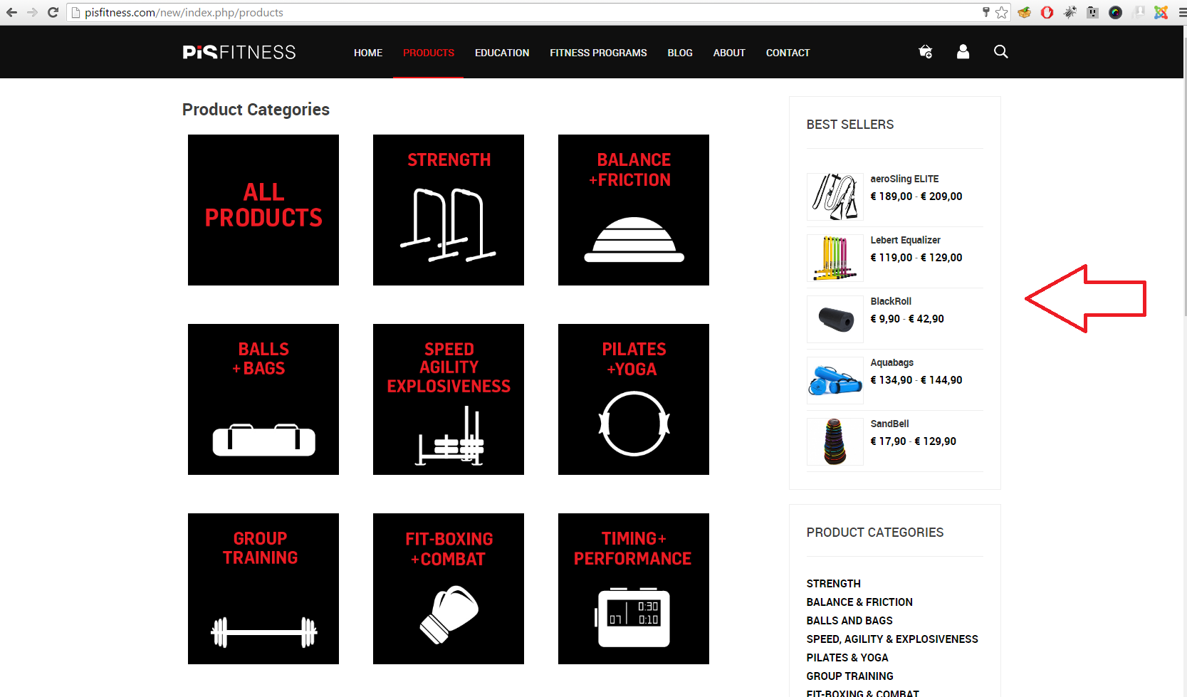

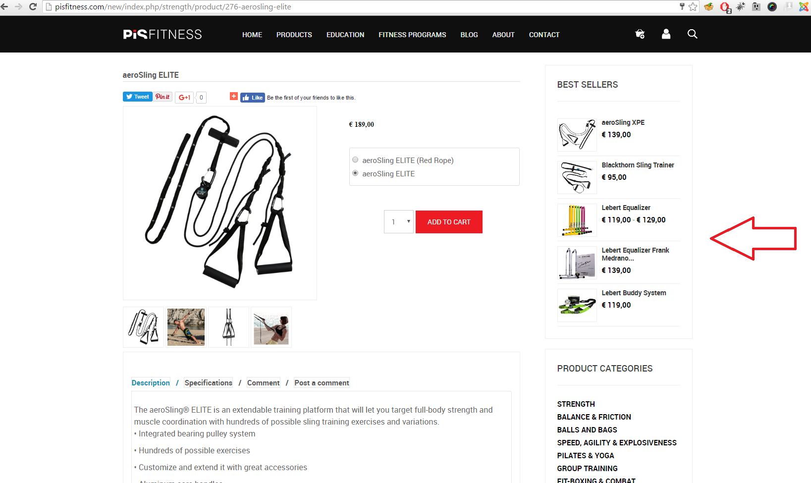

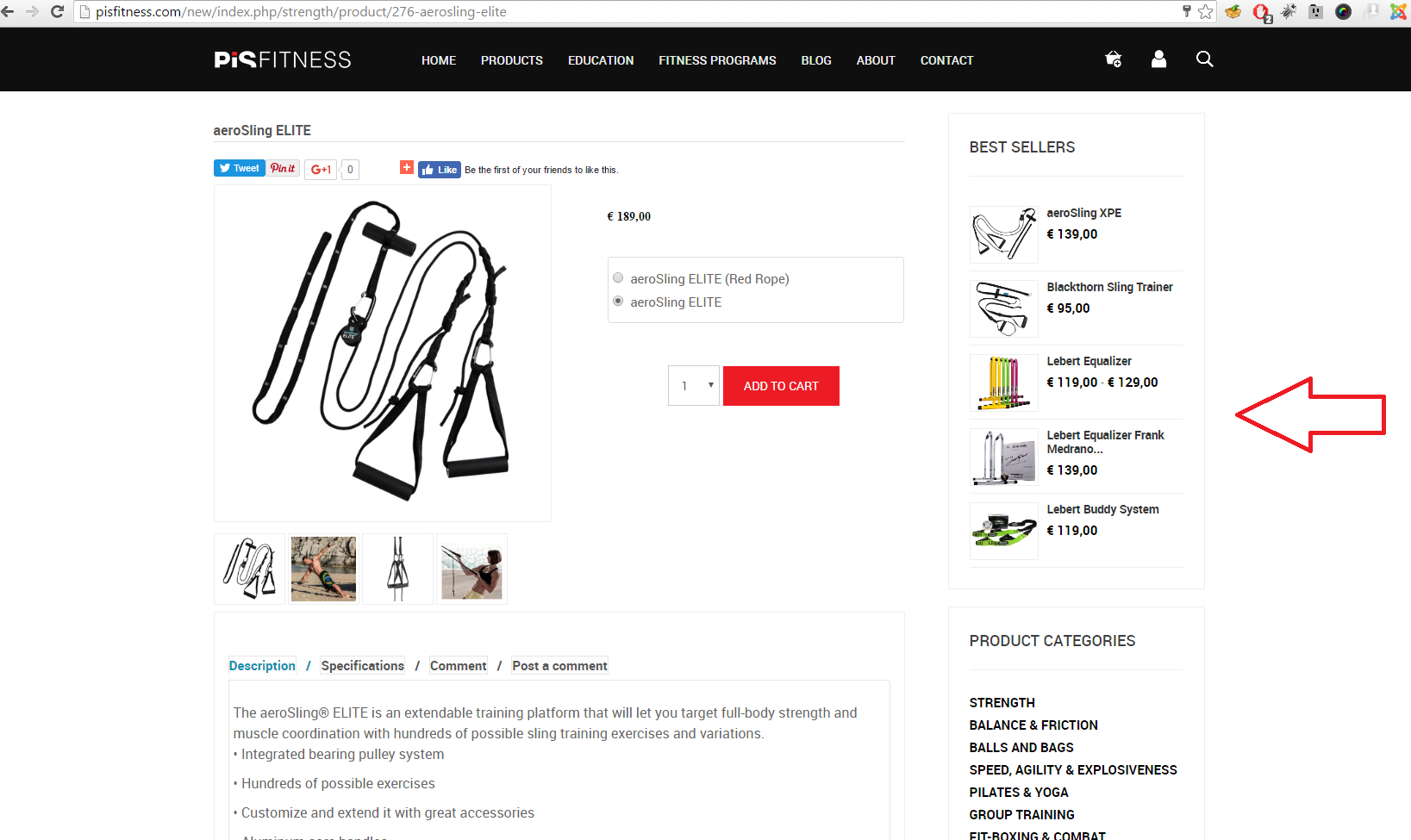

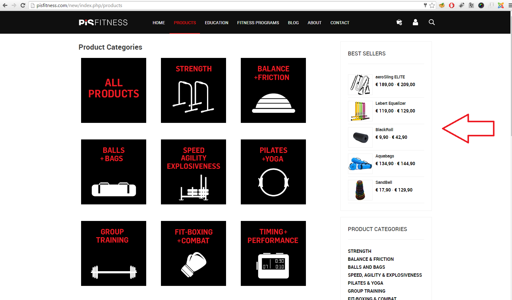

I have the ''best sellers'' category but I want to choose which ones are the best sellers.

I want to choose which ''best sellers'' products to be shown and not show random products..
See attachments

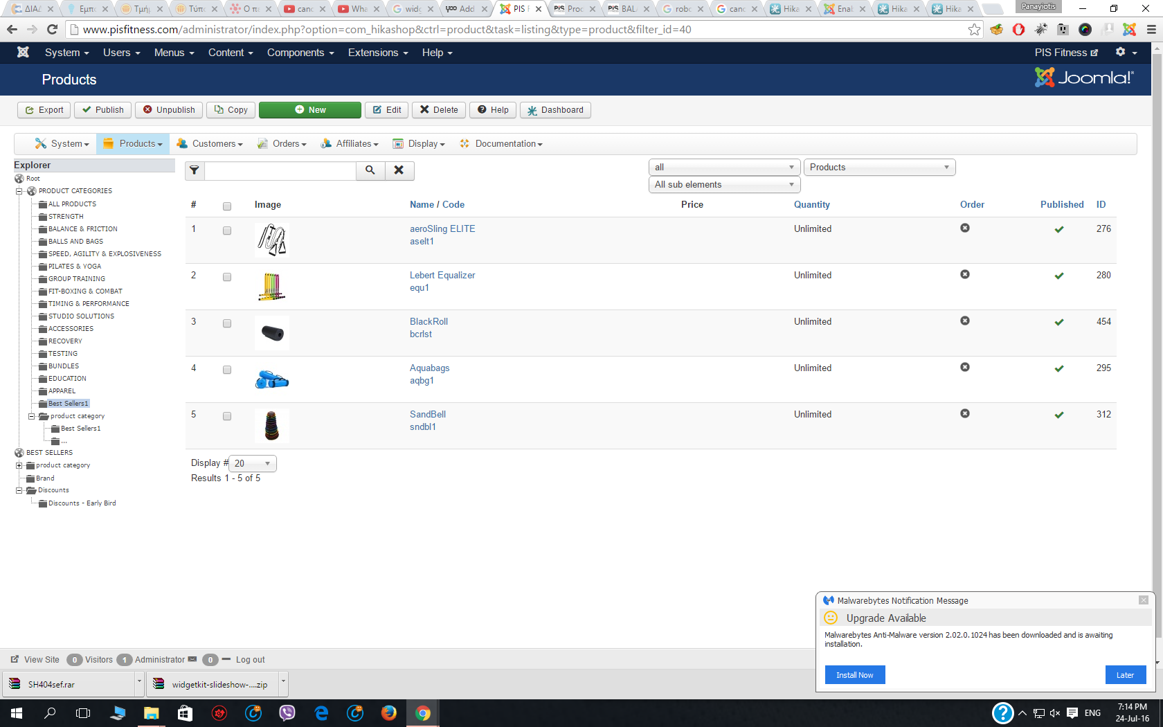

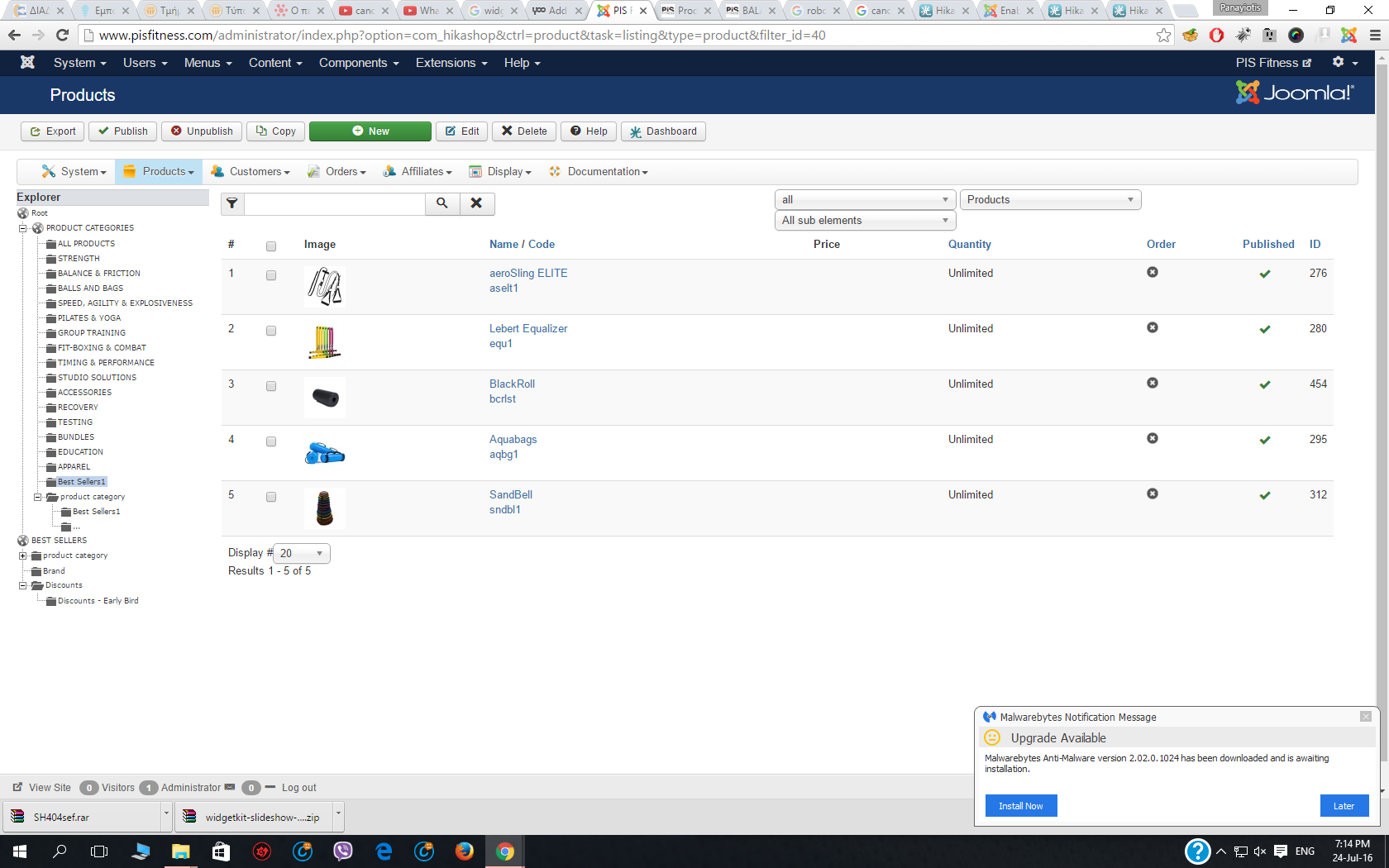

Then the solution will be to directly :
- Create an unpublished "Best seller" category
- Add your products on that category
- Add that category on "Associated category" option of your product listing content module configuration page.
Last edit: 9 years 11 months ago by Mohamed Thelji.
  • Posts: 20
9 years 11 months ago #246241
Done that but still the same..

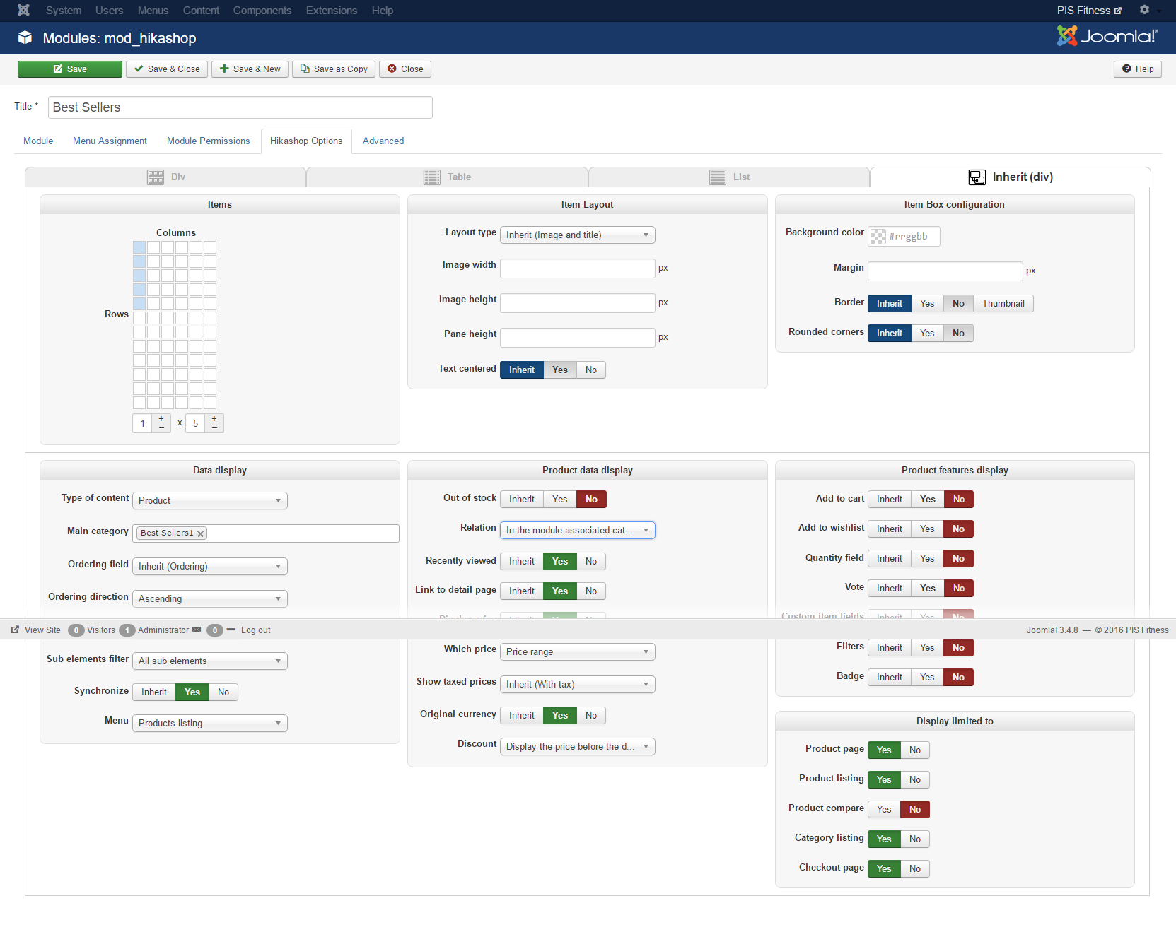

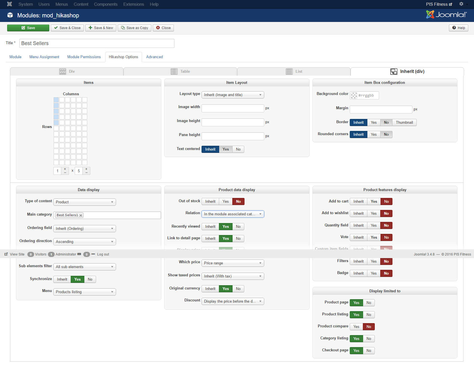

You have activated the "synchronize" setting of your module. Which means that the module will use the current category on the page instead of the category configured in the module.
You also have activated the "recently viewed" setting of your module. Which means that the module will only display the products of the category that you already looked at recently.
You want to turn off both of these options and it should work better.
