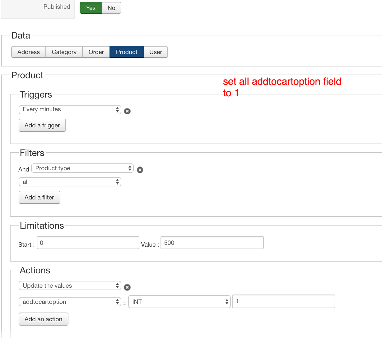

  • Posts: 490
10 years 3 weeks ago #246446
the code removes both add to cart button and the add to wishlist.
how can we retain add to wish list.
i just want to remove add to cart.

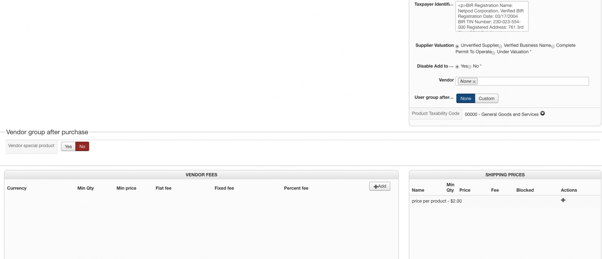

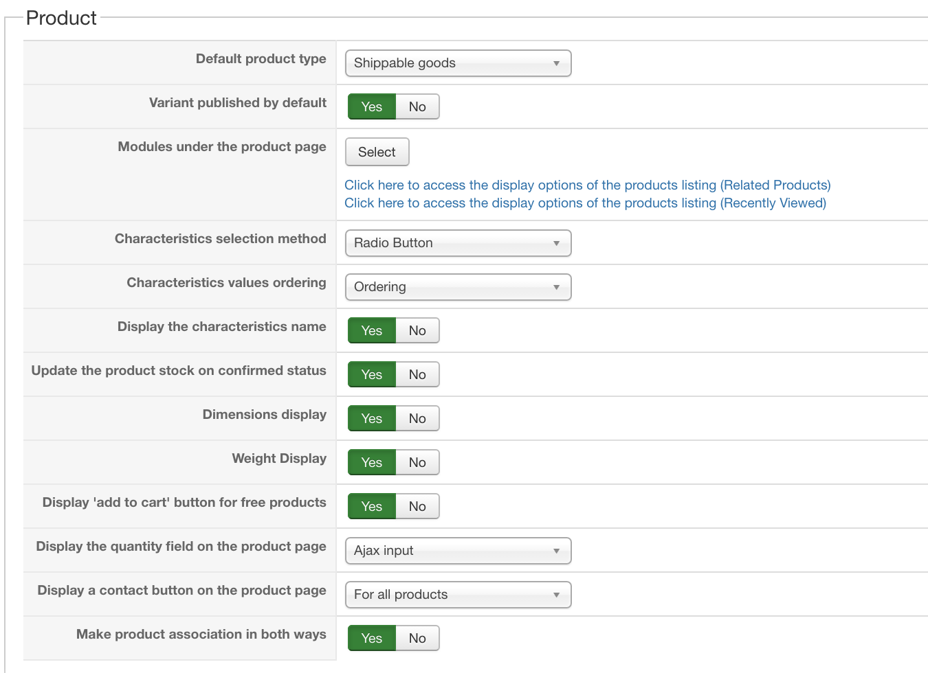

Also how do i update all the values of the other products that has been created before. can i use mass action?
this is my settings. I got it to work but not all products are affected. Do i need to increase the limatations field?
thanks
Last edit: 10 years 3 weeks ago by ronron.
  • Posts: 86058
  • Thank you received: 14184
10 years 3 weeks ago #246460
1. Then, instead of :
$this->params->set('catalogue', 1);
you can use :
$this->row->quantity = 0;
Actually, you could remove the customization and the custom field and just set the stock to 0 for the products for which you don't want the add to cart button but still want the wishlist.
2. You don't want a trigger or a filter in your mass action. Just have the action, and click on the "proceed" button. Also, note that it will only process the first 500 products you have. So you'll have to change the limitations area to process the other products after that.
The following user(s) said Thank You: ronron

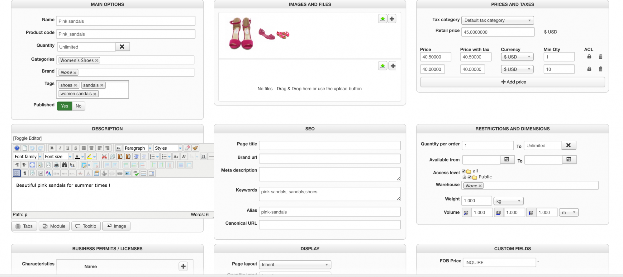

  • Posts: 490
10 years 2 weeks ago #246837
hi
1. it doesn't work if i try to replace this code
with this one
i cant set the stock to 0 because my site is a multivendor site. Vendors have control over the stock of their products.
thanks

  • Posts: 490
10 years 2 weeks ago #246987
hi
1. sorry i dont understand the last post.
i just want to display the add to wishlist button even do im using the custom code.
with this one
2. i tried to set the quantity in the back end to 0 and what you are saying worked. the add to cart is gone and the wishlist remained. unfortunately if the vendor changes the quantity the add to cart button appears again. I cant let the vendor control the add to cart button
thank you very much
Last edit: 10 years 2 weeks ago by ronron.

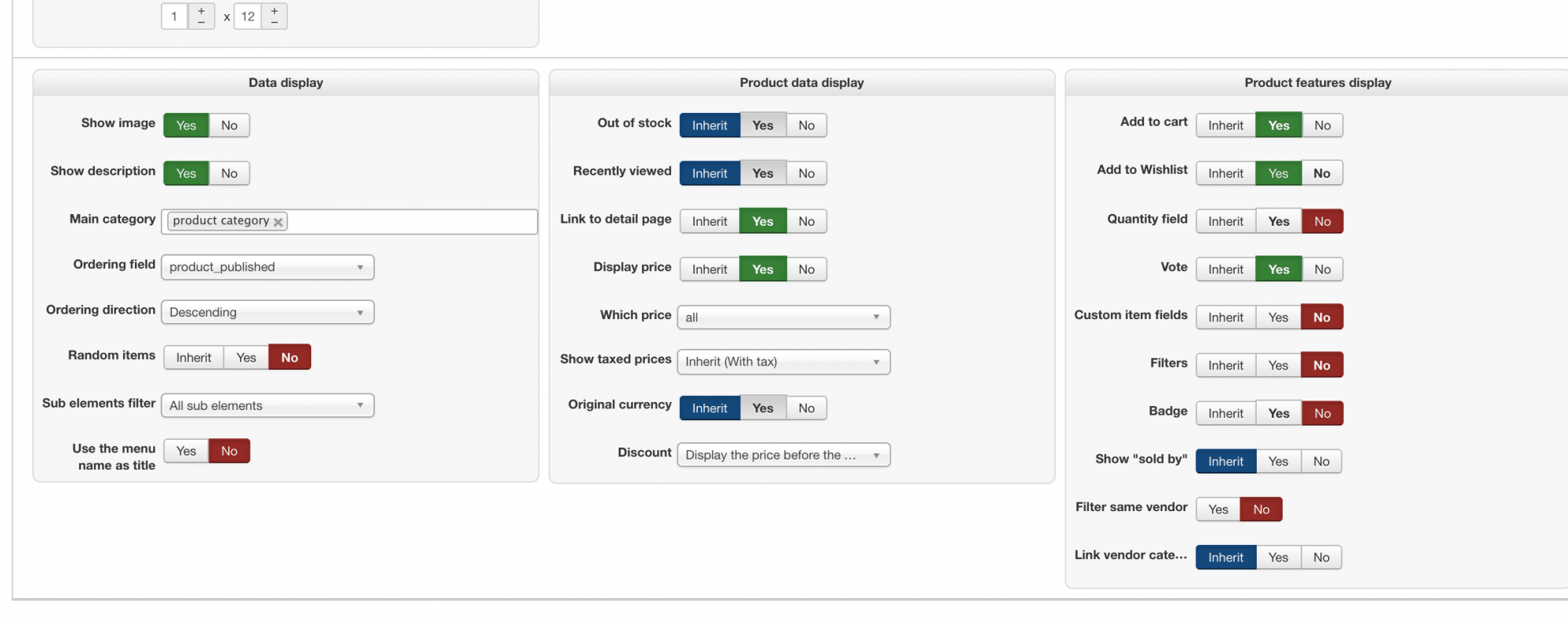

tried you suggestion but it doesnt work. i remove the changes and used the initial code
this is the link to the page
Part of the message is hidden for the guests. Please log in or register to see it.
this is the settings
thanks again
  • Posts: 26382
9 years 11 months ago #248305
and provide a link to the product page where that doesn't work with a screenshot of the settings of that product ?
You gave information about product listing ; not the product page.
  • Posts: 490
9 years 11 months ago #248401
thanks jerome
is this it?

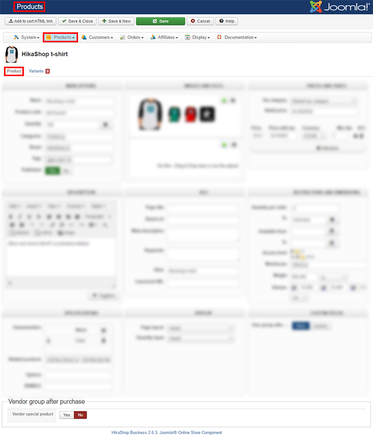

9 years 11 months ago #248433
I will guide you, first, Nicolas ask you the product page with the issue, and not the listing page (we understand that maybe the product is among the listing, but the complete product page url will able us to be sure of what we do)
Ex : YOURWEBSITE/store/product/product-name
And for the screenshot of that product, we need this :
Reach it, Components => HikaShop => Products, and click on the product name (with issue) to see his configuration screen.
Awaiting news from you

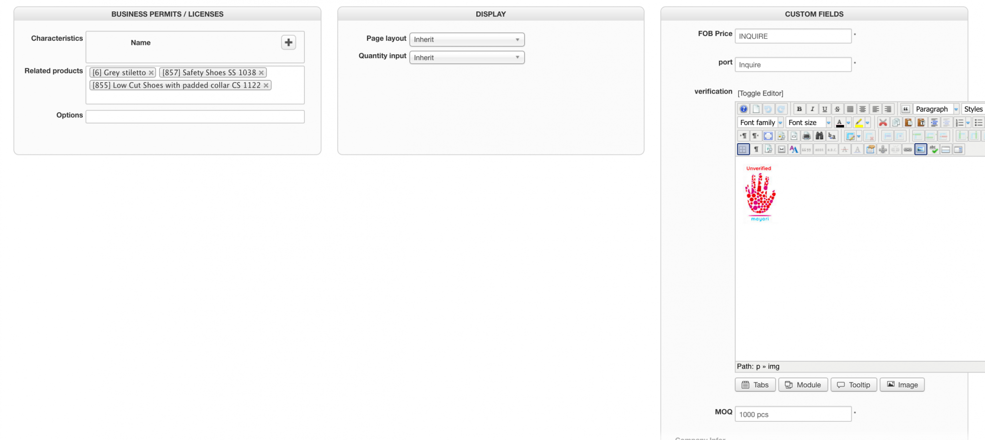

  • Posts: 490
9 years 11 months ago #248604
oh i see, here it is.
also all products are behaving the same. Both add to cart and wishlist does not appear. Not just one when i use this code
if($this->row->addtocartoption == 1)
else
$this->params->set('catalogue', 0);
sample product
thanks
  • Posts: 86058
9 years 11 months ago #248677
So I suppose that the problem is that you're not using 1 and 0 as the values of your custom field. Which explains why it never goes in the else of the condition.
Can you provide a screenshot of the settings of your custom field ?
