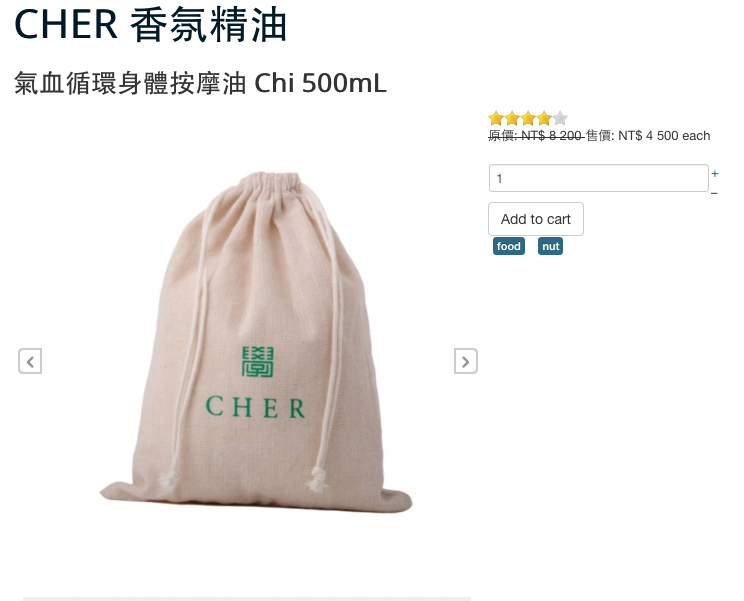

- Posts: 7
- Thank you received: 1
4 years 10 months ago #338543
by losheng2010
Replied by losheng2010 on topic How to go to "next" image
Hello, I found out my version of chrome is too old. but I have another question, is it possible to add next and prev buttons on the side of product image, or show me how to do? Many thanks

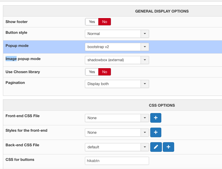

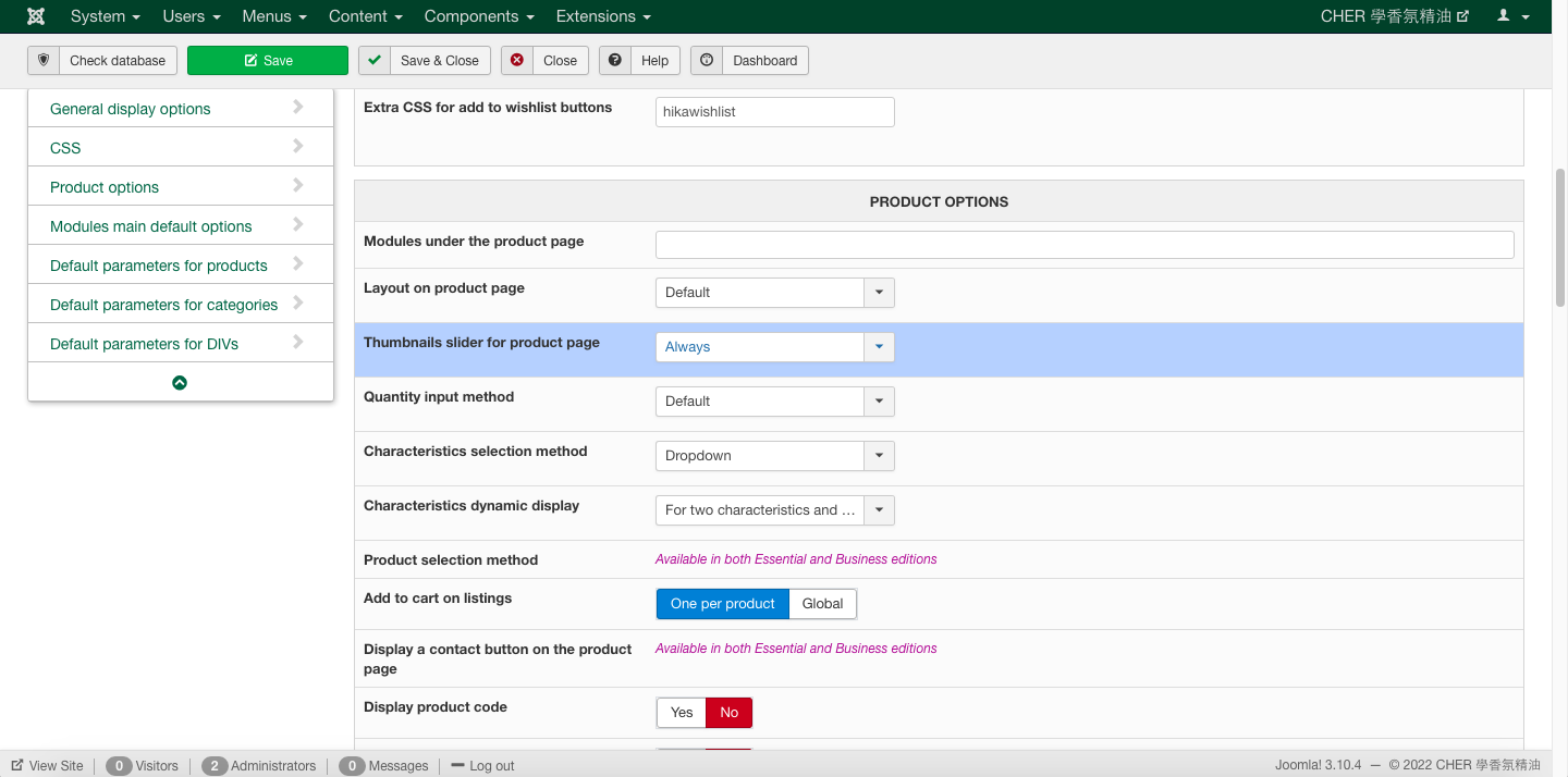

4 years 10 months ago #338547
by nicolas
Replied by nicolas on topic How to go to "next" image
This option will add next / previous icons on the image popup, once you open it, as you can see on your page:
i.imgur.com/3Bg3VhG.png
We actually added an option "Thumbnails slider for product page" with HikaShop 4.4.2 which allows the display of next/previous buttons directly on the product page:
i.imgur.com/znIy4XA.png
However, I can see that you're using HikaShop 4.3.0 on your website so you won't have that option. You would have to update your HikaShop first.

- Posts: 7

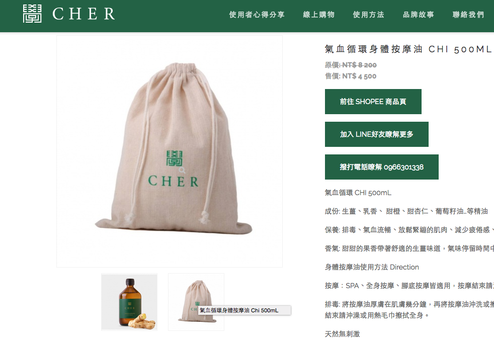

4 years 10 months ago #338613
by losheng2010
cherbeauty.tw/component/hikashop/product/7-chi-500ml.html
thanks for your reply, but thumbnails still do not show up, could you tell me how to fix it? thank you

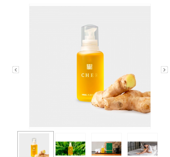

4 years 9 months ago #339070
by losheng2010
Hi I changed template protostar, the thumbnails show up, it is really override issue. thanks a lot,but after I changed to prostar or joomshaper template, the thumbnail's button "onmouseover", event, do not work, so the picture do not move to next/prev pictures. could you show me how to fix?
cherbeauty.tw/component/hikashop/product...rculation-100ml.html

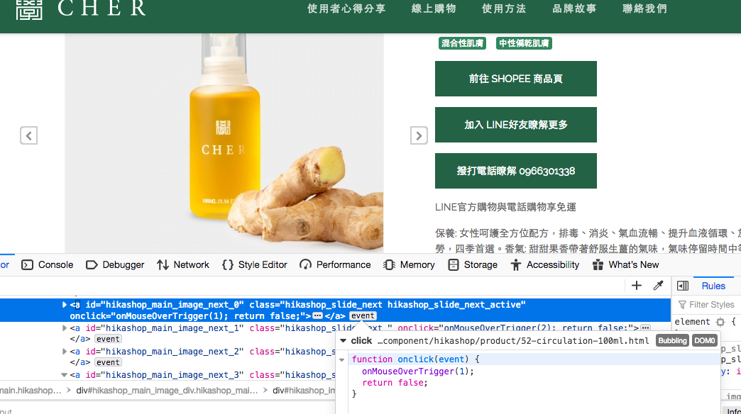

4 years 9 months ago - 4 years 9 months ago #339108
by Philip
Replied by Philip on topic How to go to "next" image
It looks like you are still using an override view, basically "onmouseover" is an event triggered by the HikaShop Js function "onMouseOverTrigger".
In your case, it seems that you have modified the call.
You must have this :
element.onmouseover();
It seems that you have this :
element.onMouseOver();
Basically, if you don't know how to proceed, we can just invite you to use default view instead of override view.
Hope this will help you to solve your issue.
