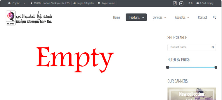

Hello

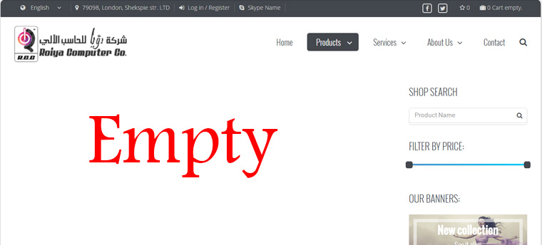

i'm trying to display the product but it will not showing, my question which responsible about show product.
please can you check the attachment file

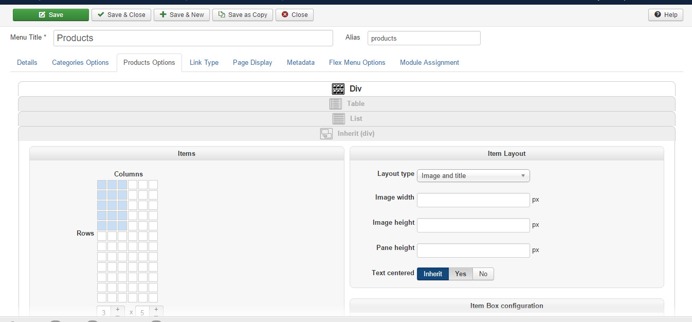

The problem either comes from your menu item settings under the "products options" tab when you edit the menu item via the Joomla menu manager, or from a view override of your template.
Switch to the default template of Joomla to verify that. If it works, then it comes from the file templates/YOUR_TEMPLATE/html/com_hikashop/category/view.html.php Rename it via FTP and it will work for your template too.
Otherwise, please provide a screenshot of the products options tab of your menu item.

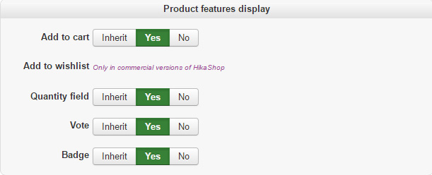

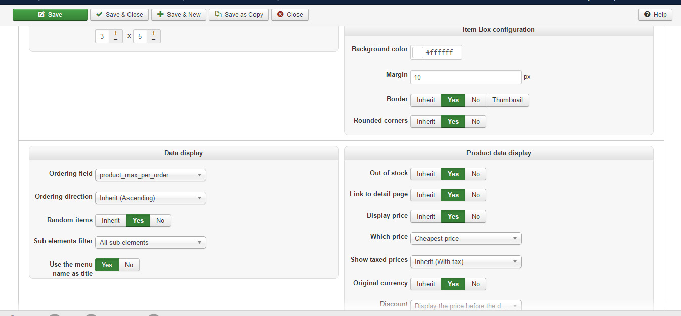

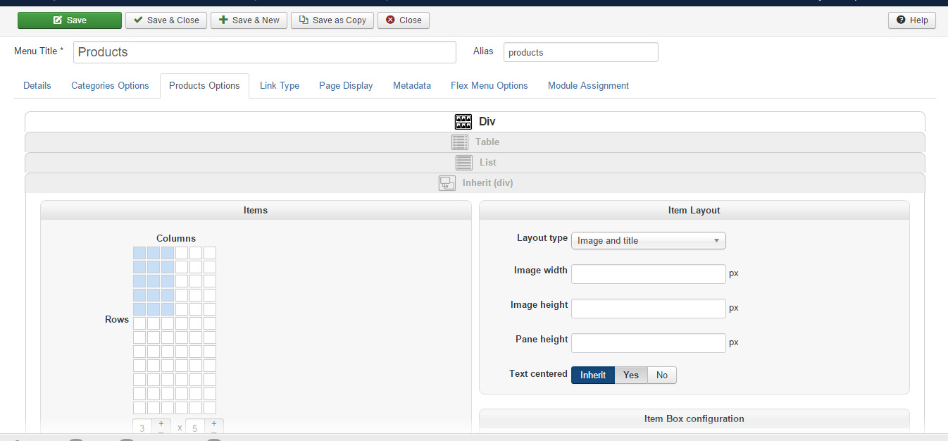

  • Posts: 3
9 years 10 months ago #246904
Thank you for your help. Mr.nicolas
when i switch to the default template of Joomla it will works good ,

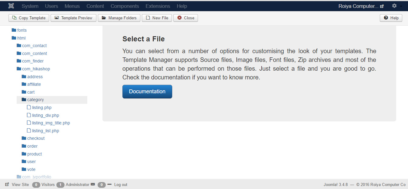

1- what i can do because i can not find the file html/com_hikashop/category/view.html.php and what is the function for this file

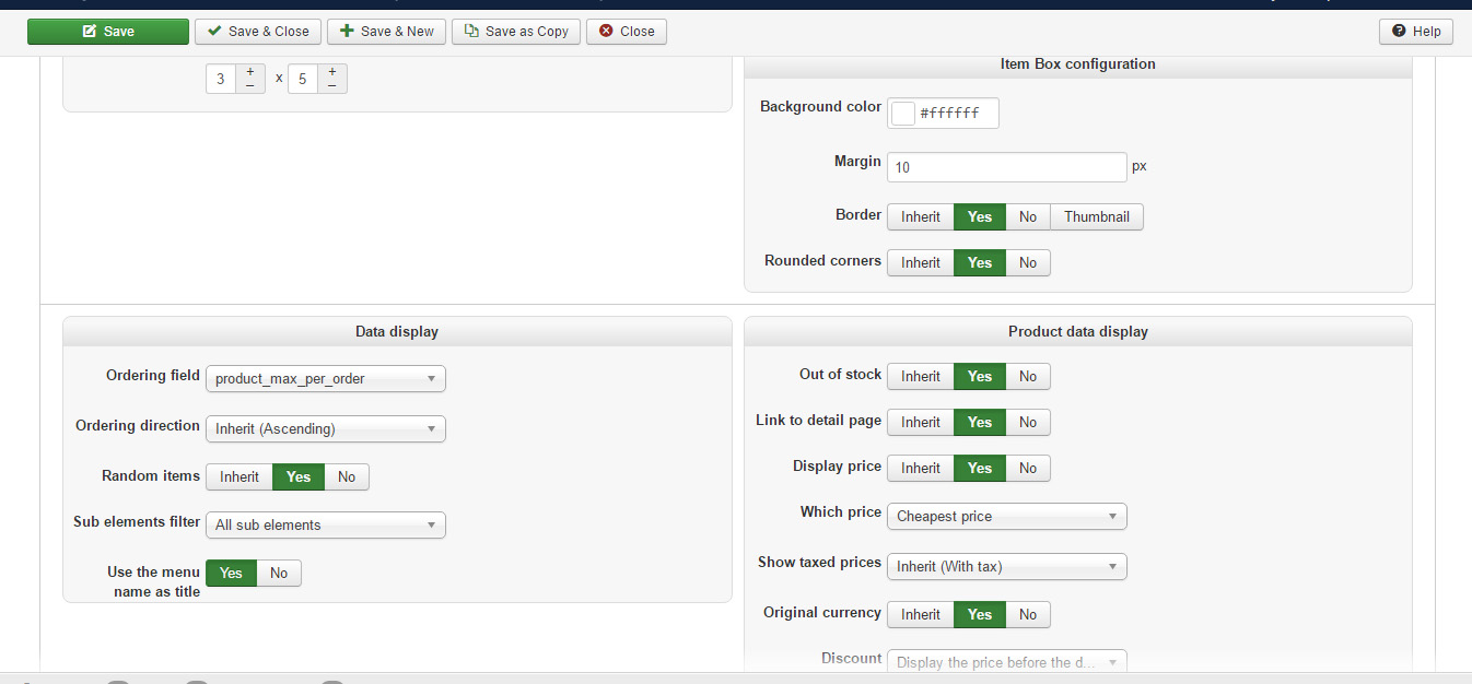

2- i shear withe you picture products options tab of menu item
Best Regards

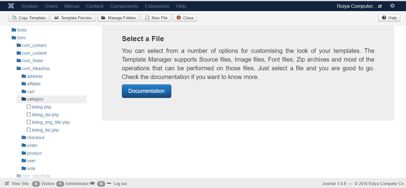

  • Posts: 85786
  • Thank you received: 14078
9 years 10 months ago #246906
Sorry, I made a mistake. It's the file templates/YOUR_TEMPLATE/html/com_hikashop/category/listing.php
  • Posts: 3
9 years 10 months ago #246940
sorry i'm confused Rename it via FTP and it will work for your template too.
Why should I do here templates/YOUR_TEMPLATE/html/com_hikashop/category/listing.php
Thank you
9 years 10 months ago #246944
You'll have to do it here so that all the customization that you've made on the Hikashop files of that template won't be applied.
