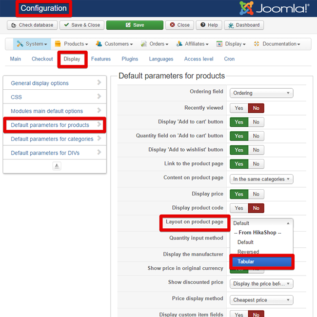

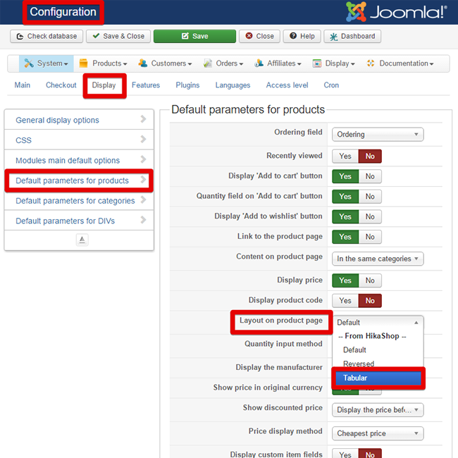

how to add Tabs in Hikashop Default Product Display options ?
i want to add tabs in default view. same like tabular view
9 years 10 months ago #247411
You have already an option in HikaShop to do this easily, for reach it :
- Go in Main HikaShop Configuration.
- Click on Display tab and go to Default parameters for products
- Find Layout on product page option and select Tabular
Hope this will fit your needs !
