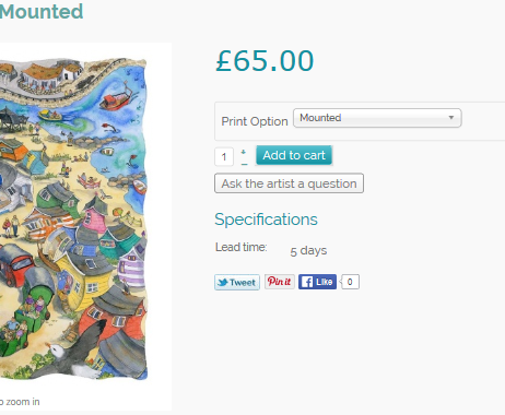

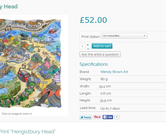

Could you help me with a modification please?
I have rearranged the product display to look like this:
But when a variant is selected none of the specifications are displayed:
If I switch to the Protostar template the specifications are displayed for the variant so obviously it is something I have done incorrectly :oops:
I have moved a block of code out of the product show_default and inserted it into the end of show_block_custom_main:
$specifFields = ob_get_clean();
if(true){     //MODIFIED
<div id="hikashop_product_custom_info_main" class="hikashop_product_custom_info_main">
	<h4><?php echo JText::_('SPECIFICATIONS');?></h4>
	<table width="100%">
      <?php     //MODIFIED
        //LAYOUT show_block_dimensions     //MODIFIED
        $this->setLayout('show_block_dimensions');     //MODIFIED
        echo $this->loadTemplate();     // MODIFIED
		<?php echo $specifFields; ?>
	</table>
</div>
<?php }
echo '<p>{hikashop_social}</p>';     //MODIFIED
What do I need to do to get it to display the dimensions and weight for the variants?

The custom fields are showing correctly (Lead time is a custom field). The fields that are not showing are: weight, width, length and height. These fields are displayed correctly on the main product but disappear when a variant is selected.

You need to understand how the swapping mechanism work when you select a variant.
The system takes all the _main divs, and replace their content by the content of the same div for the corresponding selected variant.
So your problem is that you now have the hikashop_product_width_main, hikashop_product_length_main, etc divs inside the hikashop_product_custom_info_main div.
But in the variants hidden data divs, that's not the case because you didn't do the same modification in the "show" file of the "product" view.
So there are several solutions here:
- you can do a similar change in the product/show view file
- you can remove the hikashop_product_custom_info div from the product/show view file. That way the swapping system won't find the variant hidden div and thus won't do the replacing
- you can modify your show_block_custom_main to have the hikashop_product_width_main, hikashop_product_length_main, etc divs outside of the hikashop_product_custom_info_main div.
