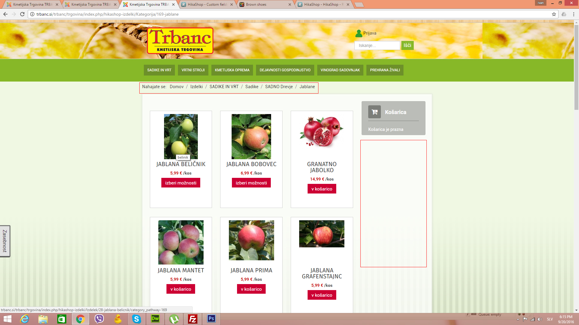

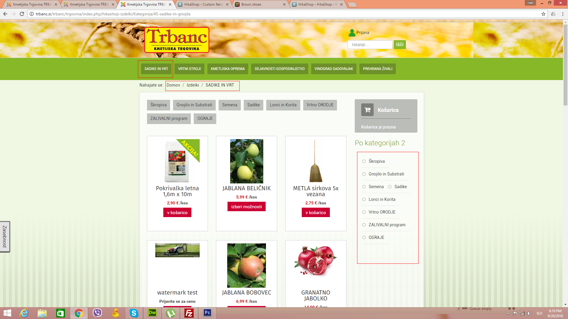

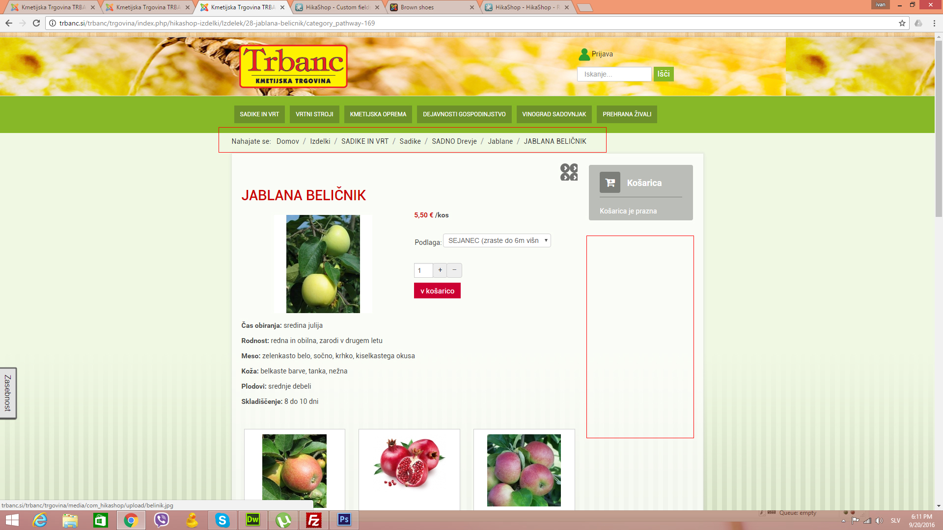

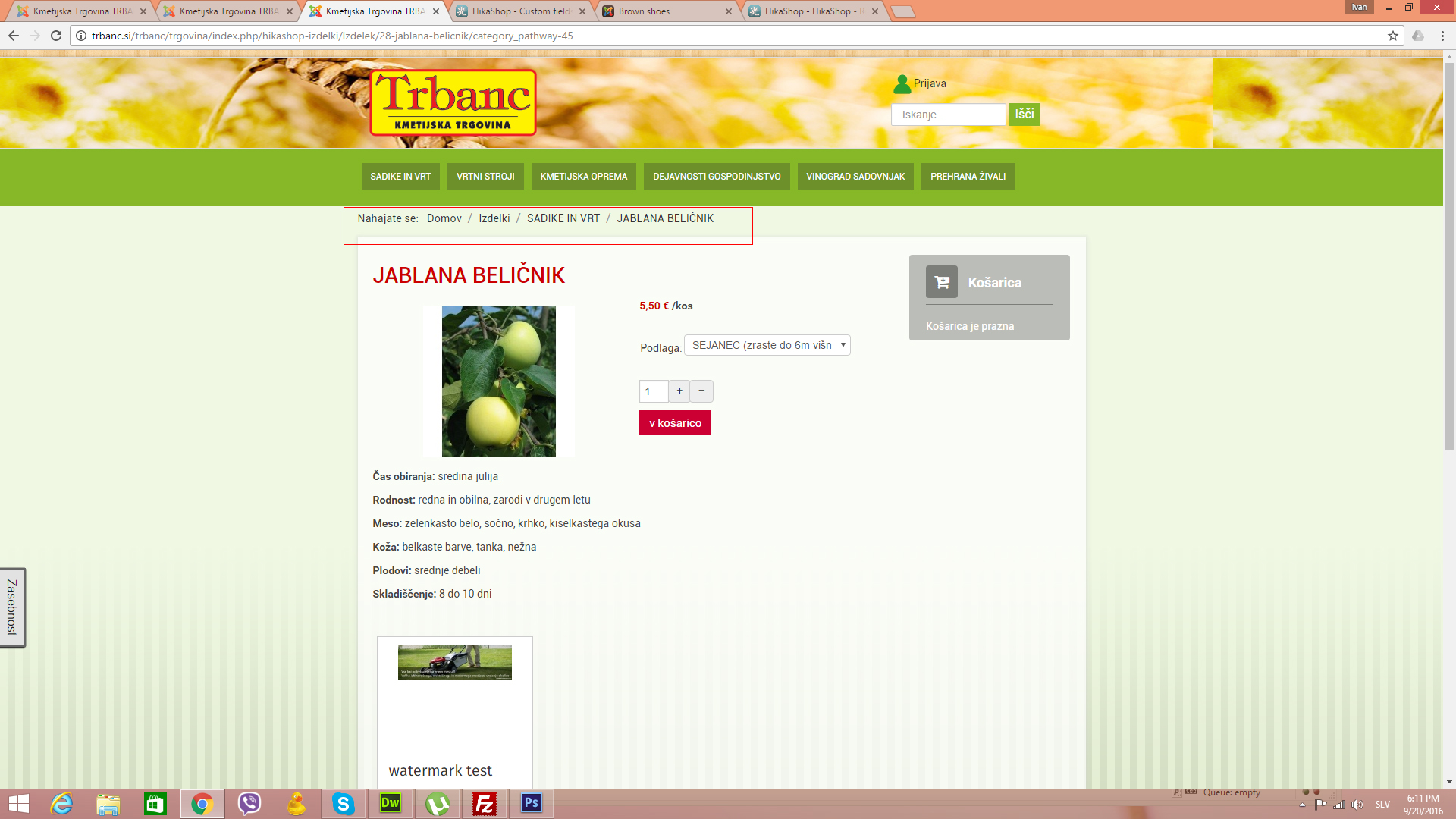

But, when user gets to the last level subcategory or to the product page - module dissapears and also the category listing on top of the page. I need this to be displayed even on last level subcategory listing, even though it does not have any subcategories. In that case it should display listing for parent category of the curently displayed. It has to stay that way also when you get to the product page. Is there any way to achieve this.
P.S. I use generated URLs for breadcrumbs, so it is not an option for navigation through all subcategories on the store. For example, when user clicks on a product (that is placed in a 6th level subcategory) from category listing displaying the third level subcategory, breadcrumbs skips all steps between third and 6th level. I attached some images for clarity.

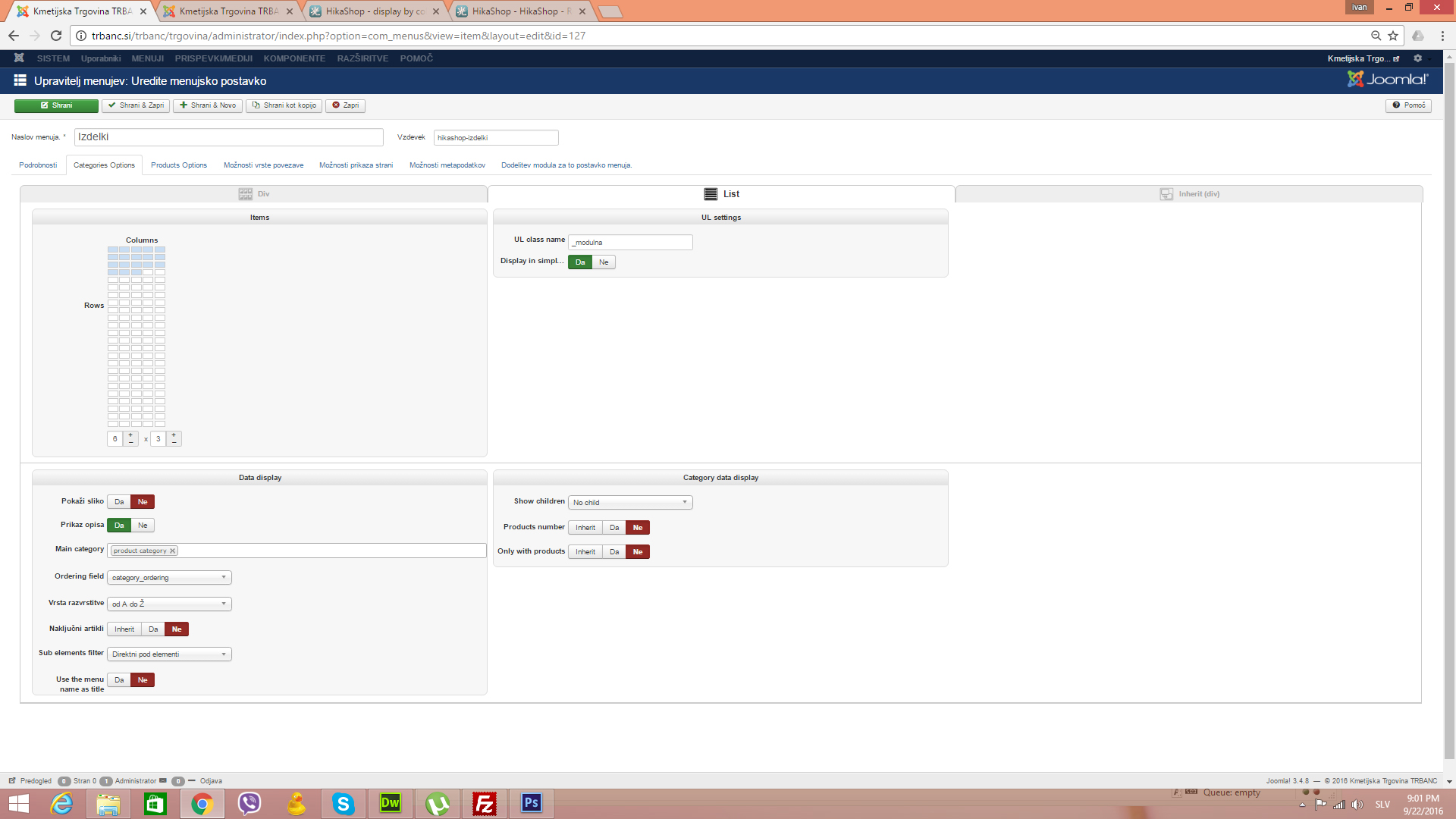

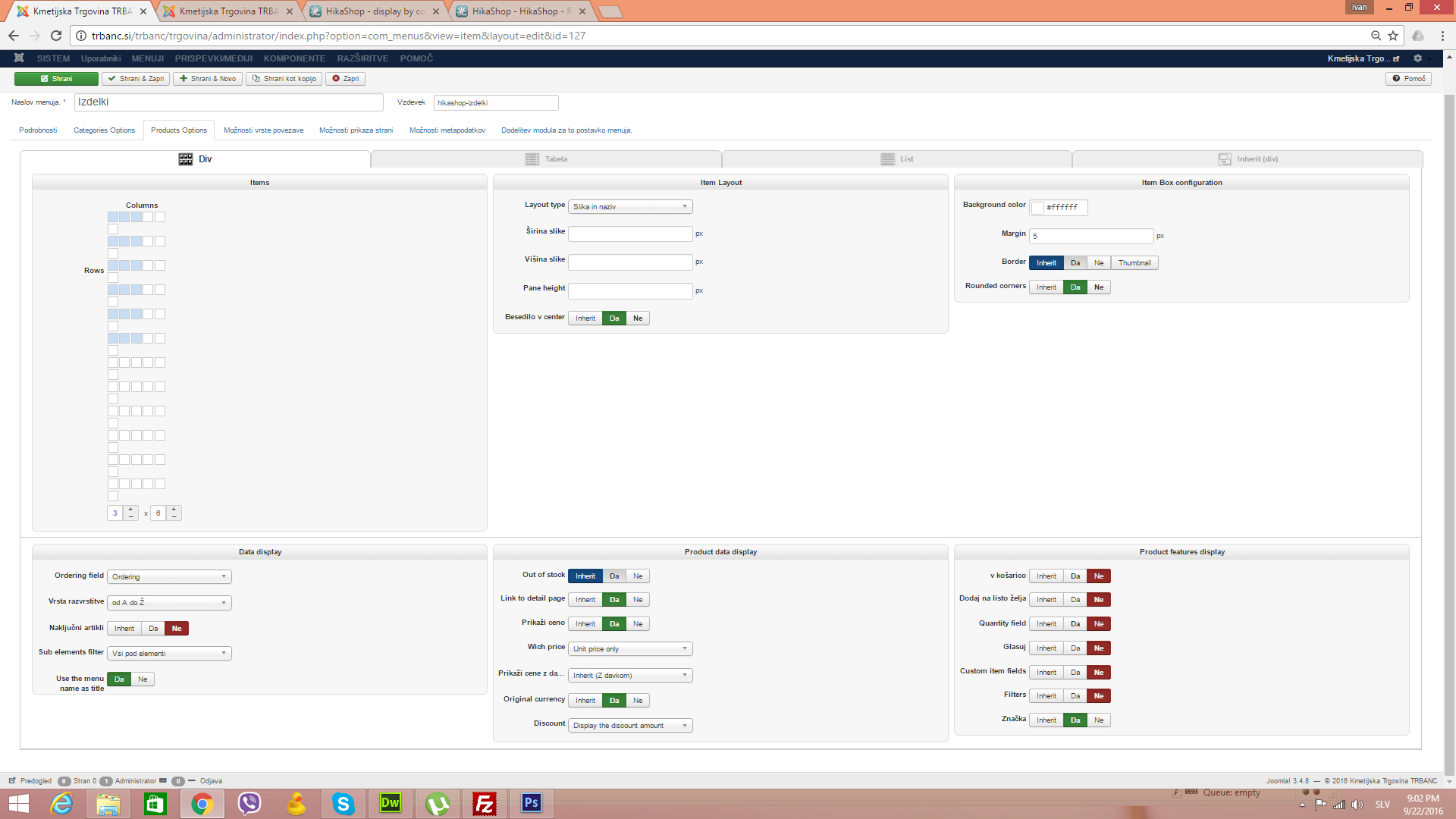

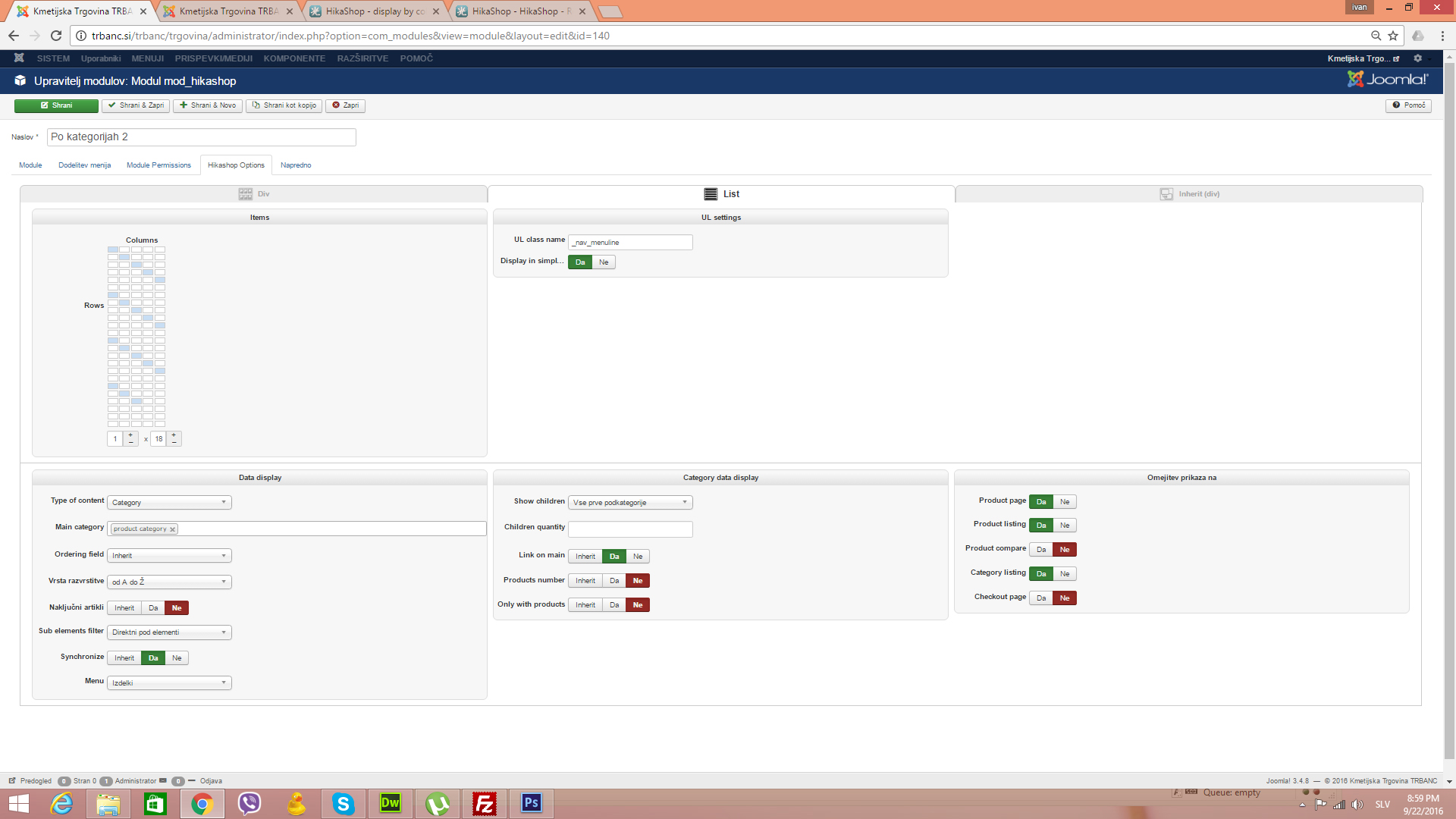

  • Posts: 20
9 years 6 days ago #250590
I tried with protostar template, same thing happens.
here are screenshots of settings for menu listing I use as main view and for module listing (sidebar).

9 years 5 days ago #250660
Unfortunately, there is no "synchronize with current element and display the child categories of its grand father category" setting to do what you want.
So you won't be able to achieve what you want easily.
You have two options:
- you create one categories listing module, which is not synchronized, and which is set to display all the child categories of a grand father category, and you use the extension "Advanced modules manager" to configure that module to display for all the grand children categories of that grand father category and all of their products.
- you have one not synchronized module which is configured to display all the categories and you develop a custom plugin implementing the onBeforeCategoryListingLoad trigger to add conditions to the MySQL query loading the categories of that module to only display the categories you want on the pages you want for your needs:
www.hikashop.com/support/documentation/6...eCategoryListingLoad
The first option will take quite some time to manage it but doesn't require any coding skills, the second won't take time to manage, but requires coding skills to implement it.
