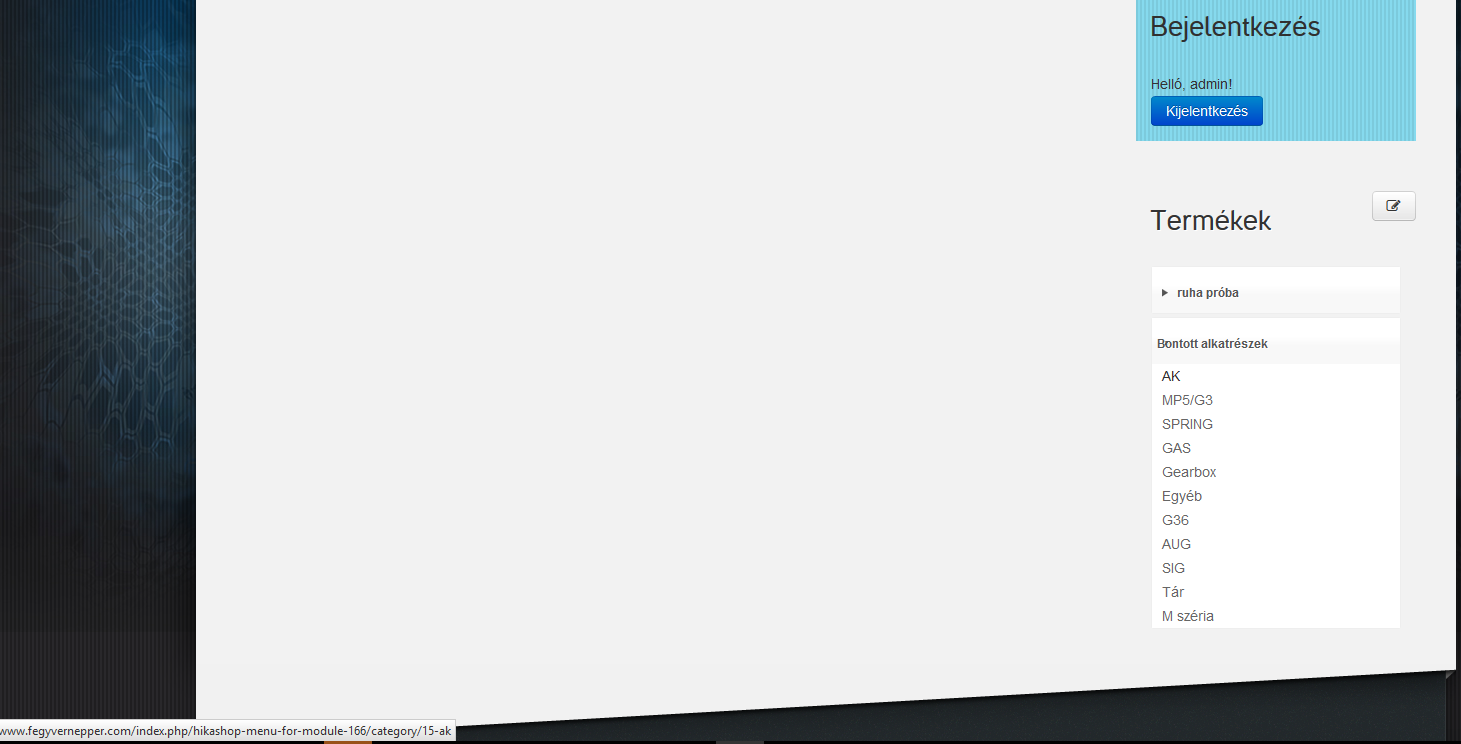

In the Joomla Modules I use one of the HikaShop Content Module to display categories on the right side with childrens.
The dropdown menu works well, but if I click on a children category do not display the products of the children category.
Example. If I click on the AK, seems the link is right, any content not appear. But from the main menu everything works well.
What I set wrong?

Hard to say as you didn't give a link to the page, nor some examples of the links, nor screenshots of all the settings of the module and associated menu item.
First, you should select a products listing menu item in the "menu" setting of your module. If that doesn't help, then it's probably linked to the settings of that menu item. We would need a screenshot to say more.

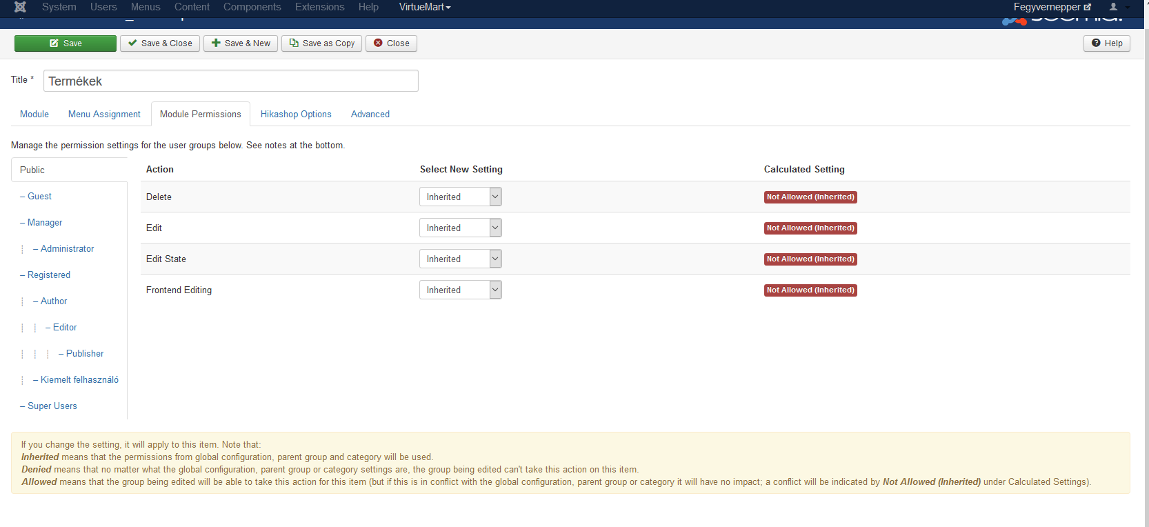

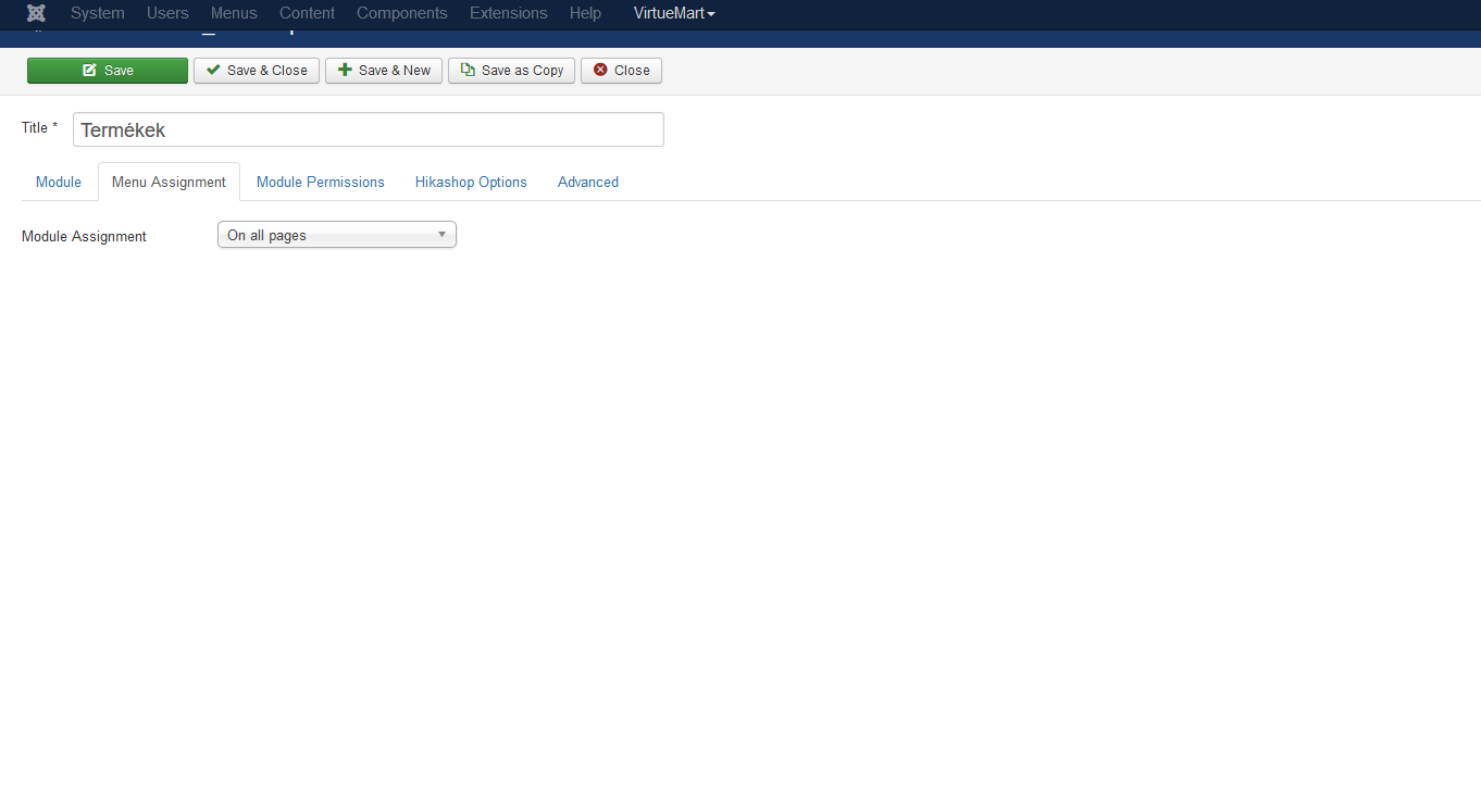

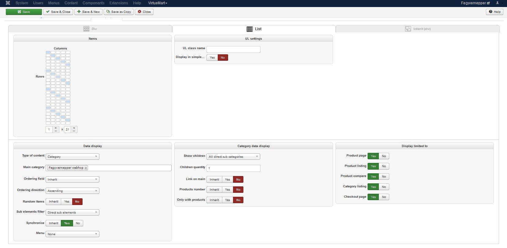

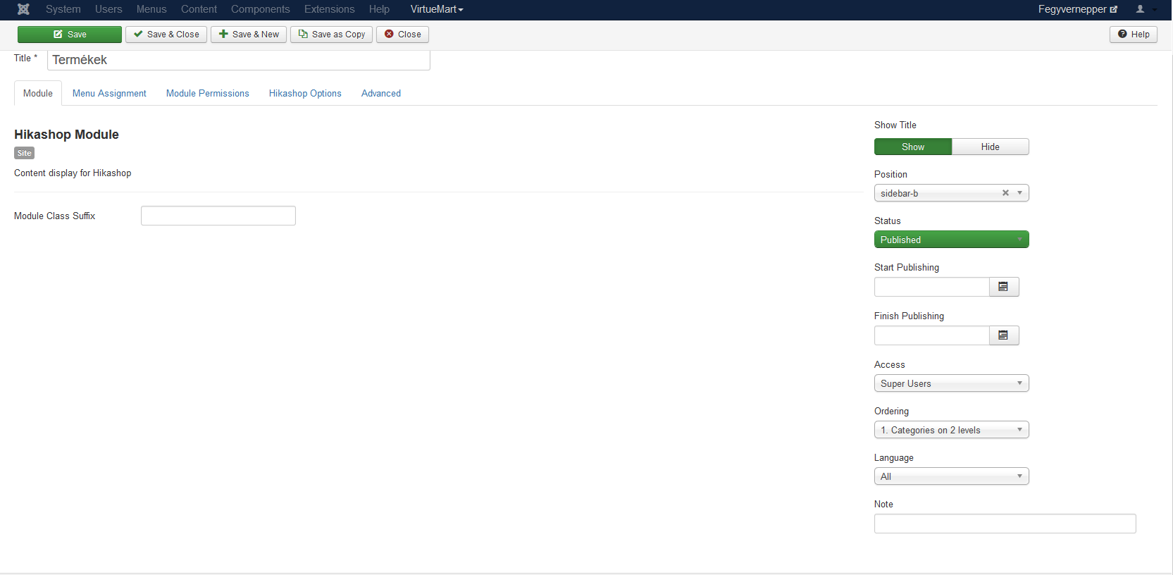

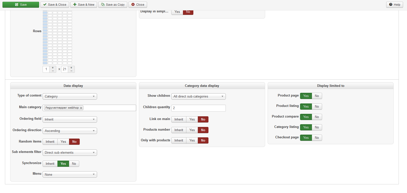

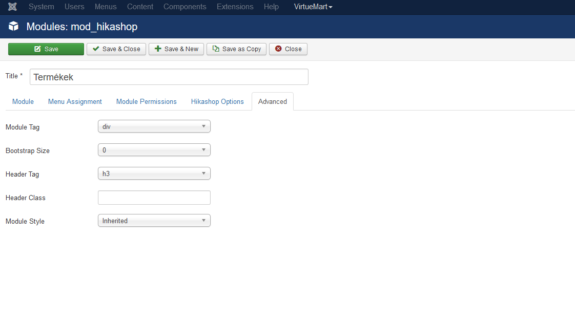

I gladly give a link to the webpage, but at the moment HikaShop is restricted to SuperUsers. I made a screenshots about the module settings.
If I click on the menubar (top of the webpage) everything is works and the link is:
www.fegyvernepper.com/index.php/hikashop...sting/category/15-ak
If I click on the sidebar what is use the content module the link is:
www.fegyvernepper.com/index.php/hikashop...e-166/category/15-ak

So as I said, in the "menu" setting of your module, select a category listing menu item.
In your case, you should select the menu item with the alias "hikashop-menu-for-categories-listing"
You'll then get the same link as through your menubar.

Cool, works. Thank you.
