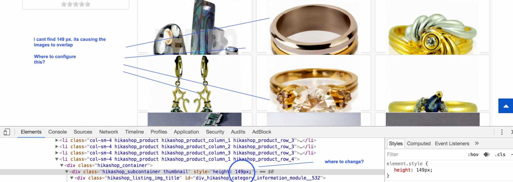

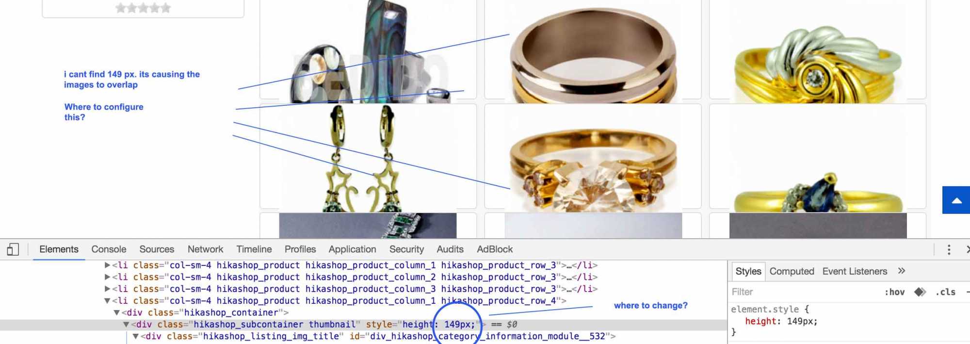

can you please tell me where div calss=" hikashop_subcontainer thumbnail " style = "152px" is getting is style configuration. Its causing my product images to overlap. i checked my menu configuration and it is set to width:300px height is 300px. panel is blank.

Remove the code:
data-consistencyheight=".hikashop_subcontainer"
in the file listing_div of the view product via the menu Display>Views and that should remove the problem.

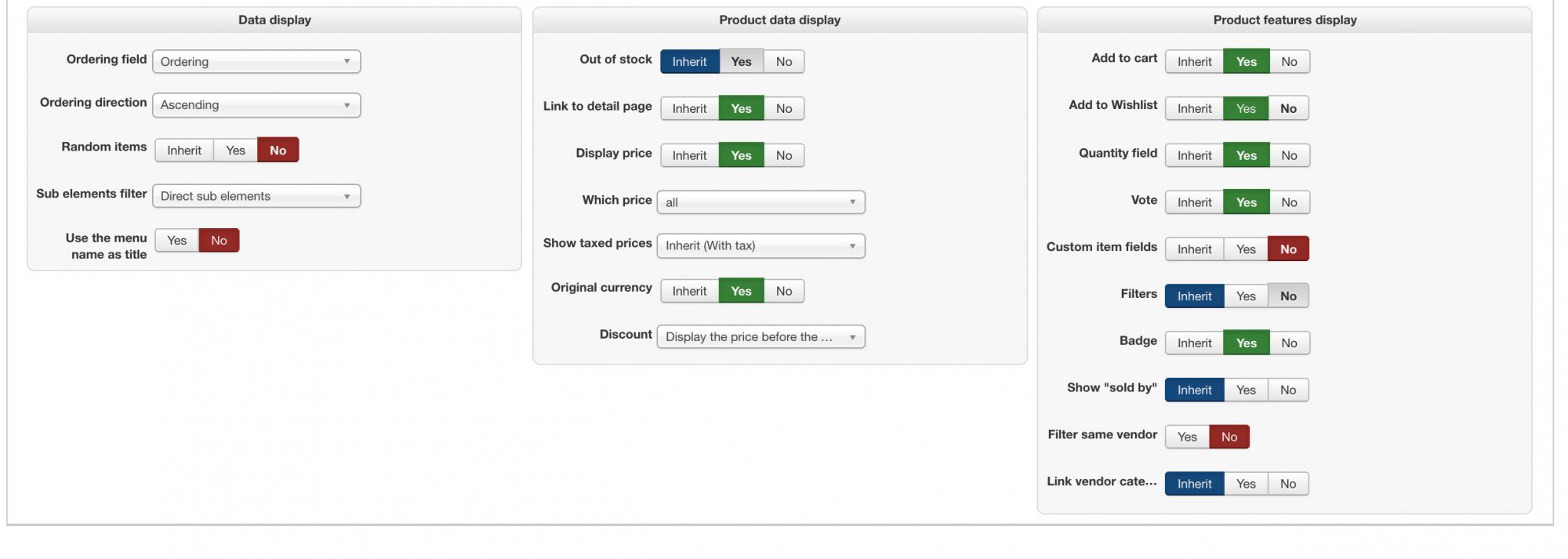

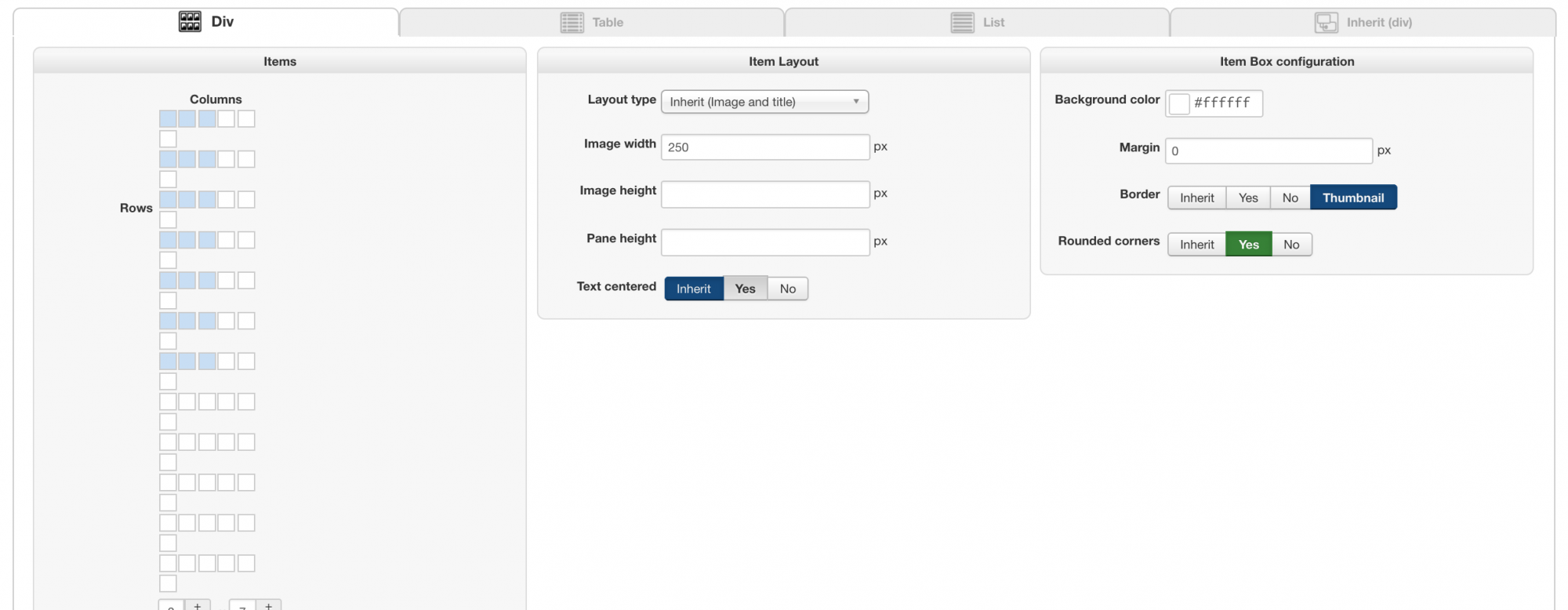

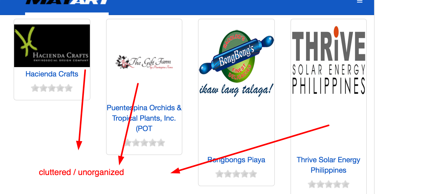

how about the vendors module. Particularly
HikaMarket Module
Content display for HikaMarket
type of layout of div
the size is set to force size 250px X 250px.

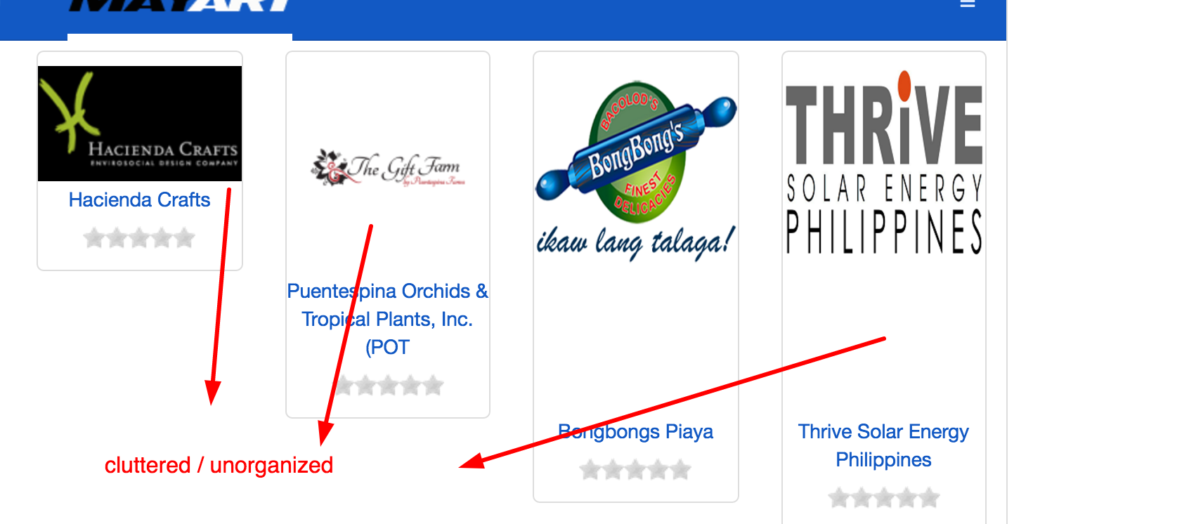

the photos look stretched trying to maintain the height 250px
when i remove the force size it looks cluttered.
please help.

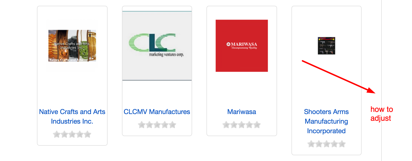

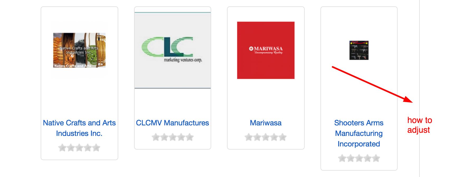

The issue is that you configured the module with thumbnails of 250*250 but that most of the images uploaded for the vendors are smaller than that. so they display either with blank on top/bottom with the "force size" activated, or they look "unorganized".
I would recommend to set smaller thumbnails, like 100*100 for that module. It should already help a lot.
Otherwise, set bigger images in your vendors.
Or, you can also use custom CSS to adapt the images and divs on the display...
